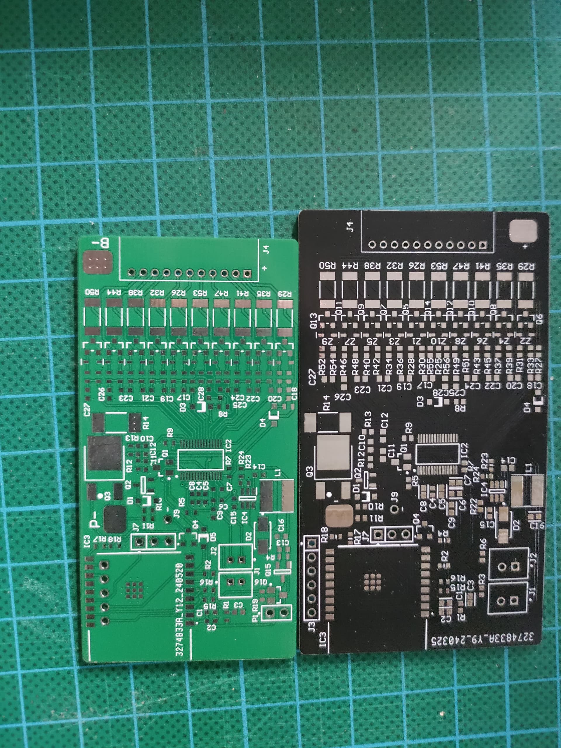

some mighty big smd resistors you got there. :slight_smile: :heart:
cool project!. what are the dimensions? how small can it get?
did you look into vesc bms protocols at all so that vesc can get warned by the bms of issues?
also i’m not sure if they are different but metr/minnie voyage systems had integrations with bms as well.
It’s 8x4.5cm but i could definitely make it way smaller with better routing and placing components on both sides. I didn’t plan on doing any communication with my vesc but UART pins are broken out so i could experiment with that later. I’m mainly just interested in reading cell voltages, charge current. and customizing the protection settings.

V2 has arrived. 20% reduction in size. Added a power latch circuit so the bms can turn itself off in software. Everything is open source: github

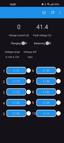

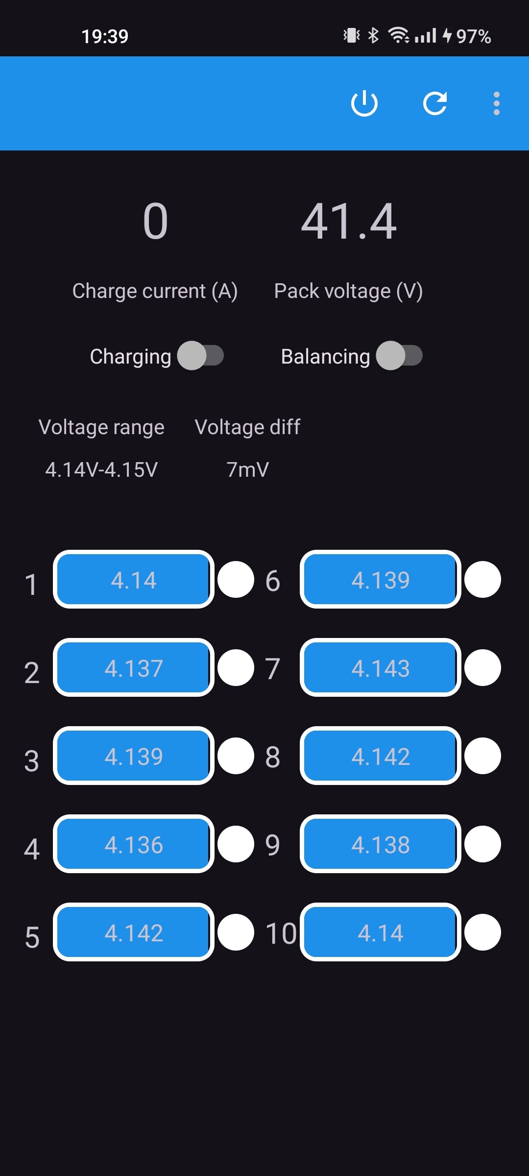

App is also coming together nicely. Voltage and current reading works.

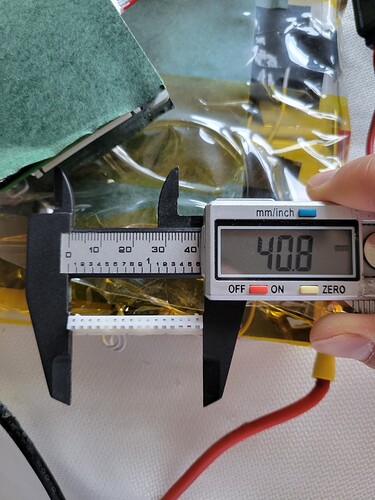

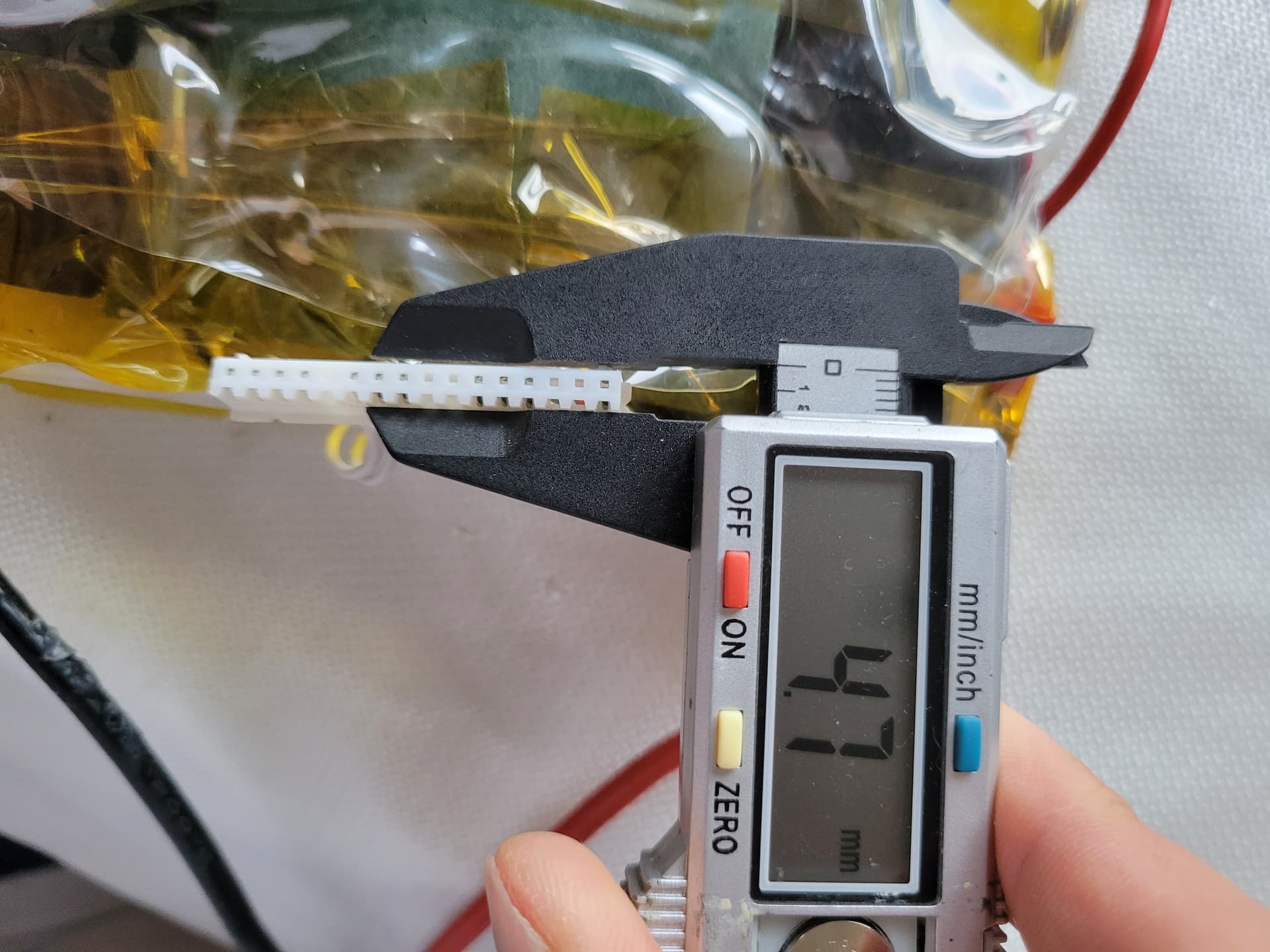

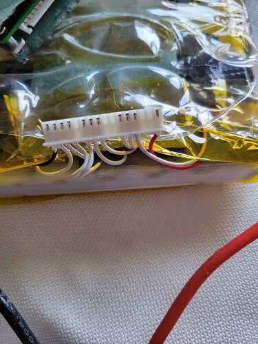

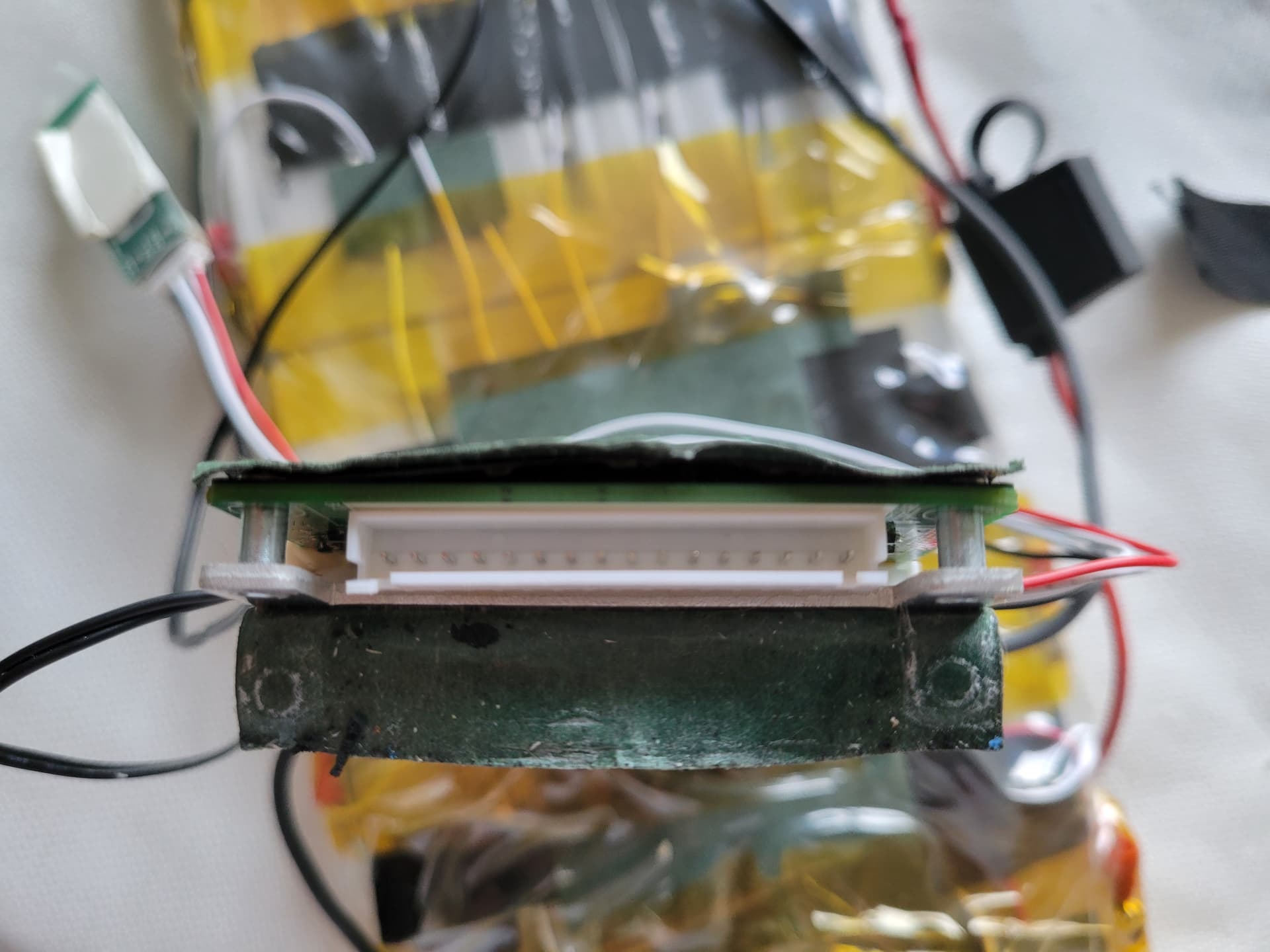

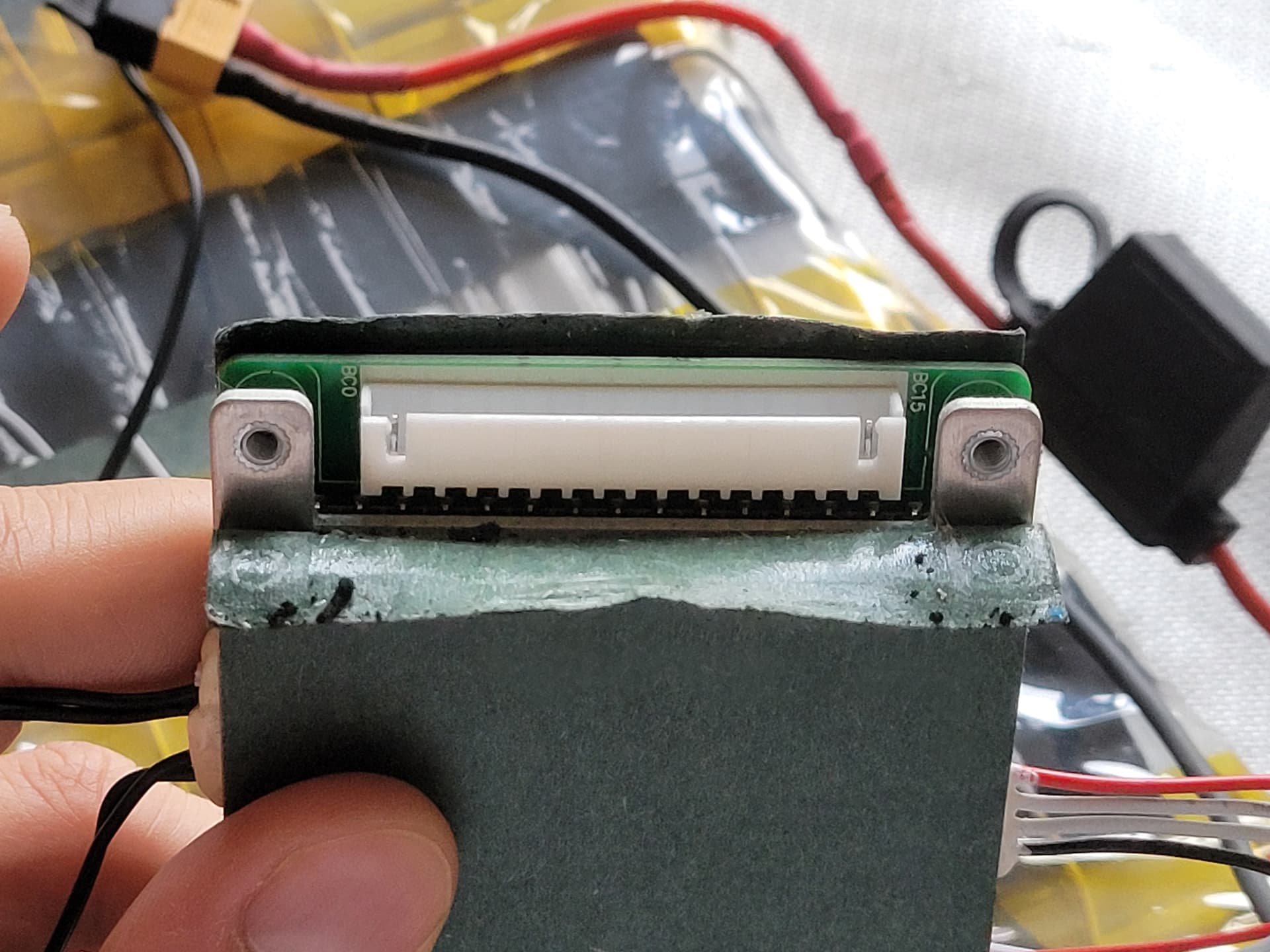

I need help identifying this JST connector. Any help is greatly appreciated.
Its a 10s LLT smart BMS.
Photos:
What’s the pin-to-pin distance?
pretty sure that’s JST-XH
would be confirmed by pin-to-pin distance and it being 2.54mm

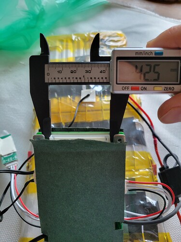

I’m having a really hard time measuring that. It is ether 2.5 or 2.54mm. Is there another way to identify the exact type of connector? Or Ill just buy both types.
Measure all of them and divide by number, more accurate that way.
Use digital calipers
this is gonna be jst-xh. I think 2.5/2.54 get used interchangeably.
