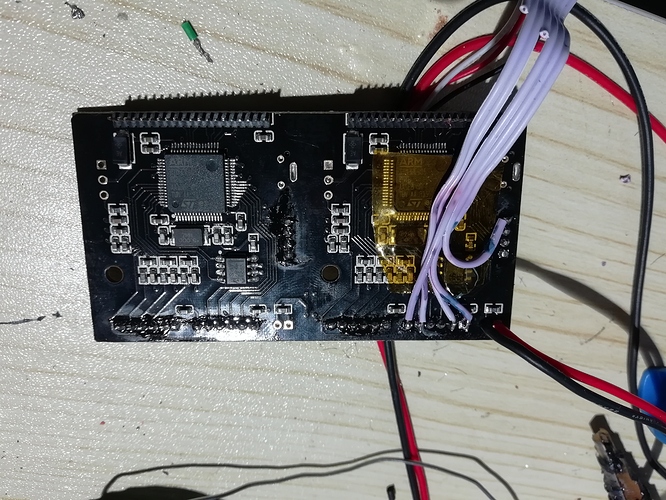

I just modified one of the makerx with a metr pro, a canbus cable and optimized route for the power supply. This is gonna be the one close to the battery plus and minus so no additional caps needed. The one on the other side will have a 2200uf hq cap in parallel.
