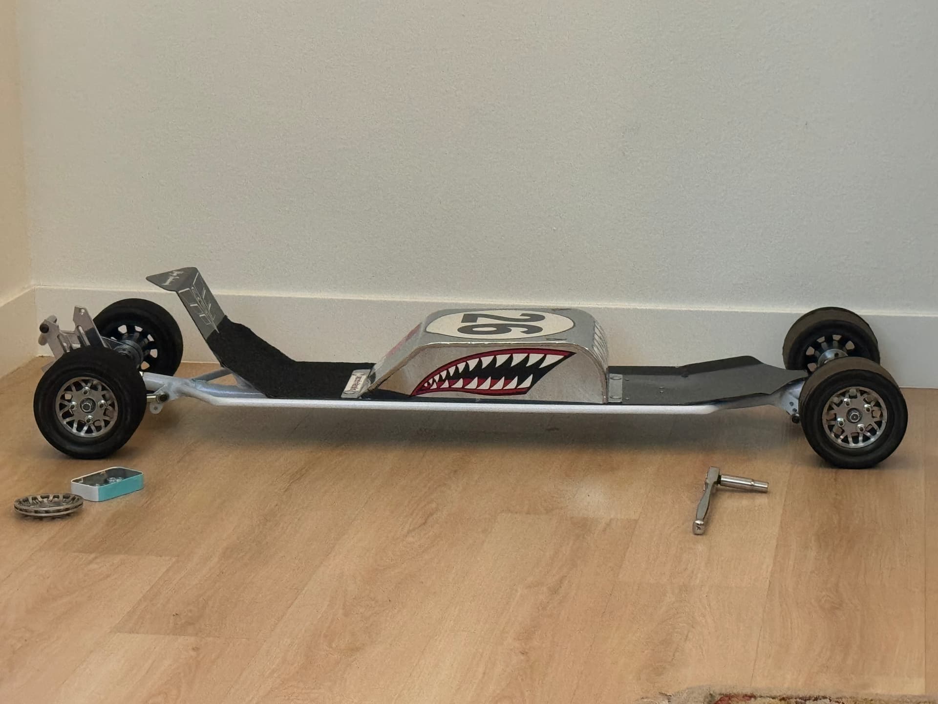

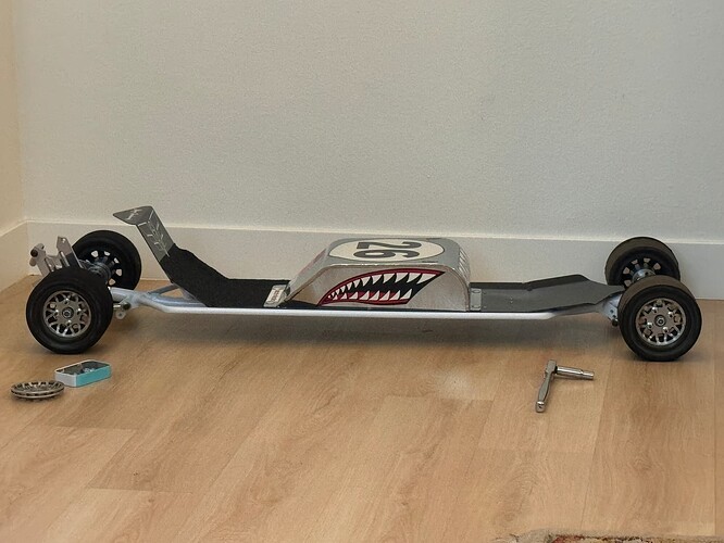

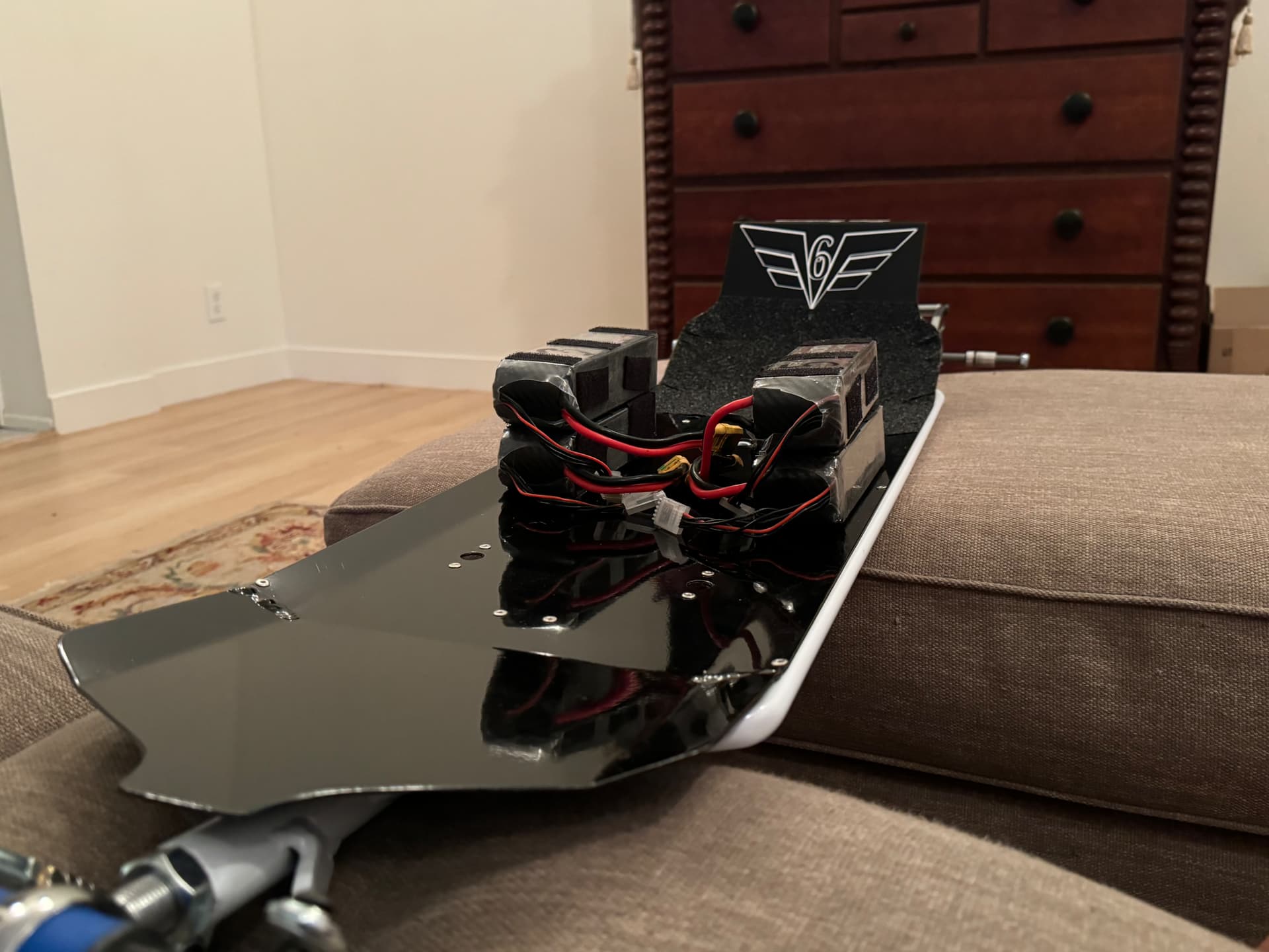

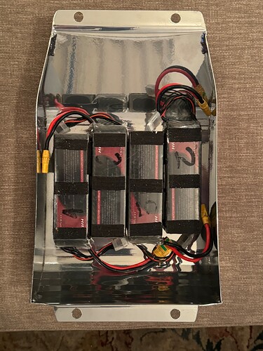

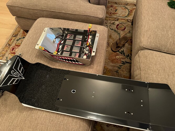

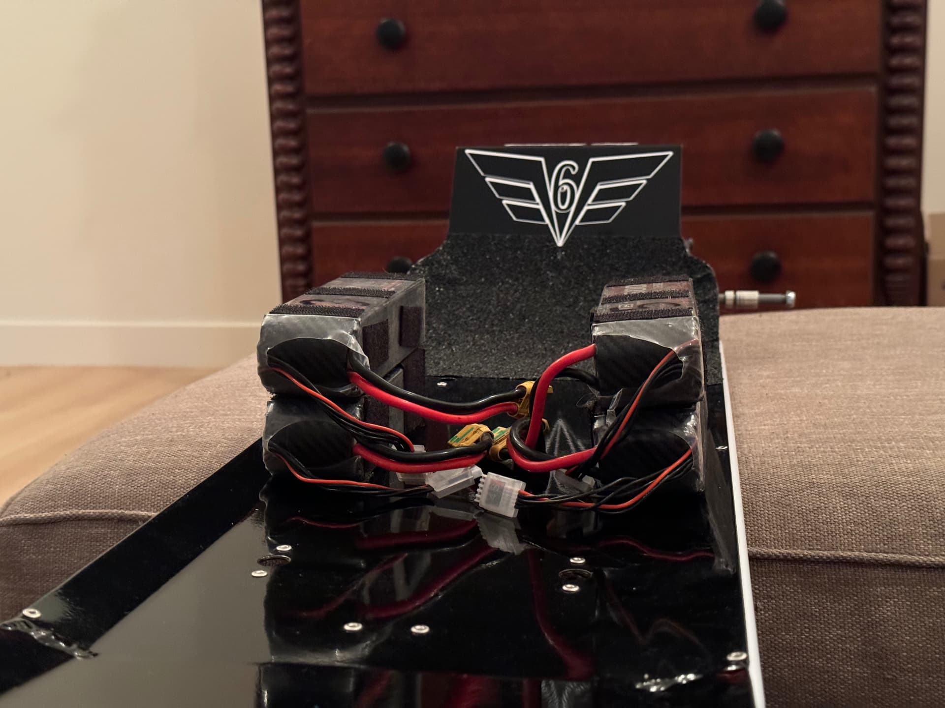

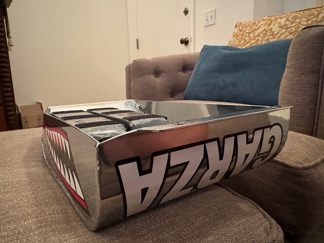

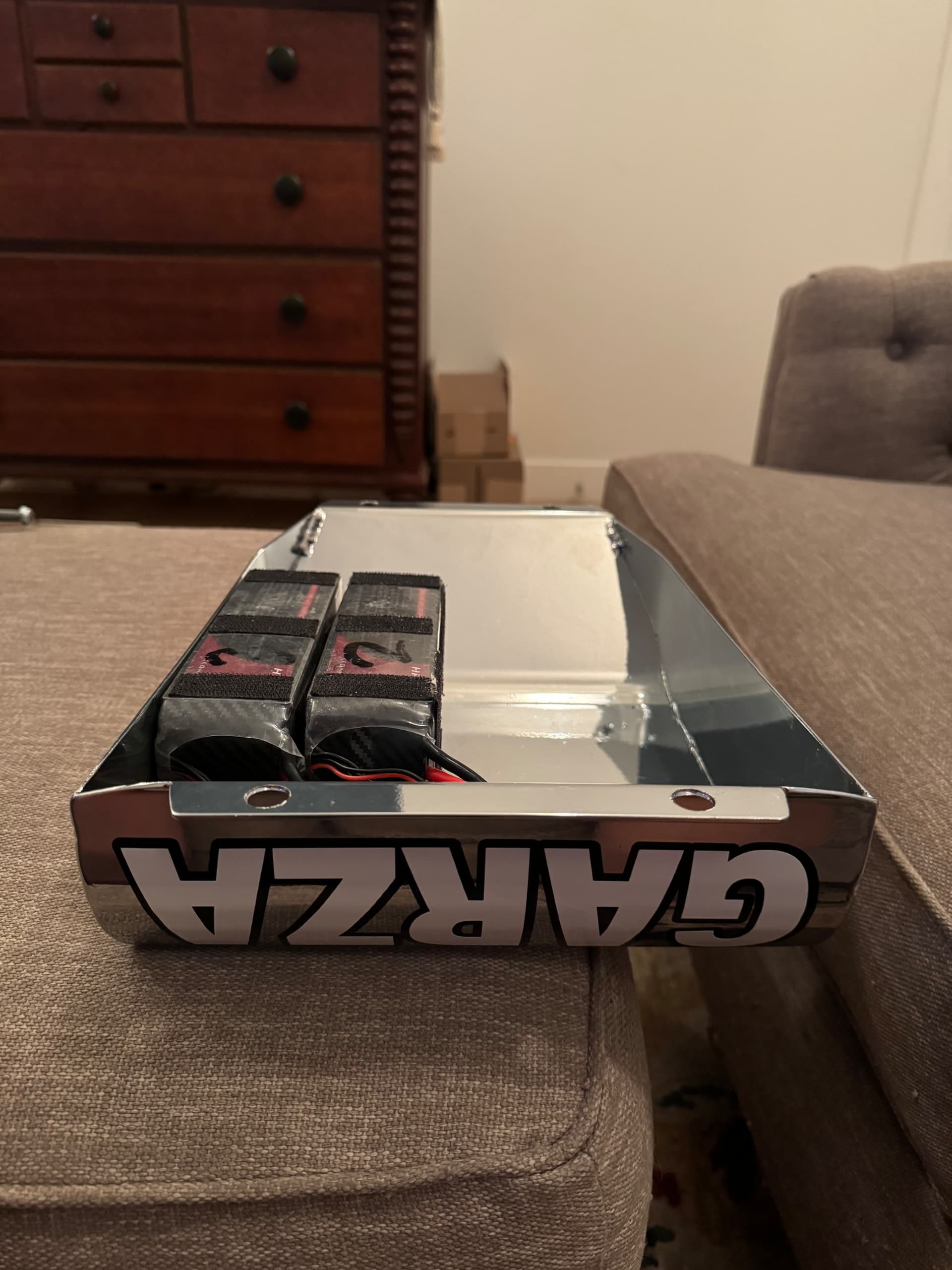

Playing around with battery Fitment… Seems like I could fit 8 of these in here if I really wanted to.
Going to Look at HRBS / SMC Racing lipos for this raceboard.
( I was using my v5 HRB Lipos to play around w Fitment)
8x of these sounds tight HCL-HC 11.4V-10200mAh 120C Hardcase
These also seem cool → FArts
Also These : D —>SHART
I plan to run a BMS with and series of 8 of these.
4 in series x 2 in parallel

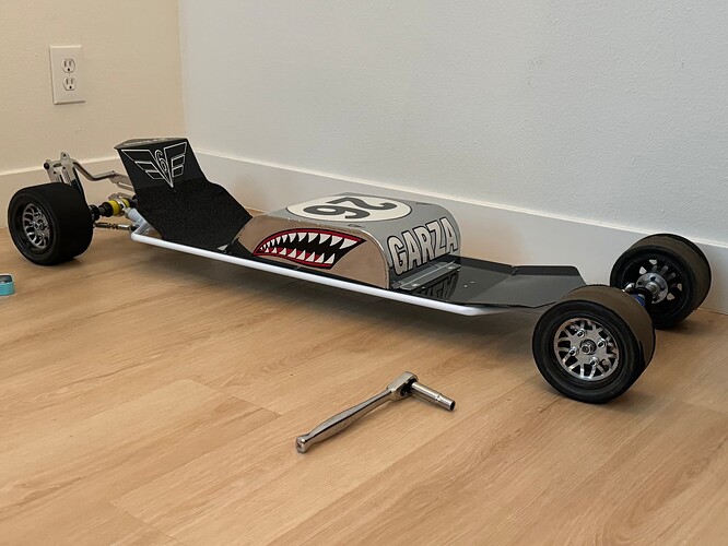

poor thing is sitting in the corner… bought a set of 45a wides for all four wheels today.. in the meantime it sits munching on the old torn up tires :smiley:

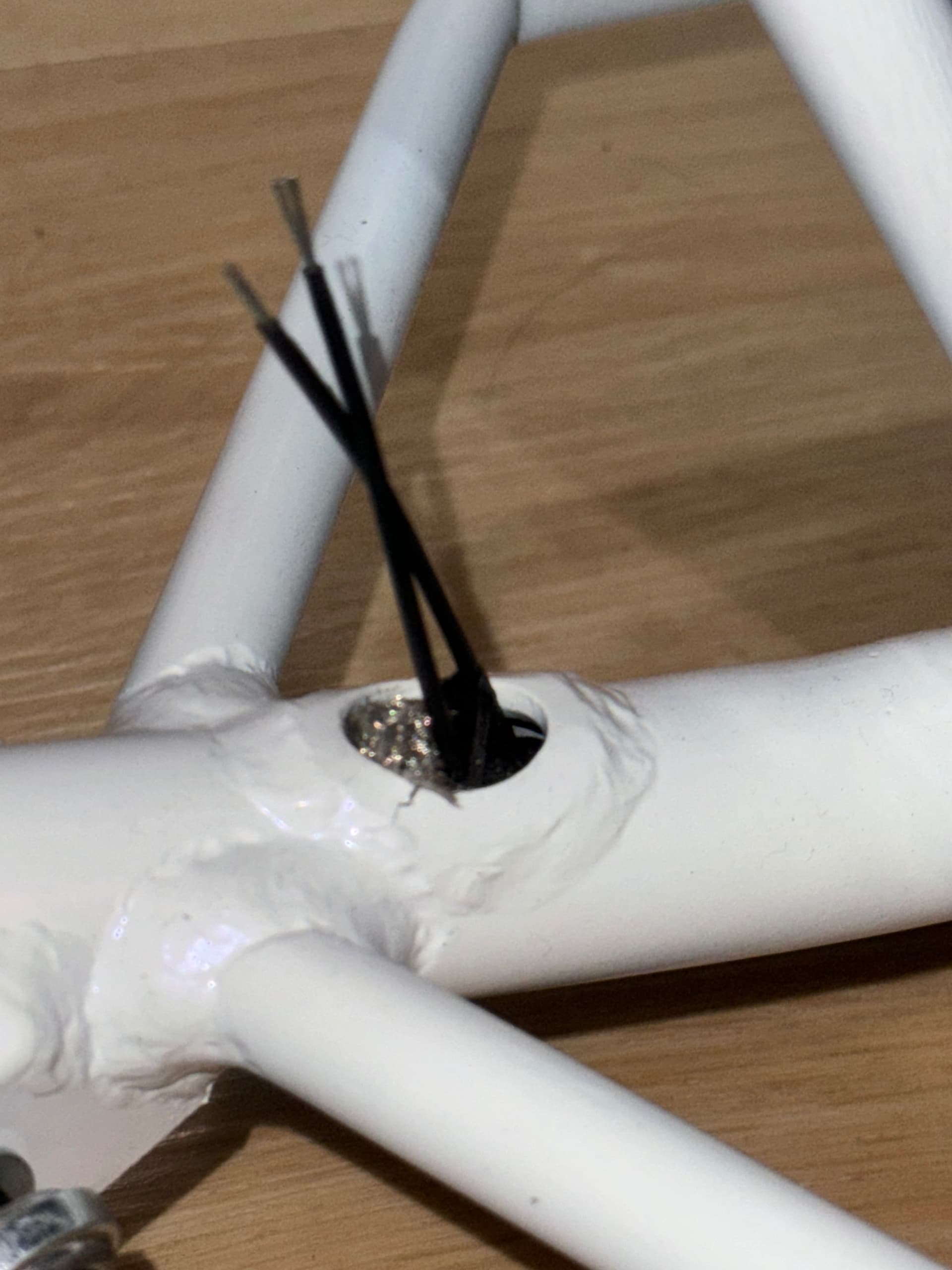

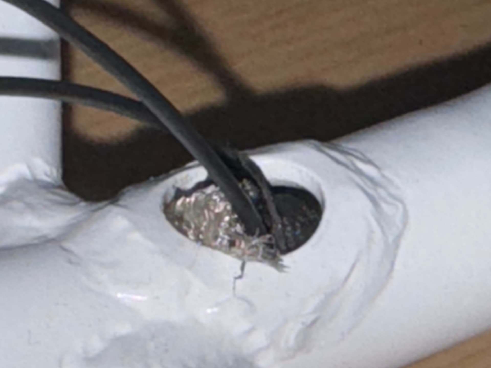

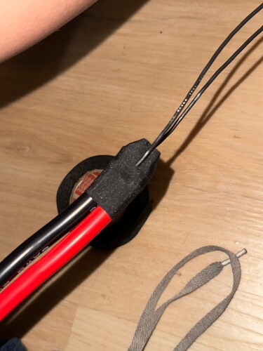

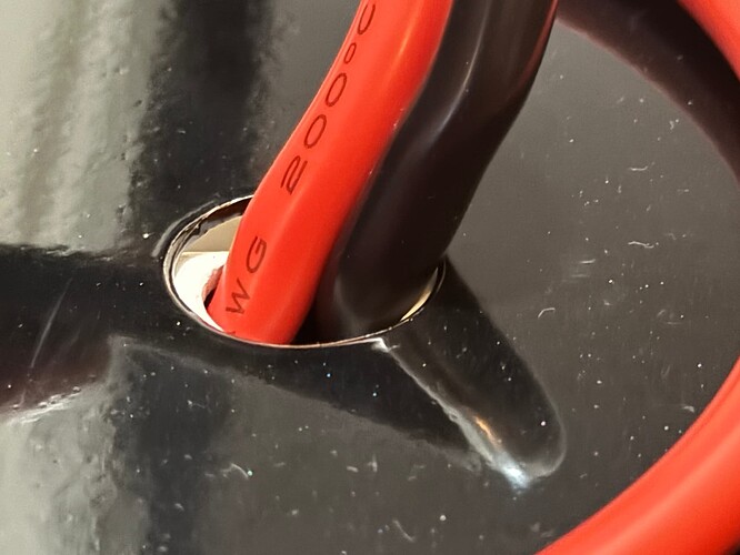

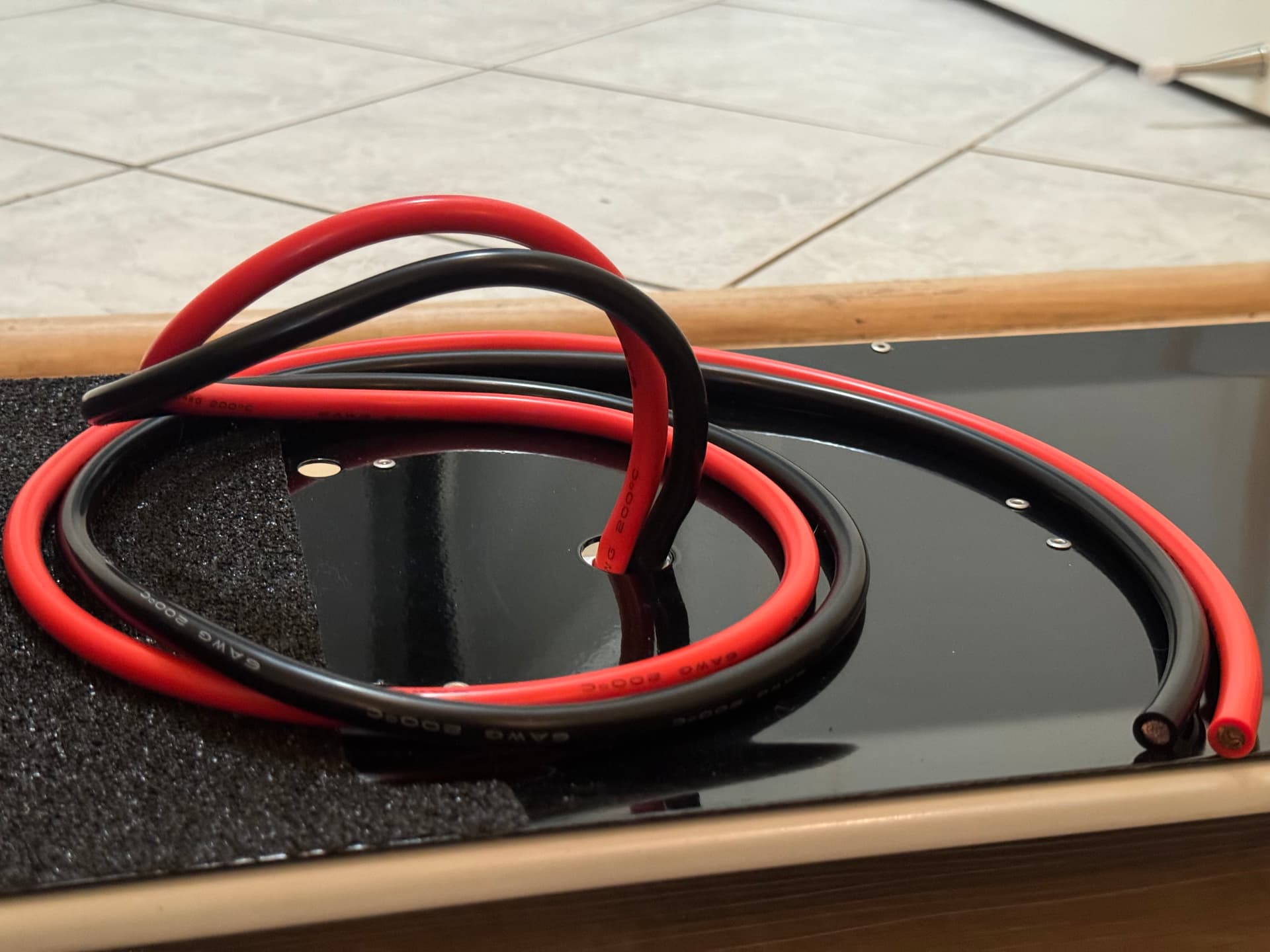

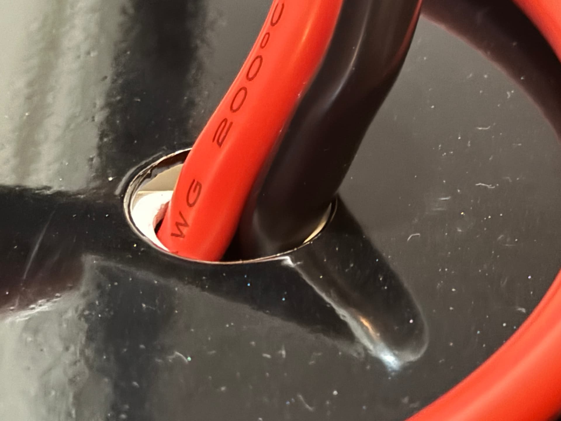

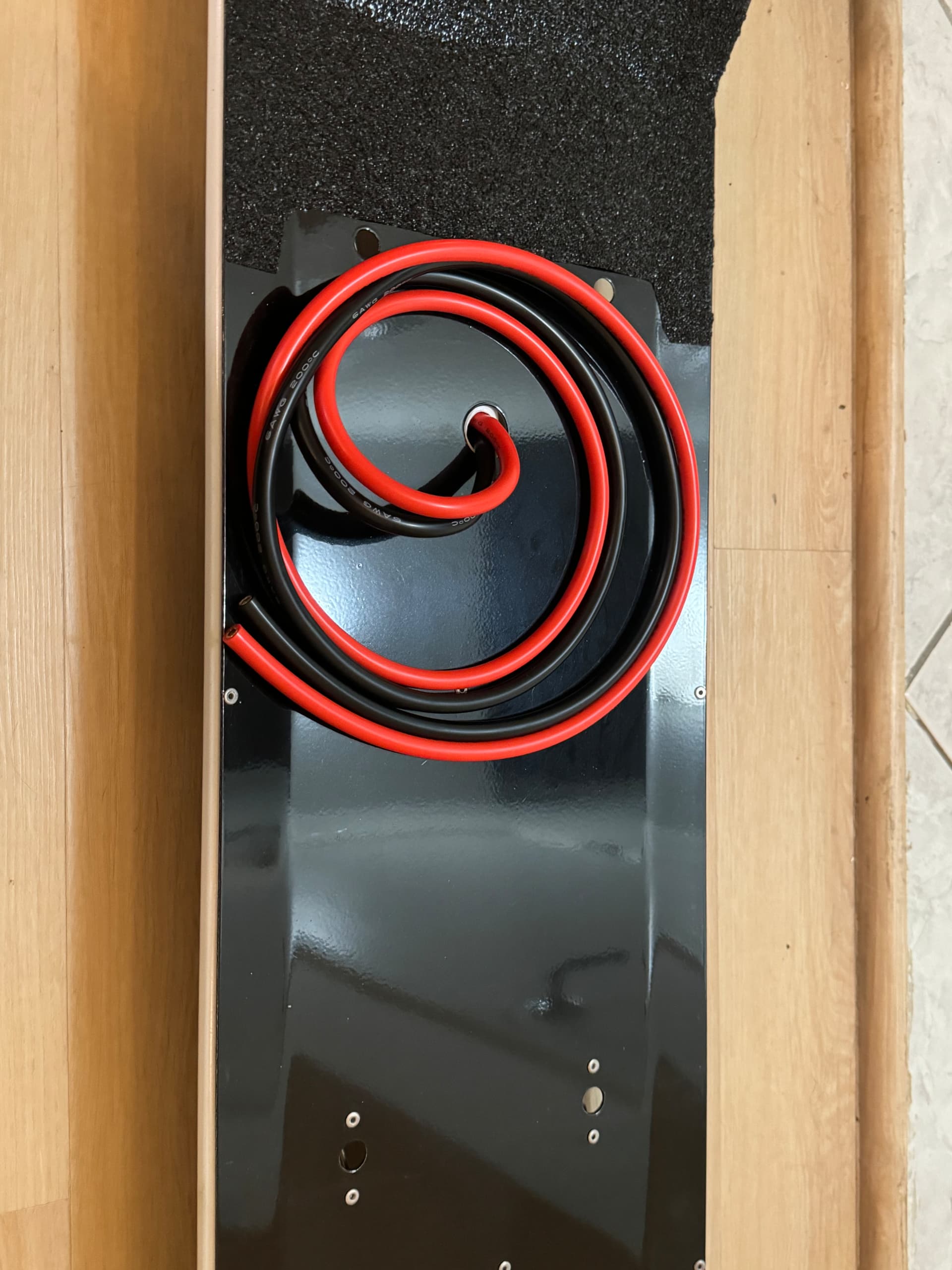

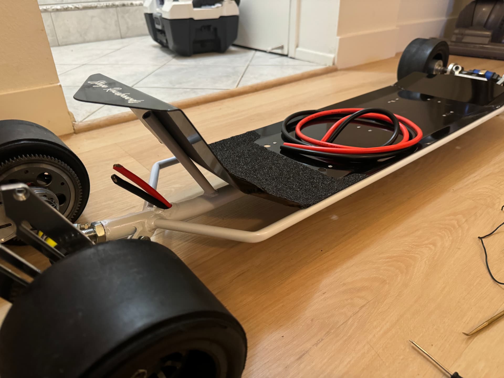

Wrestling with one of of dang ol ampere snakes
Maybe I should have went with 8 gauge :joy:
I made it pretty far down the tube but the silicone is grabbing the steel from friction a lot now.
I have an idea tho
Tape & string
It’s right there it’s just thought to feed the wire in from the battery side and pull at the same time.
And that was a fail. It’s binding so hard that.
It tore the Smaller wire I was using to feed it through. I didn’t have any string.
I think I can get it next time
Wish me luck

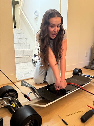

Okay mission success
With a little help from my little sister
I do not wish that upon anyone that was complete bullshit
If you buy a V6, definitely go 8 gauge
Snake remains under the chrome urn :funeral_urn: okay bye gotta go

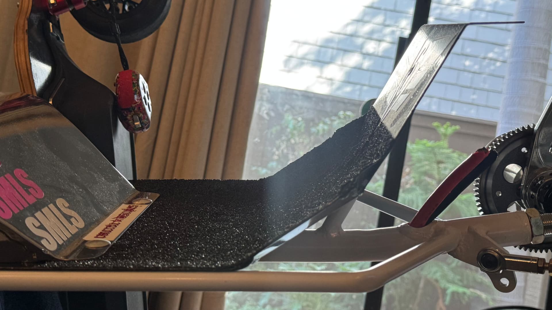

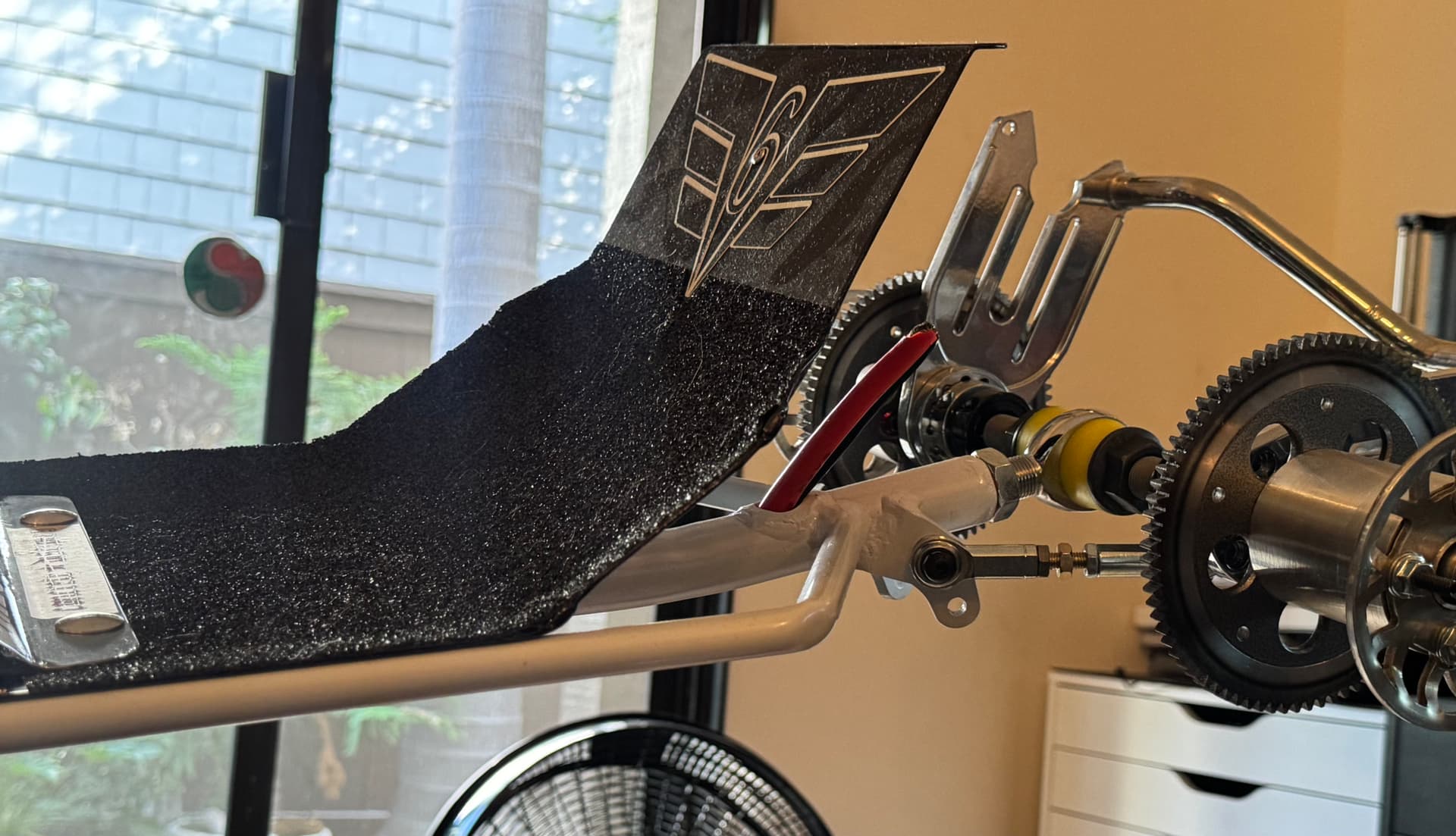

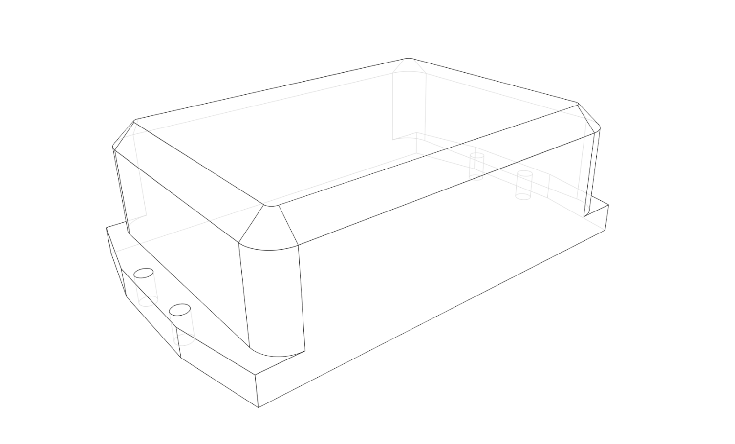

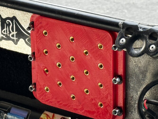

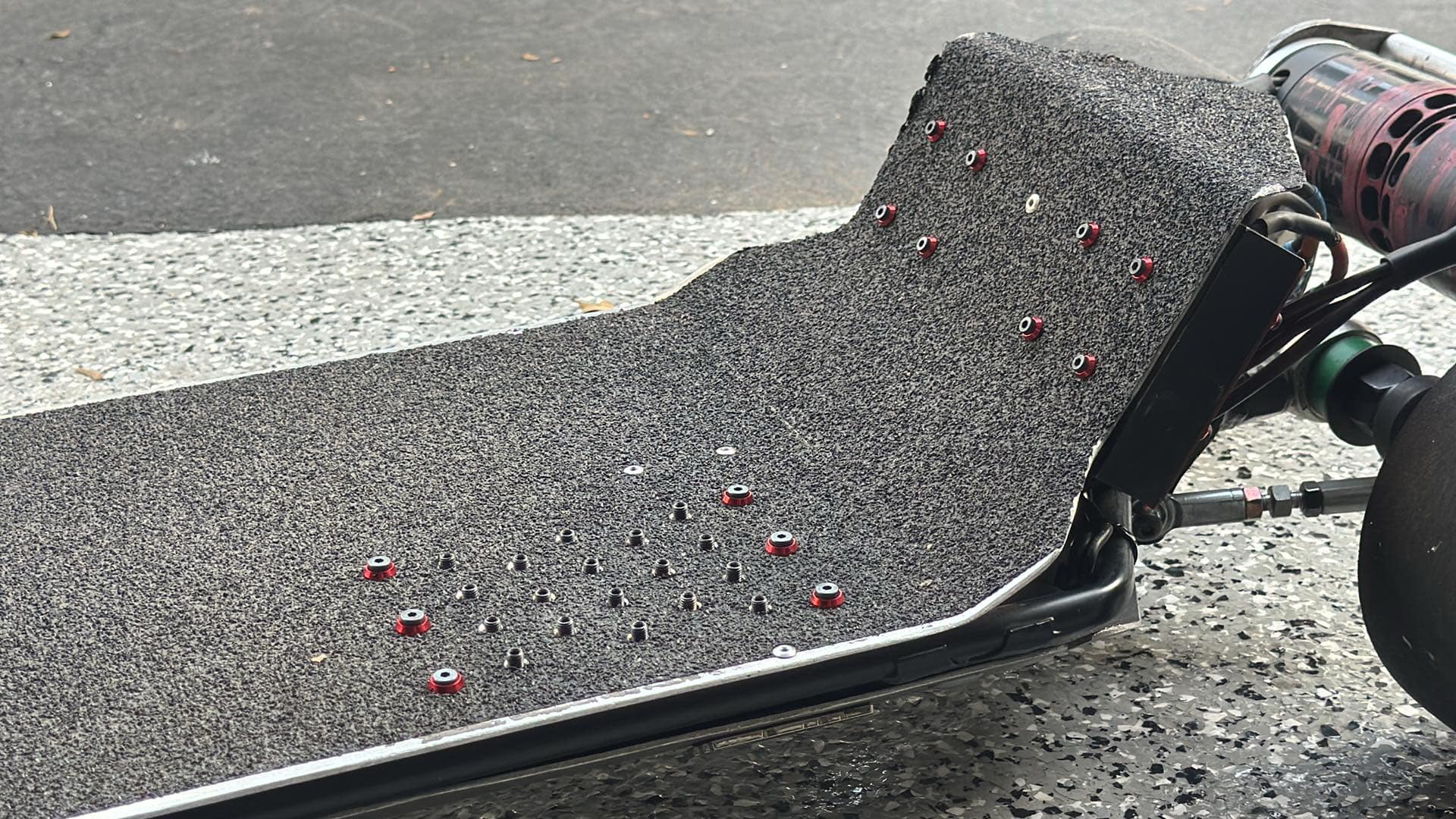

Alright so I really wanna do what I did with my v5 with the rear grub screw grippah
But the volume is drastically reduced. And my original design will not fit even if I use a hammer :frowning:
Old design Reference
going to get sizzlerifico on onshape after my homework.
I’m thinking a multipiece design. and maybe even putting one on the front side foot aswell but im scared that plus a binding would tear my ankle off in a freak accident crash when im going hard… hmmm choices choices

I actually prefer staying fully locked in in a crash, though that only works if both feet are fully locked in. Then falls are like snowboard falls. But definitely need good protective gear and ideally a moto leather suit for that.

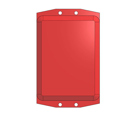

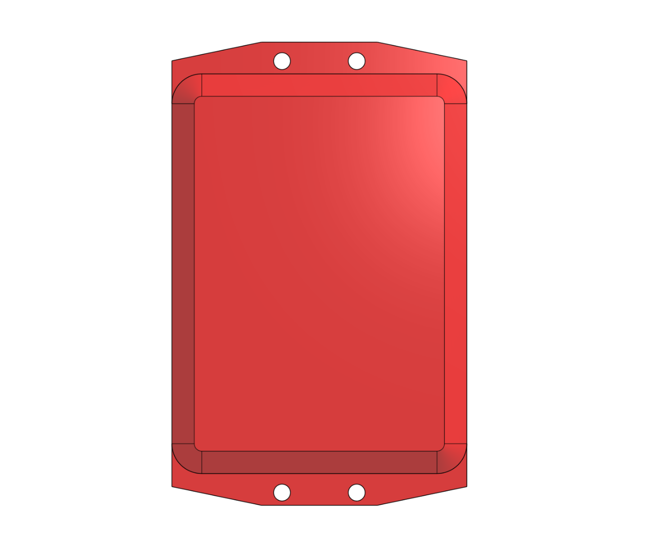

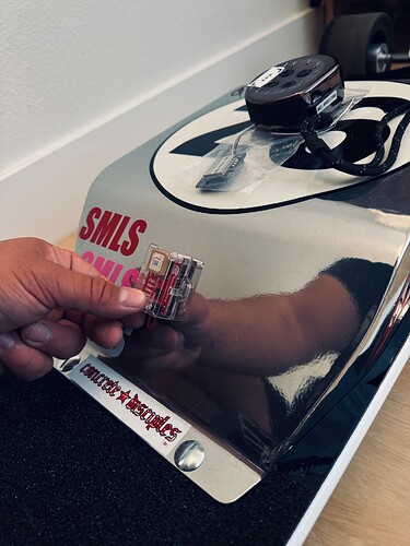

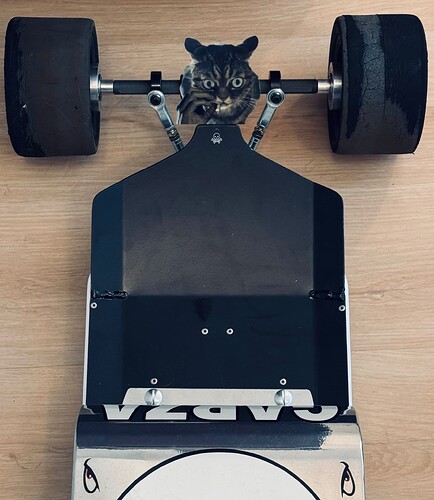

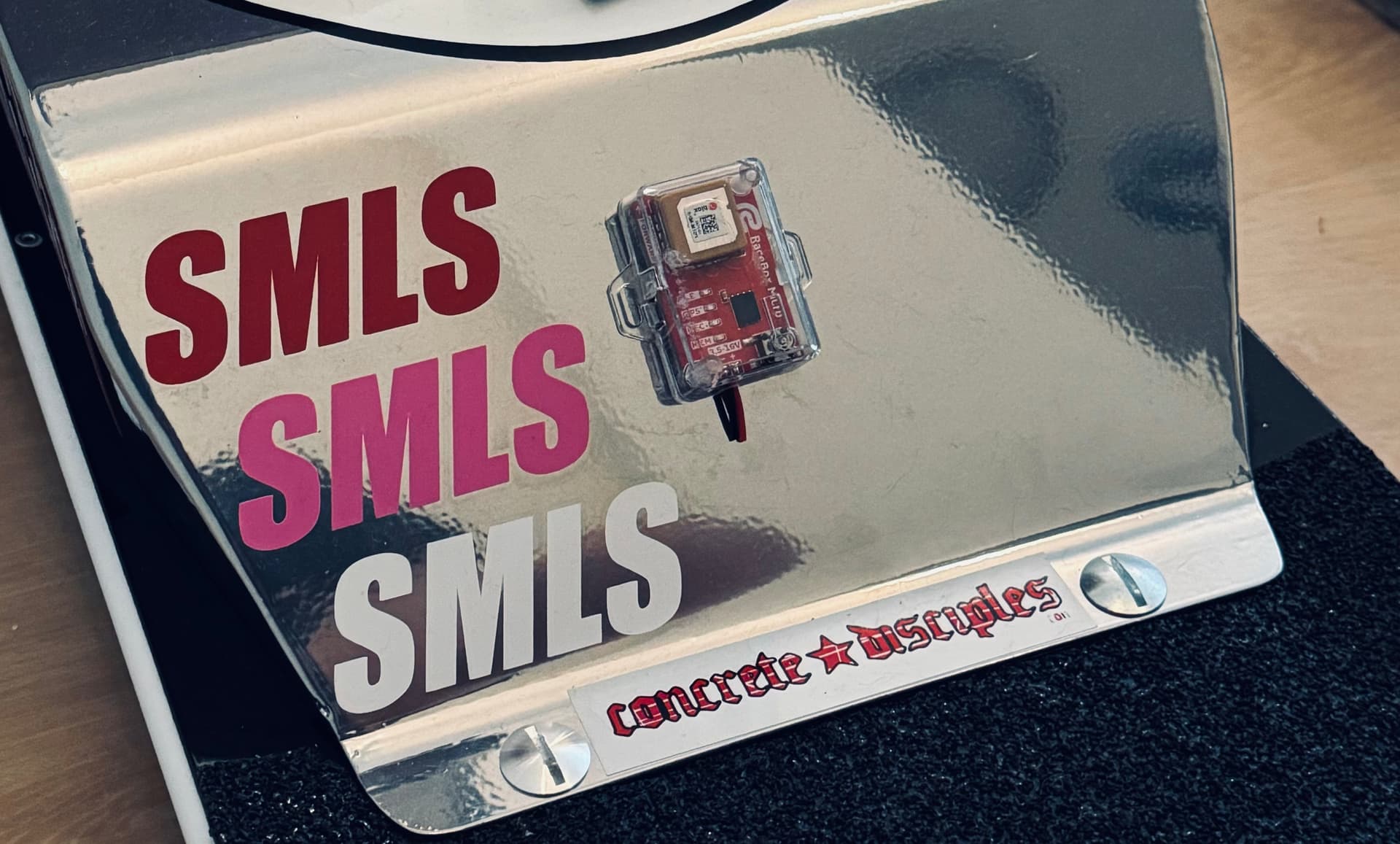

For context on why I’m doing this because I don’t have the VESCS on hand as I lent them out
I modeled a real basic fake g300 for spacing
I want to Drill the holes for mounting and start working on designing the bottom support Bracket that I need to design. → tucker has already done so

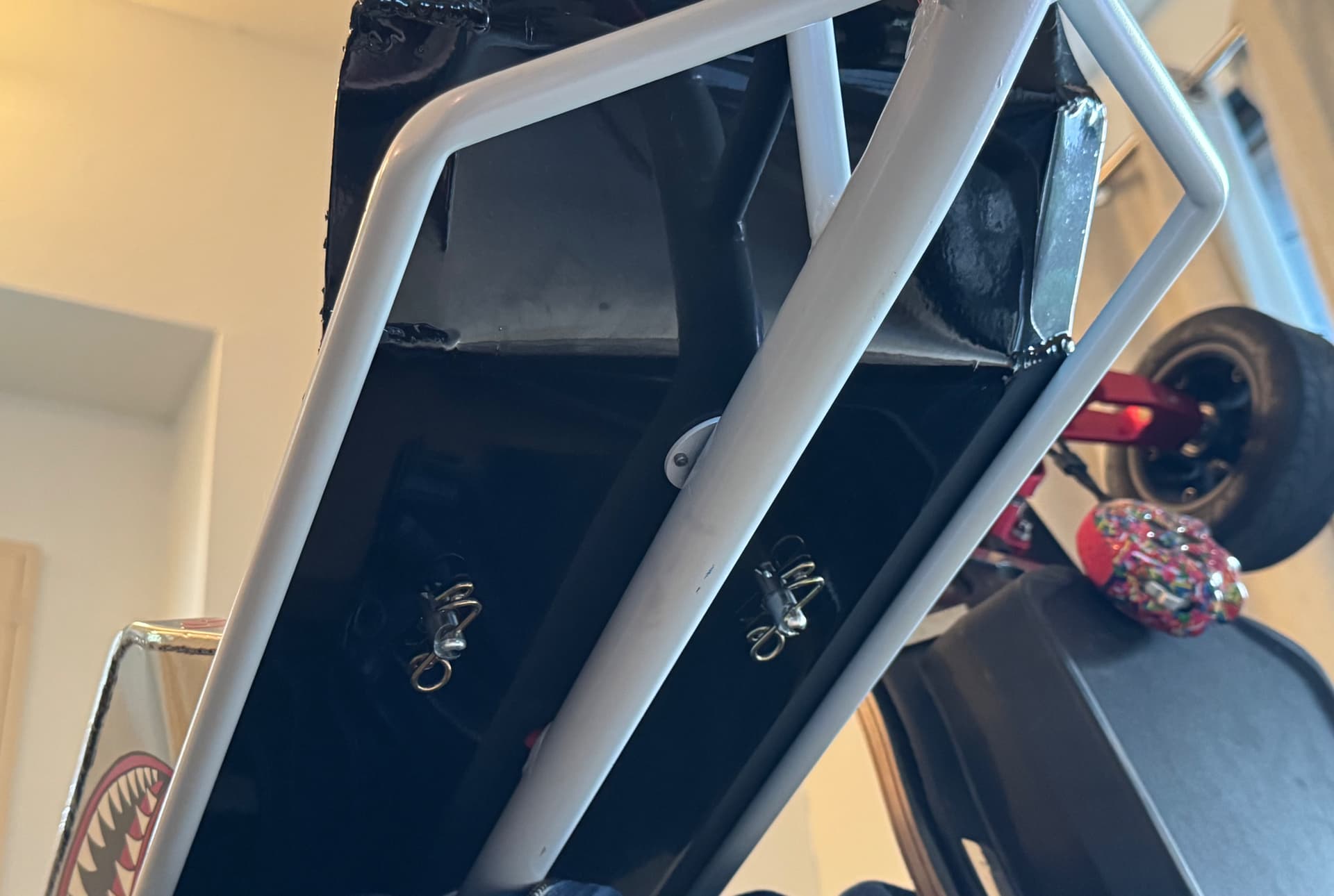

As the bottom of the ESC will hang off, There isn’t enough length on the tail as it changes angle after a certain distance.
The only problem I have is the signal harness port I could not find dimensions on
and idk if the support bar in the middle of the tail is going to cause me issues in reference to colliding / straining at a aggressive angle from being to close.
