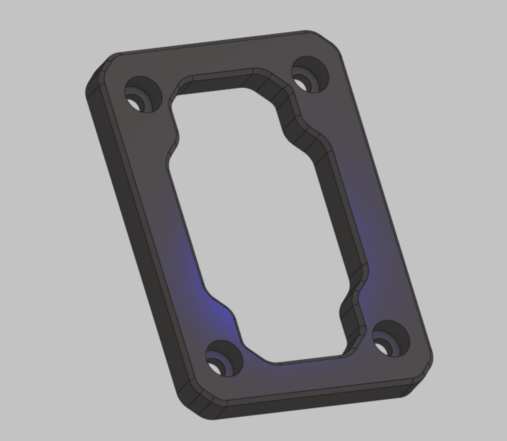

  1. Super Compact XT60 (Male) PANEL MOUNT
    file being revised

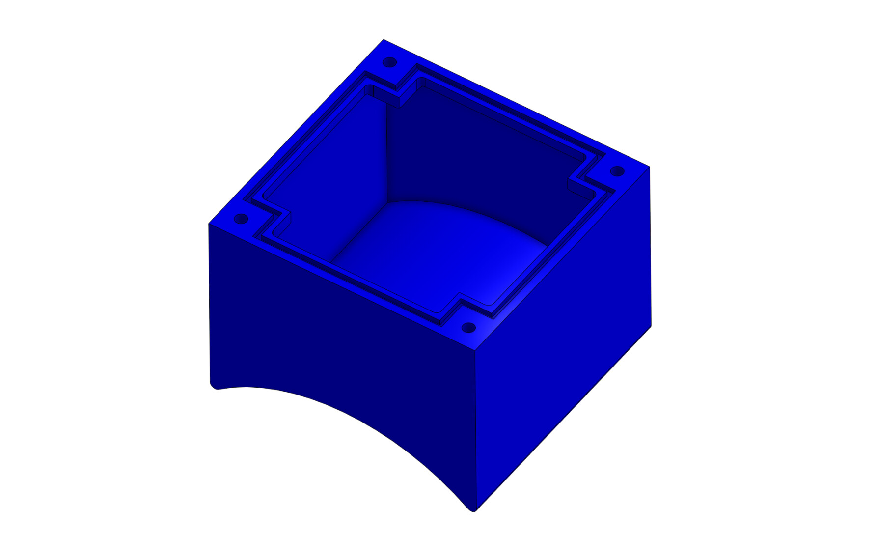

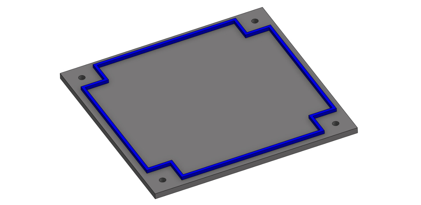

  1. Stomp pad
Specially Designed 4 the Vans Waffle Pattern goes great on the underside of your Race board as the Grub Screws poke through your deck or aluminum sheet or whatever
Image Preview
—> Rear Left Foot Grippperrrrm5 new.STL (210.4 KB)
Revamped this thing to have a Rabbit / Lip idk if that’s what its called at least that’s what they call it in wood working
going to print Later today

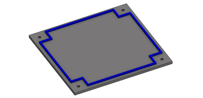

last iteration I was having serious thermal contraction happening causing the print to lift even with a Brim..
hoping with this iteration it prints much better being there is a bit more to grab on the bottom.
but basically you fill this thing with sand + put glue in that lip tract and Seal er up
but only after you put ur threaded inserts in for your Rubber FEET
And then what? :thinking:
@glyphiks
Um… I talk a little funny sorry
Basically just putting glue in the recessed track
So when the bottom panel conjoins with the body it has a seal so that sand doesn’t escape.
Idk if it’ll work it but it’s a fair attempt at trying to create a seal anyway
Profit!

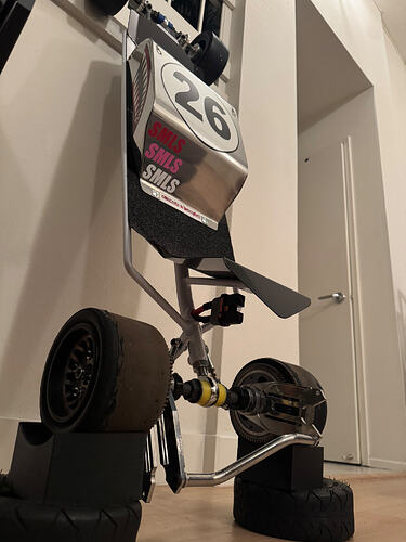

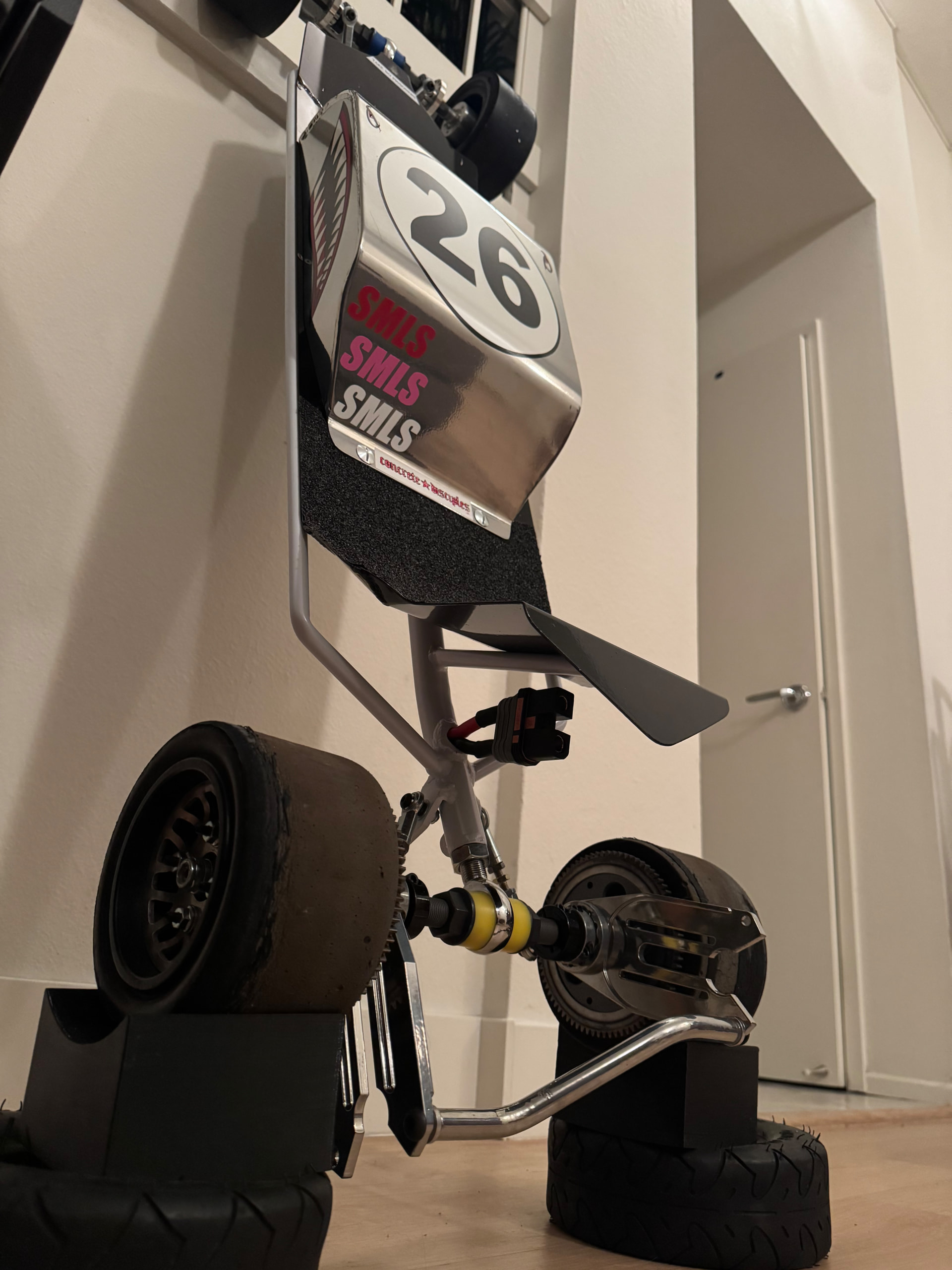

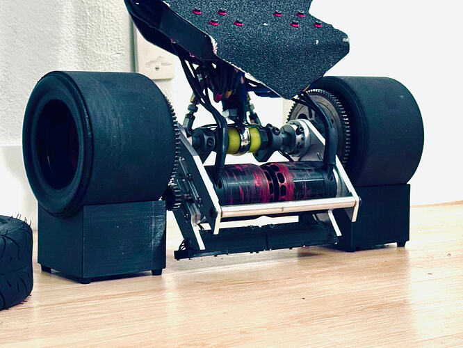

Lol i meant - what is the box of sand for? :sweat_smile:

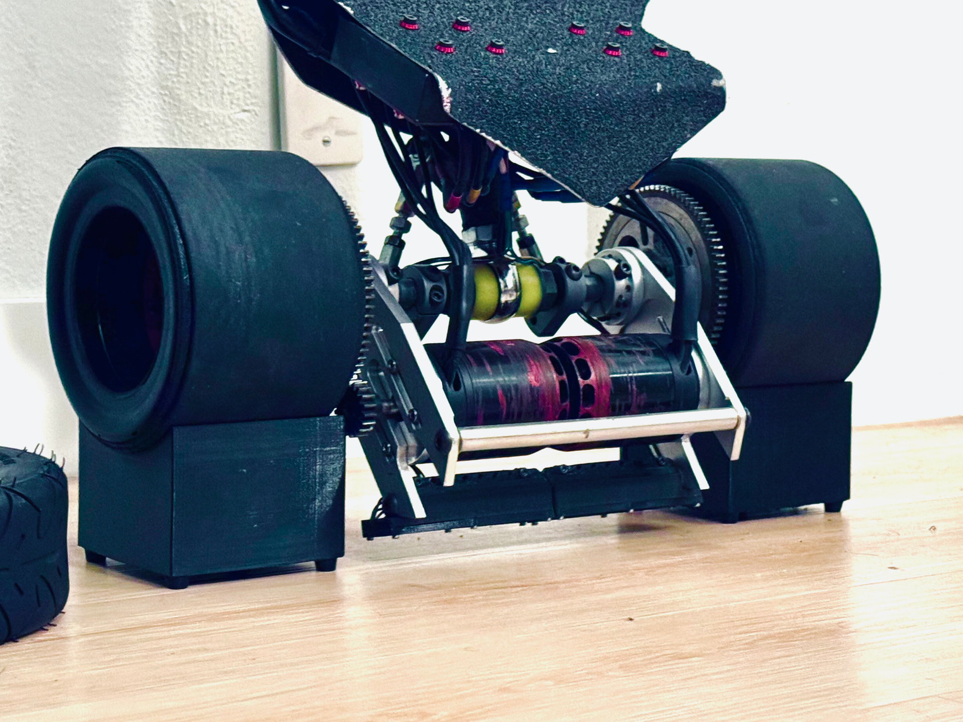

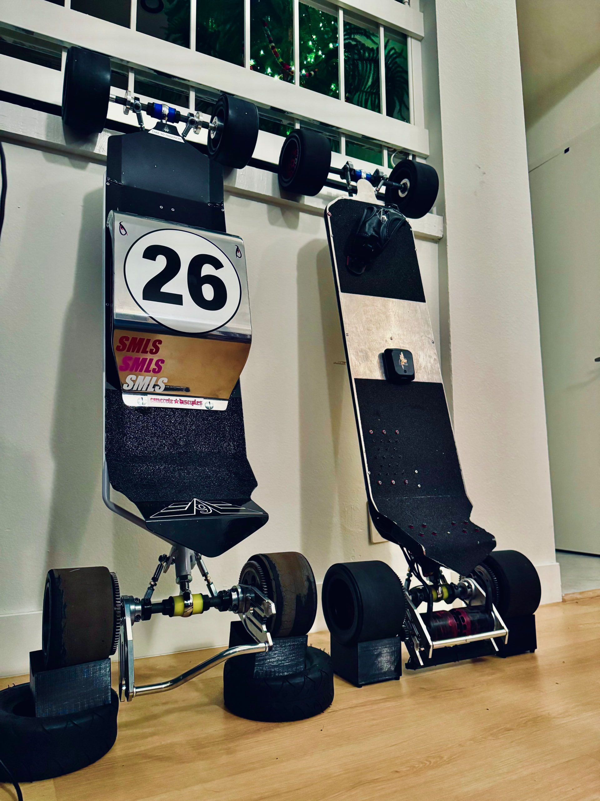

These are the first prototypes that I fucked up on
But these are what they are for
Just weighted wheel stops for leaning your board against a wall
Pretty sweeeeettt
My v5 is on the new revamped model
And I haven’t put sand in it to utilize the weighted feature it could have yet as I’m
Printing the bottom panel… which should help raise the thing a couple extra mm.
My v5 taillight barely clears the hardwood floor. :sign_of_the_horns::black_bird:
When I made a similar design, I wished that I ‘d made a piece to link the two chocks and keep them at the perfect width

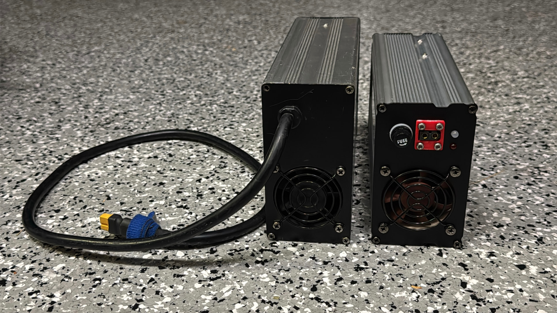

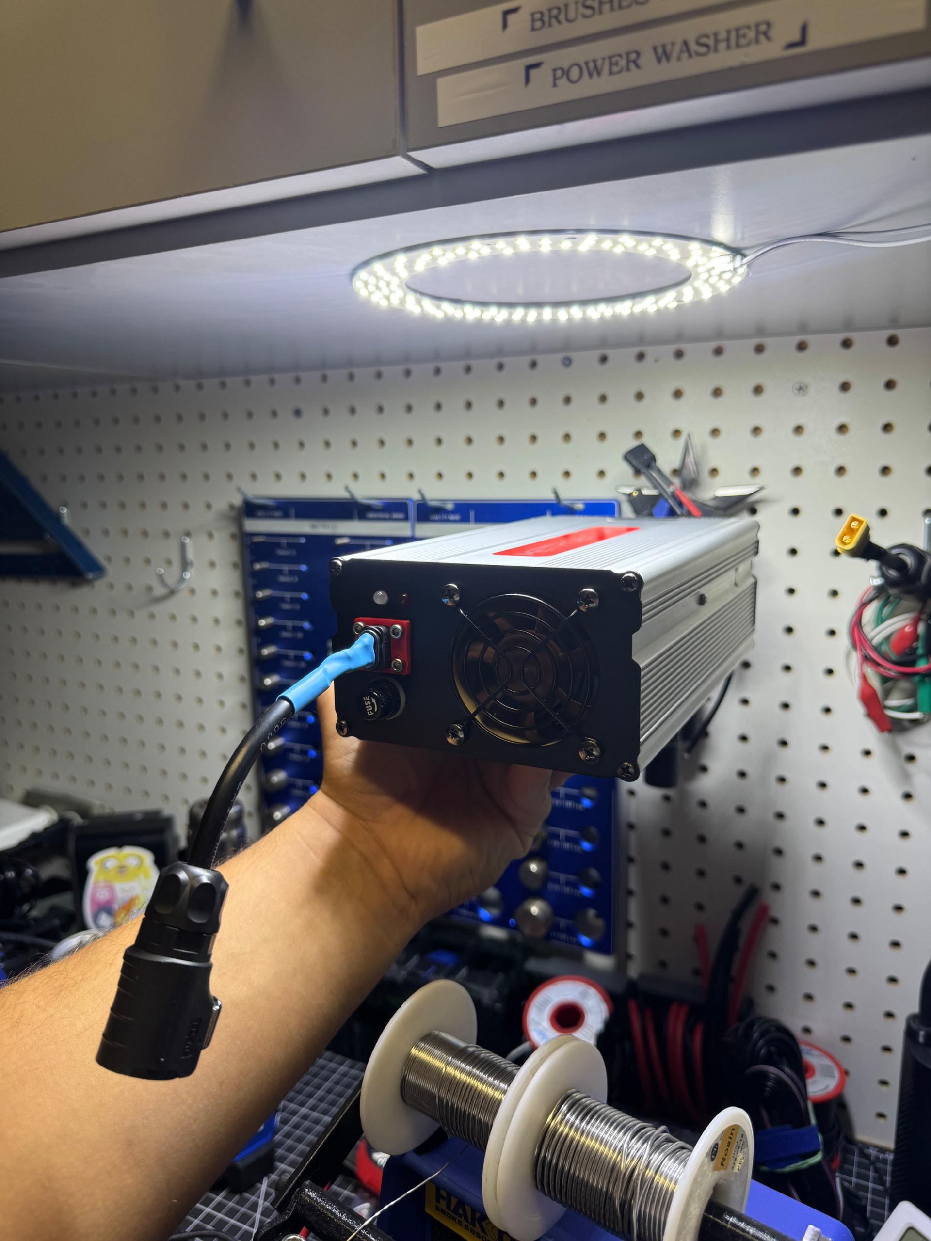

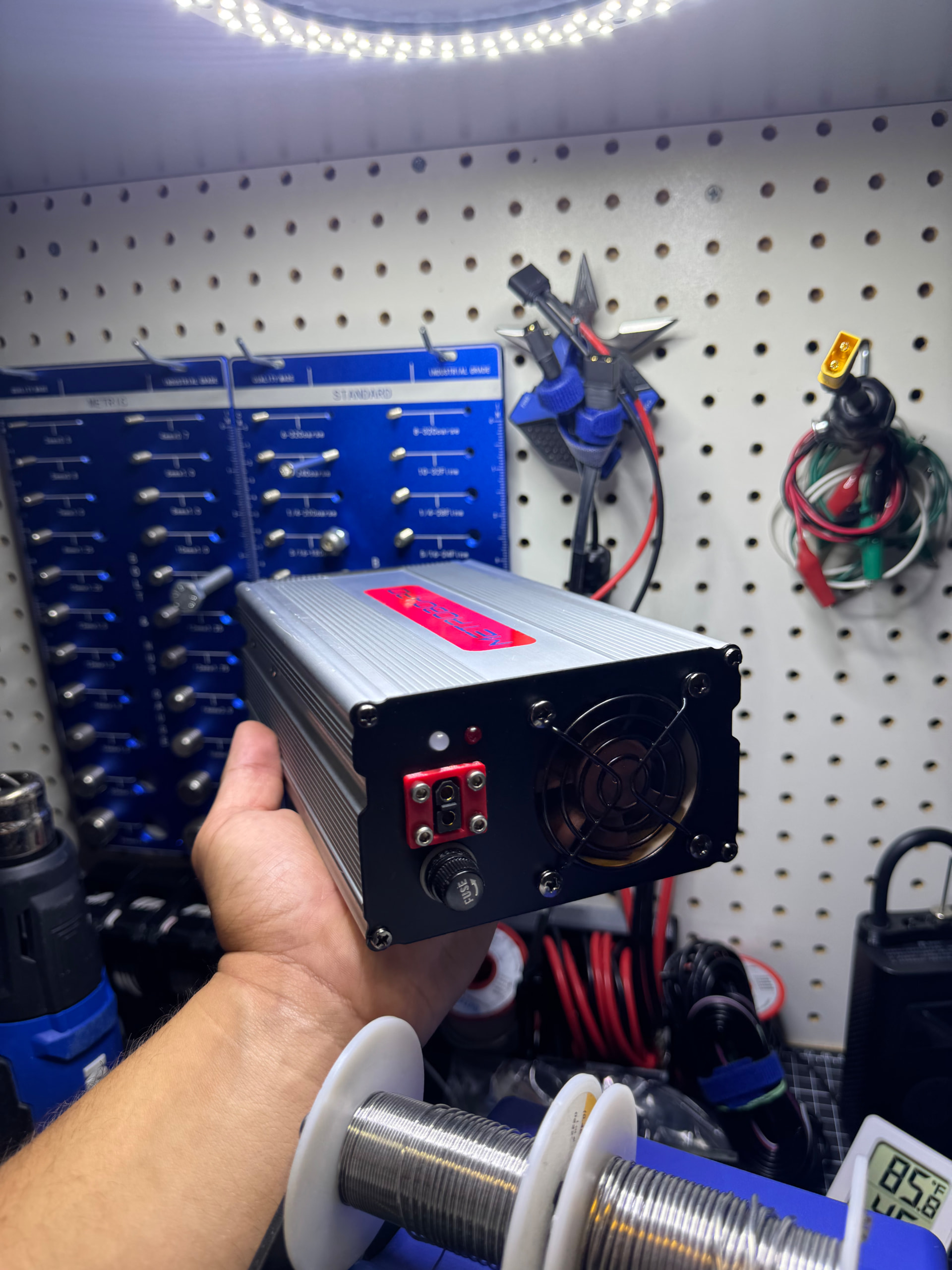

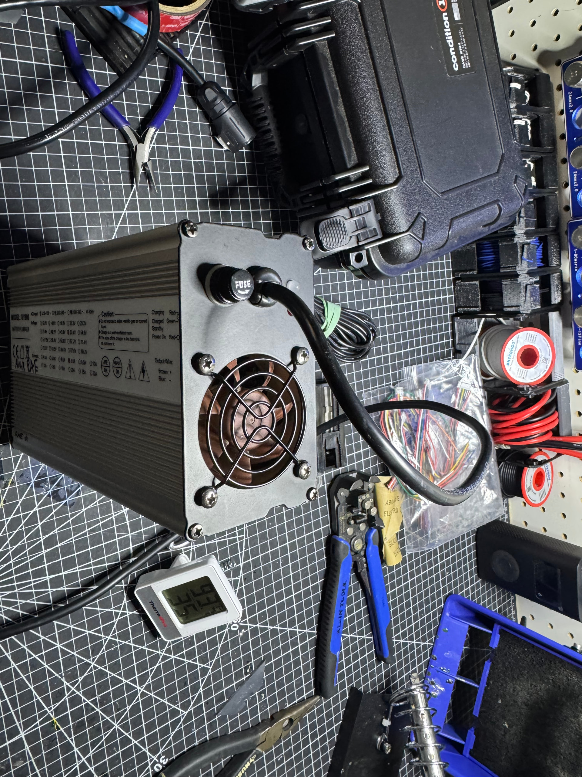

I’ve wanted to do this to my charger for quite some time
I hate when chargers don’t have an input & output port. It can make for a very annoying use of storage volume.
This is a great idea, i also hate that
Thank you sir!

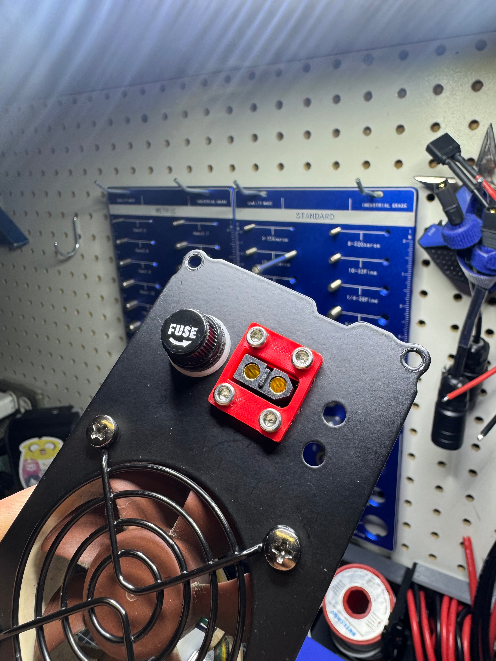

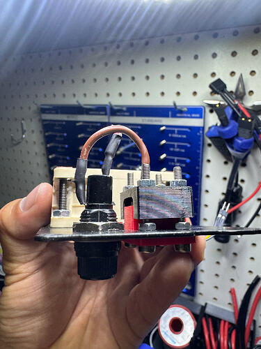

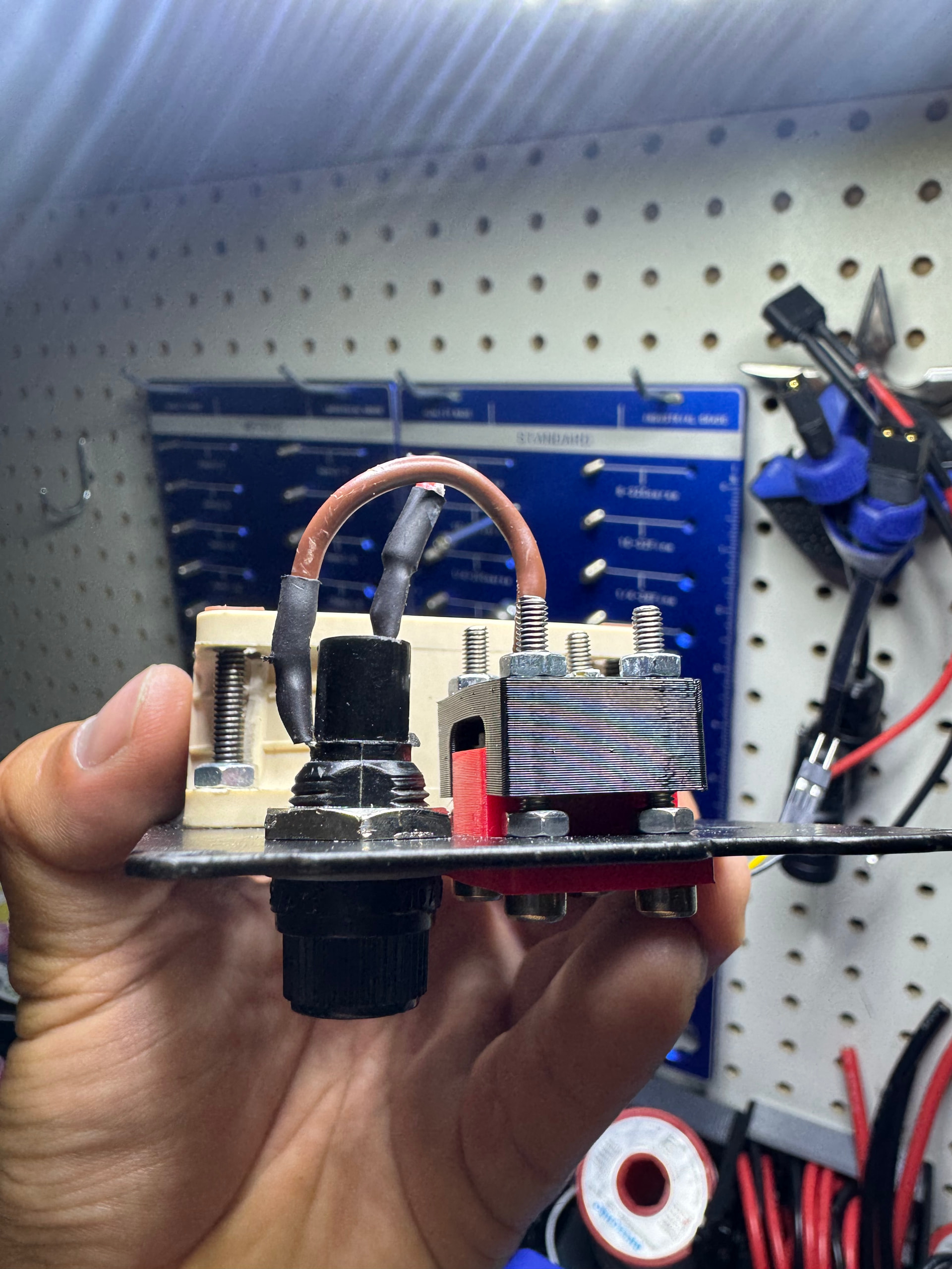

I have yet to test the back plate, my 3d Printer is in the shop atm
But four m3 Screws will be utilized to clamp the panel mount & the Xt60 Connector in place!
I definitely recommend printing with a .25mm nozzle once I release the files
I don’t think .4mm will cut it
Tbf i’d likely just use the amass panel mounts :rofl:

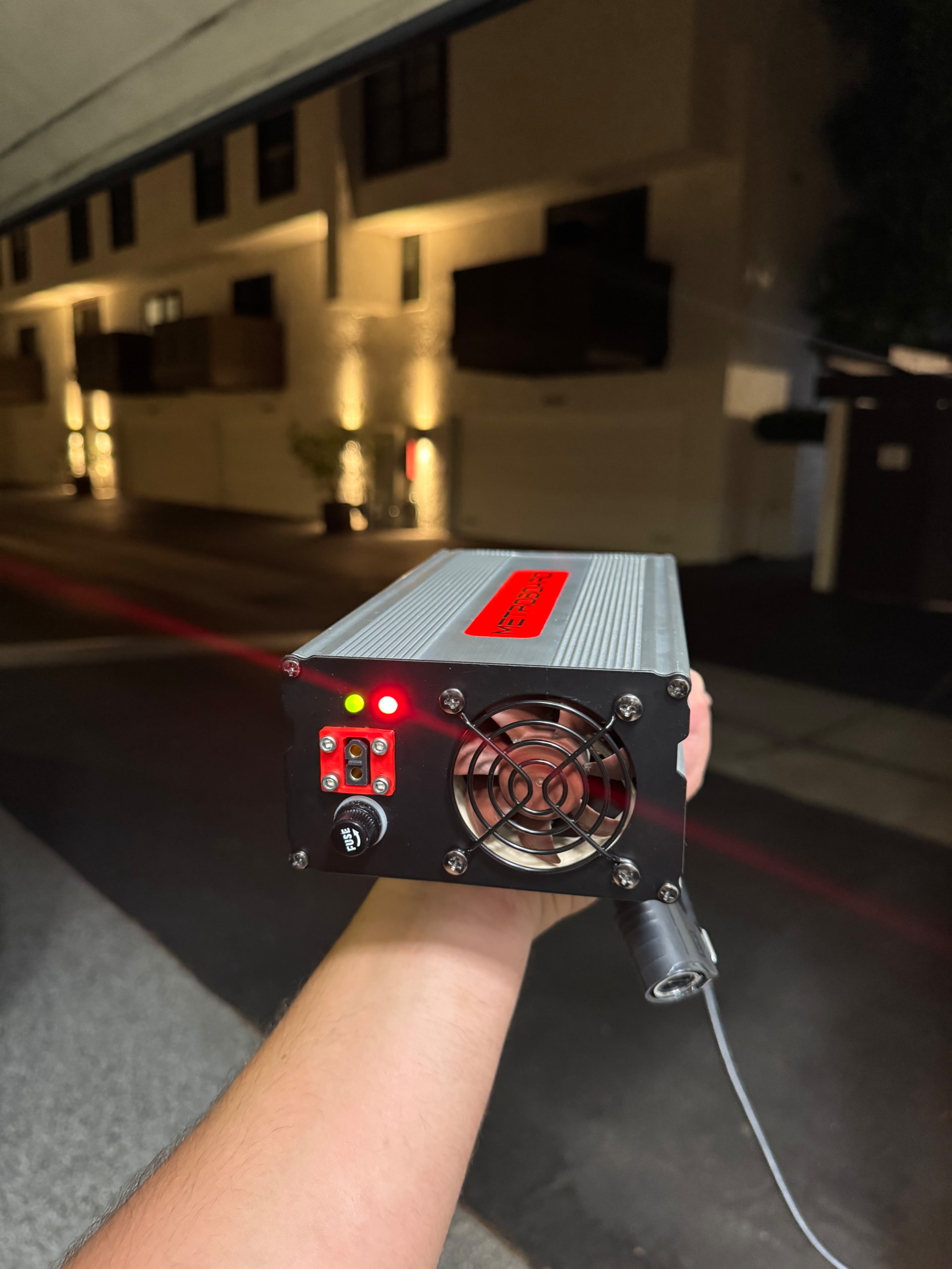

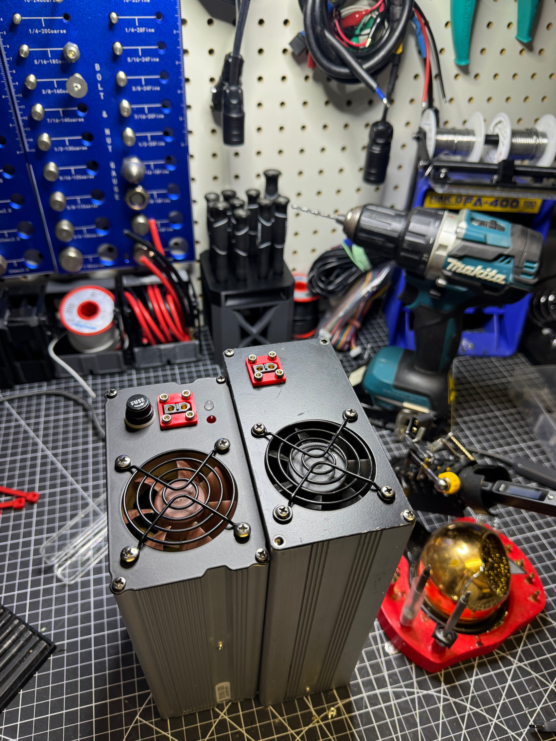

Bonus pic :smirking_face:
Second charger done!, they just look so good I started doing it to my 20s charger that I don’t even have a build-for and burned the hell out of my hand with my soldering iron.
