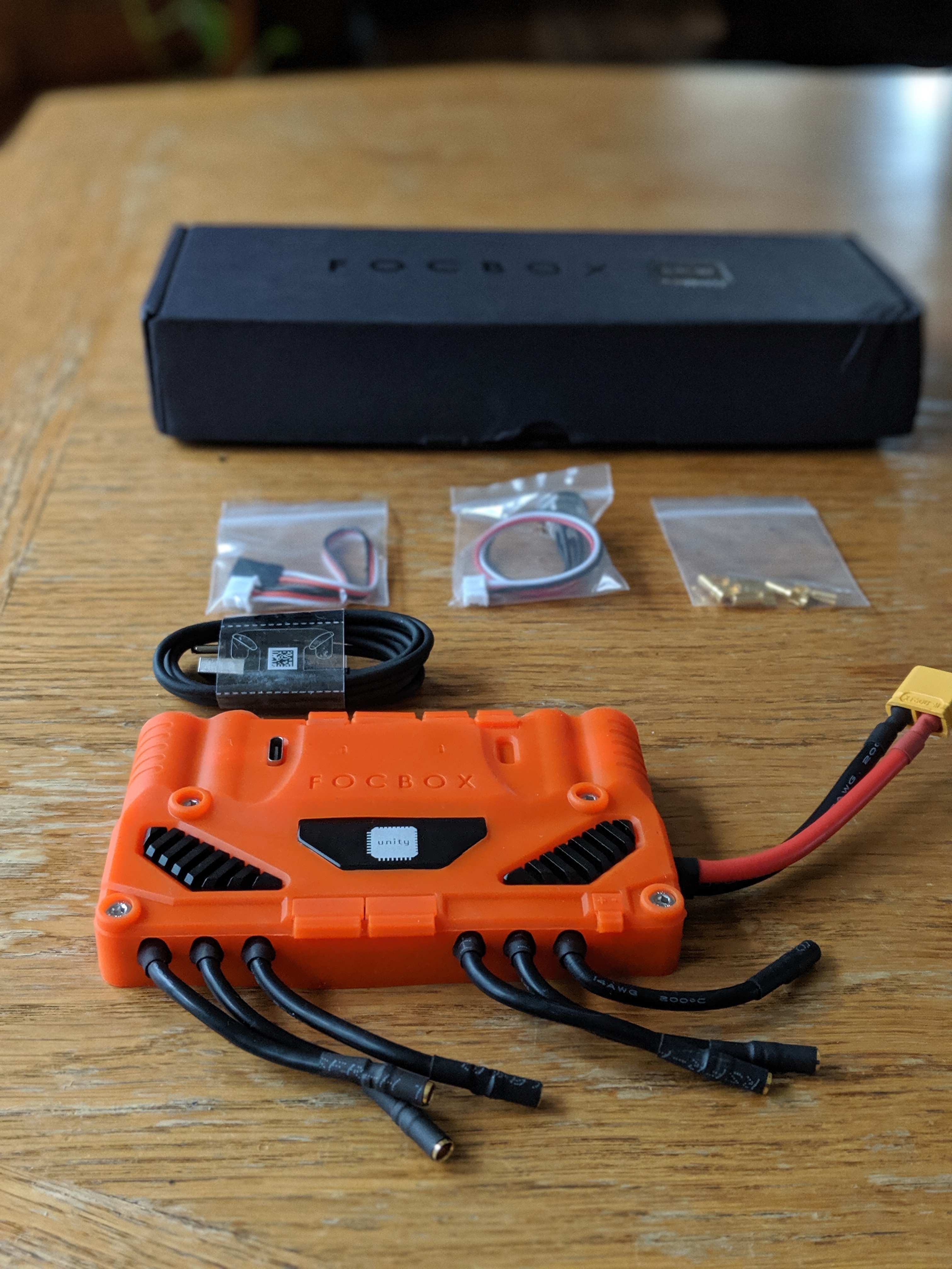

My unity also finally arrived so it got tied up in this build. Since this board was meant to be relatively stealthy, I figured this was a good option.

Since I’m using the unity, I can check battery level on my phone so no need for a battery meter either
