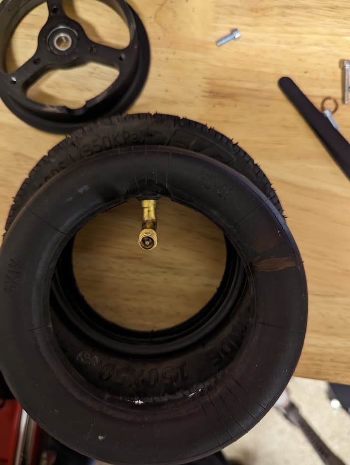

I have had probably half a dozen of these tires fail on me now (all V2 AFAIK) and I’m no stranger to punctures but the fact that I can’t go more than a week without getting a flat has gotten me a little skeptical that it isn’t just a normal road debris puncture.

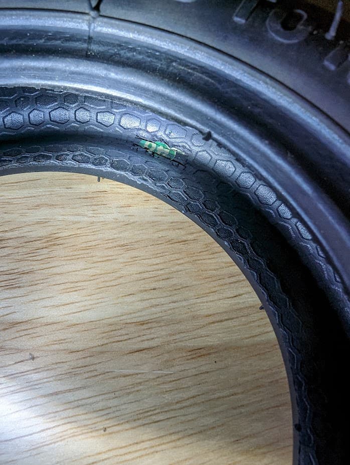

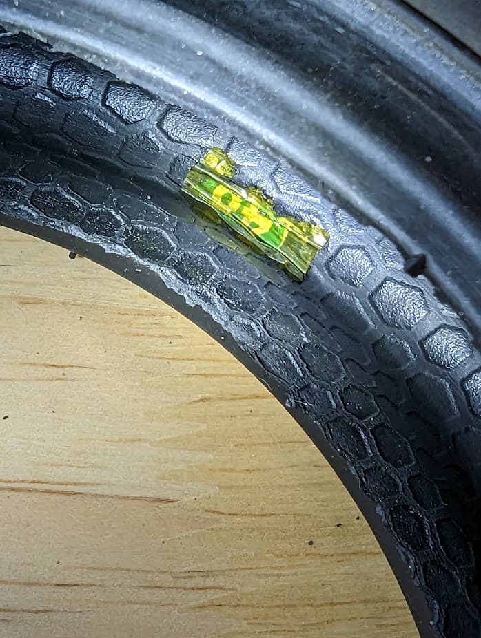

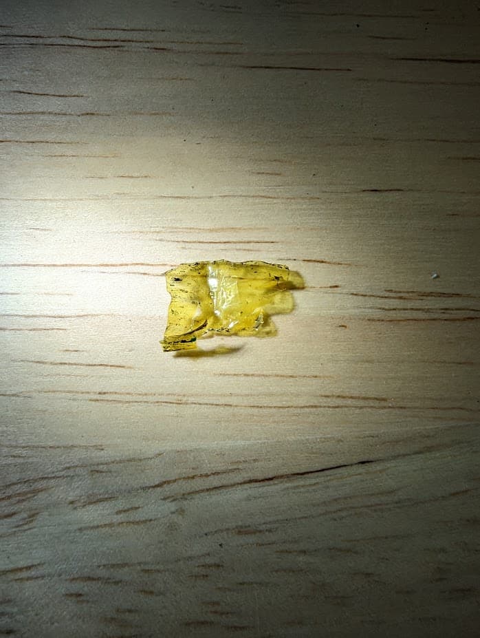

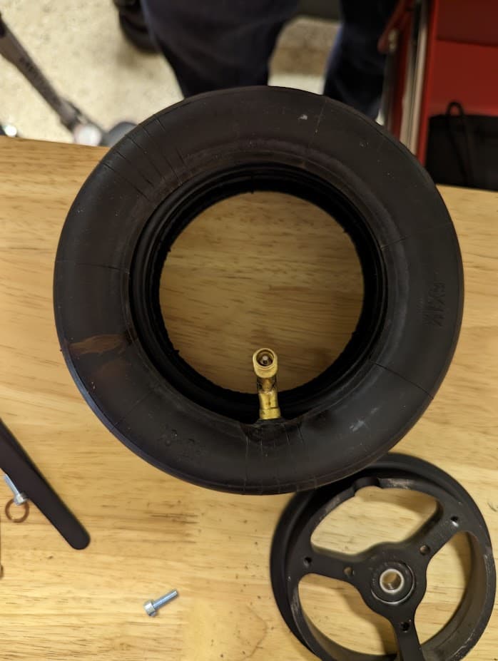

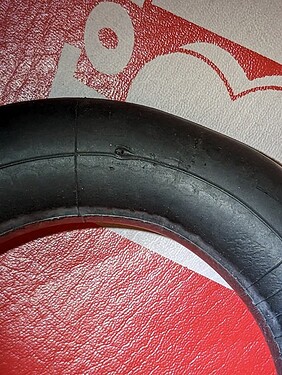

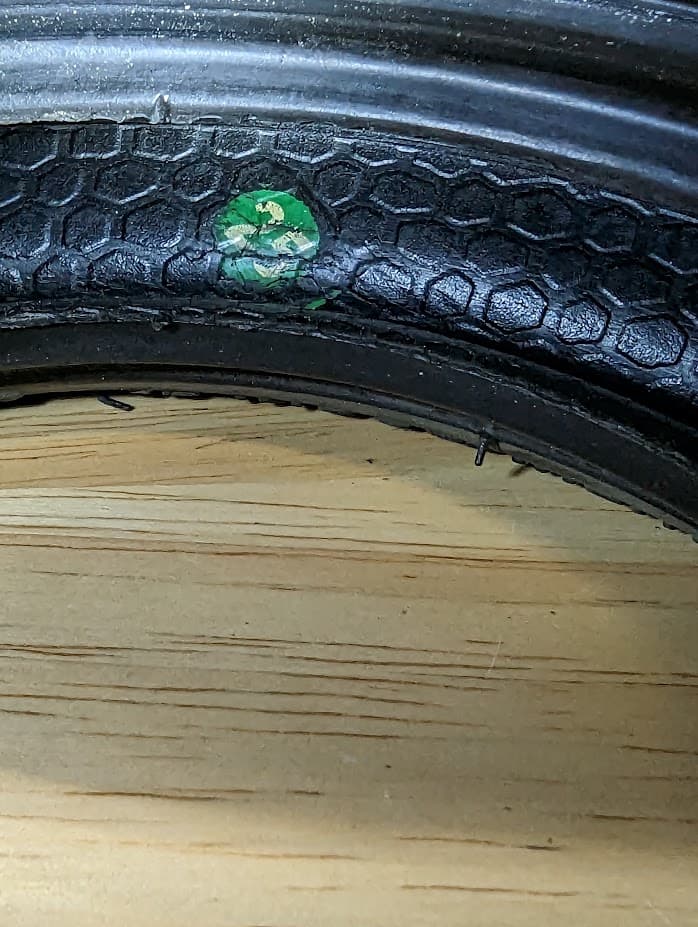

I took apart my last 3 tires/tubes that I have gotten flats on and tried to see if there was anything abnormal and there is something going on. There are these little numbered stickers with what looks like Kapton tape over the sticker so I took the tape off and then took the sticker off and there was a deep scoring mark on the tube, this was directly in line with where my puncture was. I took apart the other two wheels and sure enough, Kapton tape over a sticker covering a defect EXACTLY where my tire developed a puncture. Here are some photos I took of two of them I threw away all my other punctured tubes so I can’t check those but I feel like 3 is enough to conclude when it’s this obvious.

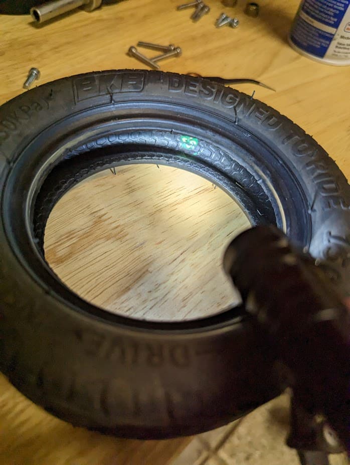

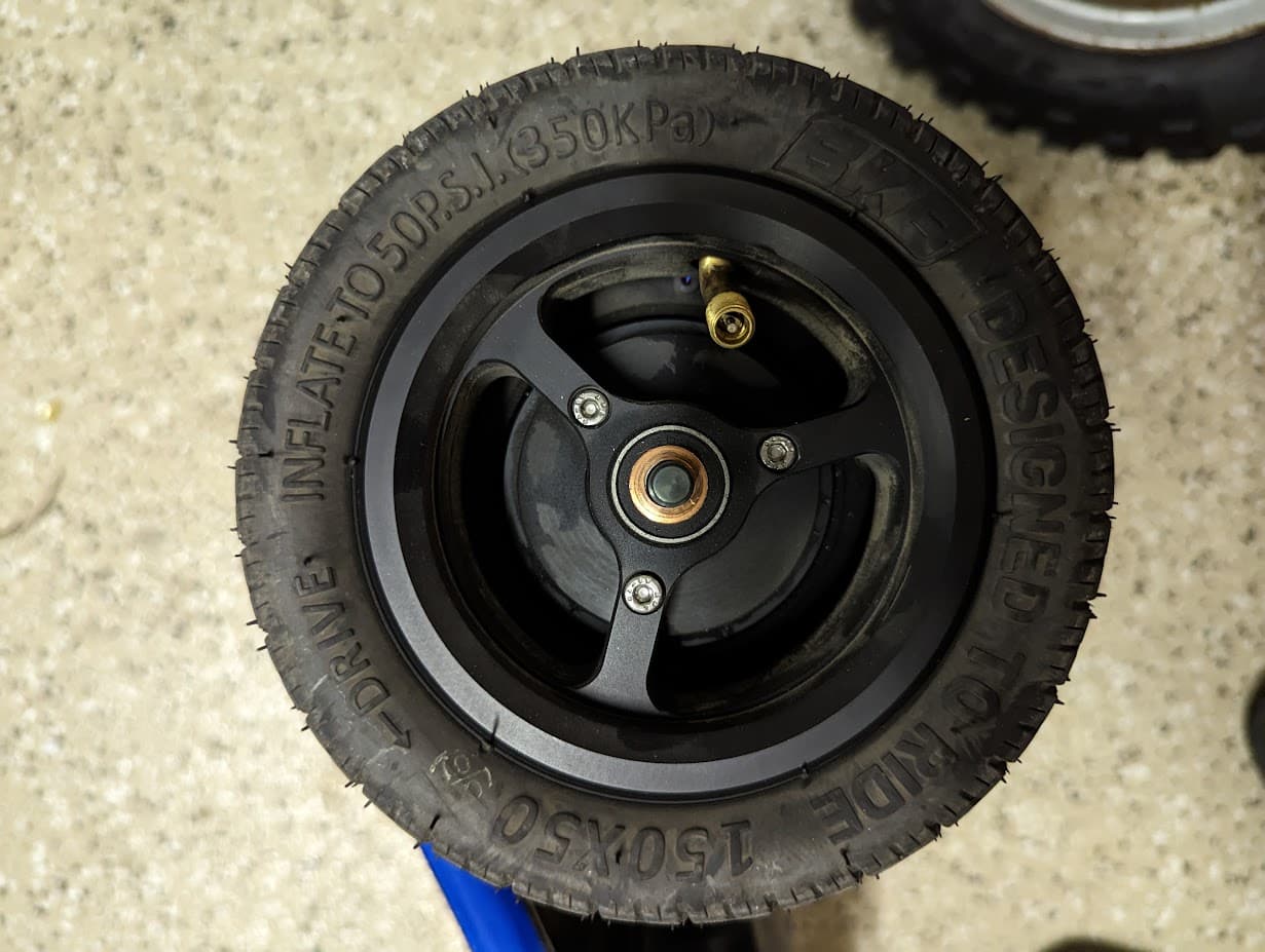

Here is a tire before I took it off so you can reference the valve stem placement in relation to the markings on the tube to line up the tears. I think this one had the same Kapton-looking tape on it, a piece fell out when I disassembled the wheel. I marked the spot on the tire with Sharpie but it’s kinda hard to see.

Yeah, I never noticed it until tonight when I took a close look at them, I was thinking they just use it to try and cover the rough spot to prevent this from happening.

I’ve run into this issue but with V1 tires. I kind of gave up on them. But it looks like maybe you need to take some fine sand paper to the inside of these tires.
