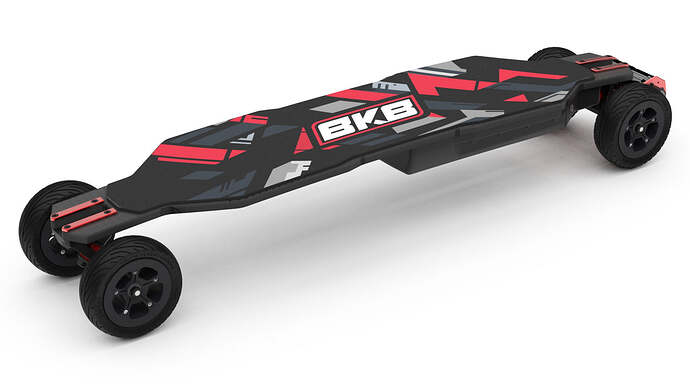

BKB Duo Type R?
At a $929 price point, this seems like an incredible deal. Has anyone done a DIY build of similar quality for cheaper?
Just wondering if anyone has experience with it.

Well, given the triangle of Price <-> Quality <-> Performance of which you can only pick 2, I think BKB’s lineup tends to optimize the performance and price categories. So you can definitely get a higher quality DIY build for cheaper, as long as you sacrifice on performance :upside_down_face:
Take for example my single motor hub-board, I’d much rather have it than the Duo:
Small board | Loaded Coyote | 12s1p | Unlimited hub motor
P.S. The regular Duo is 930$, the type R is 1380$
I got a buddy with the tayto kit swapped onto an omakase, and it’s all he ever rides, even though he has 2 other boards. I think bkb generally is decent value. You get what you pay for, it isn’t gonna be the same as a board twice the price. But, I’d buy bkb over pretty much any other prebuilts in it’s price range because it’s the most freely upgradeable. It essentially is a low end diy kit.
I completely oppose this opinion haha the duo is some of the best bang for the buck you can get
Type r goes fast and far, and it’s super flexible. I would never even want a single hub drive, ever. :joy::joy:
Also, in what way would the single drive be higher quality
For me, it would be pretty dang hard to meet the price point of the duo with a diy, and get the same performance
I think it’s because the BKB uses (or seems to use, I haven’t ridden one) fairly generic commodity deck, generic trucks, commodity motors from a brand I’ve never heard of, that kind of thing. They certainly use expensive stuff in places, the molicel batteries are v good and the xenith perfectly acceptable, but in general having Rusins’ loaded deck, Boardnamics trucks, caguama wheels, and name brand motor is what is meant by quality I think
And yup, also in agreement here, but this is what was meant by “they picked price and performance”. Speed, range, acceleration, those performance metrics are pretty hard to beat with DIY. But quality of life stuff like above is the tradeoff
Seeing as a 12s5p P42a goes for $700-800, a Xenith is $300, and then you are getting a deck, enclosure, remote, drivetrain for an extra 3-400… The duo Type R is a steal
