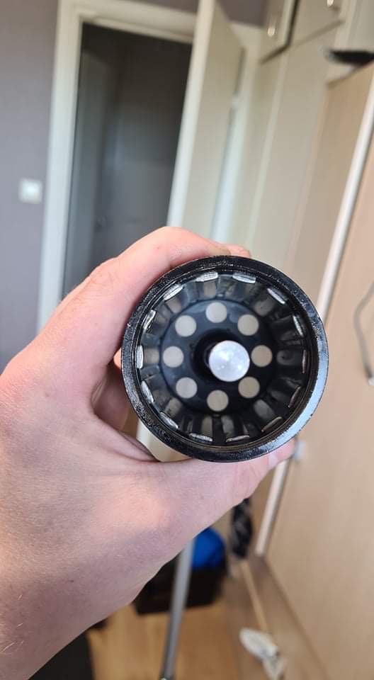

I broke the magnets in my Saite 63100 after more than 1500km, I am in need of beefy/reliable/not heating up so fast motors, and @mackann, your motors is ticking all my needs.

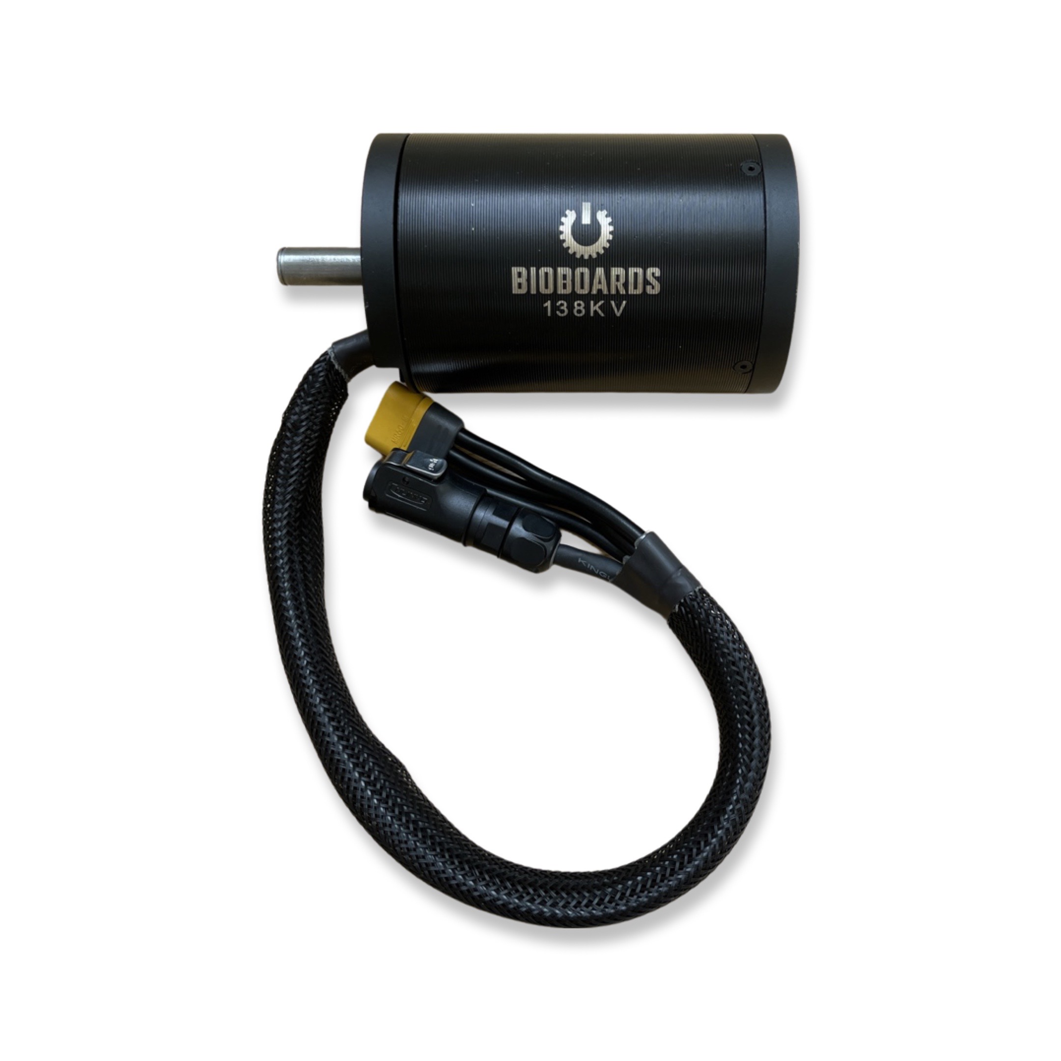

After several batches of test them to make them perfect they are finnaly ready.
Only a few available to order here:
Will ship in 15-30 days

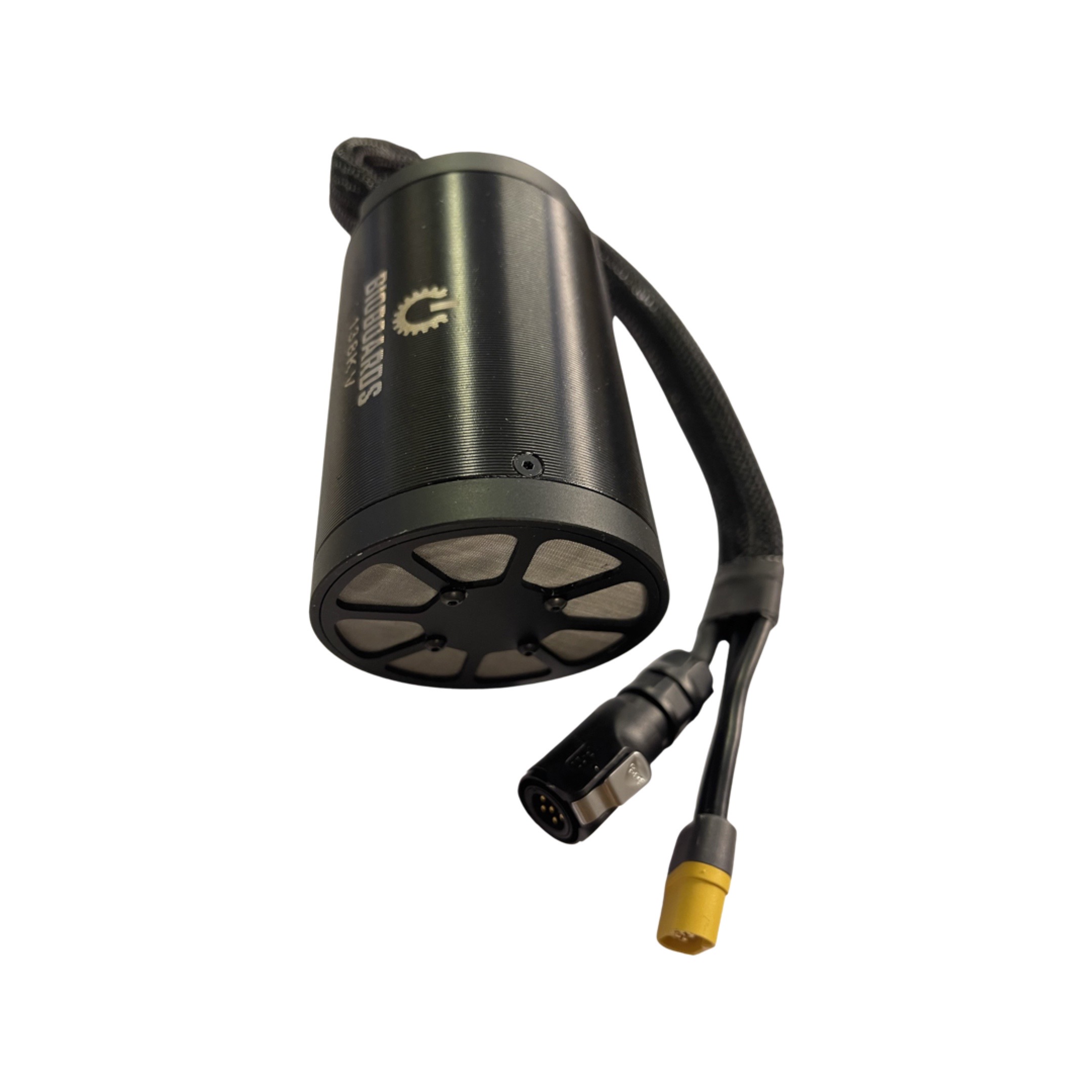

Wow those are some beefy motors. Talk about battle hardened!
quick! before @b264 buys up the entire stock ;p
Does encasing the field windings like that result in a trade off between robustness and thermals?
Except the only thing that ever broke on the original version was the big end bearing and that’s not really been addressed here.
In my experience, not really.

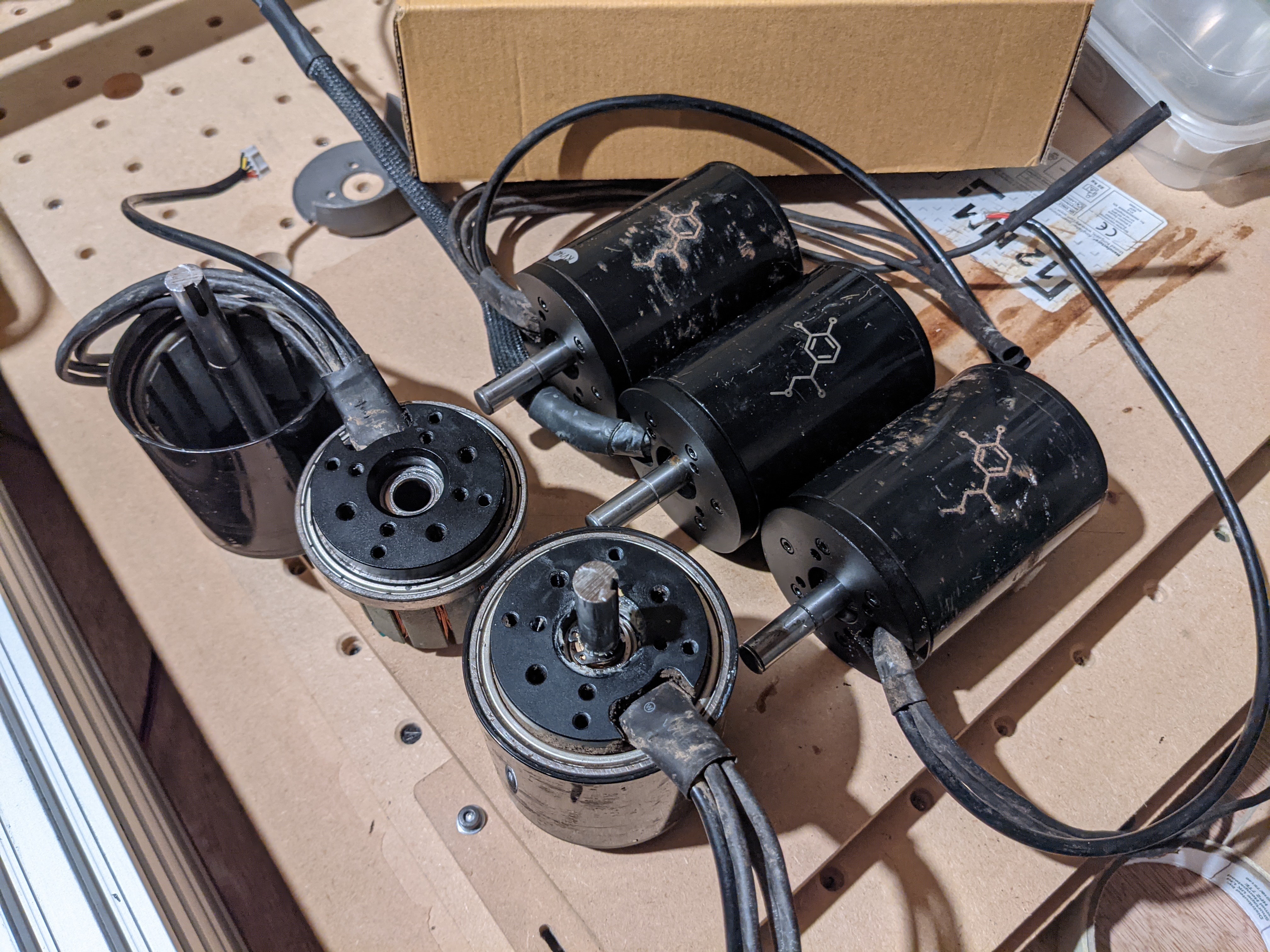

Dis my pile of deads.
Overheat?
Damage to magnets?
Sensor failure?
Nope, every single one died of bearing failure long before anything else broke.
I have yet to be able to fix one.
They can, can’t say how I know, but I’ve taking apart and putting together a similar motor at least 20 times in the past weeks
The big bearing is press fit on the motor body, and with a slight tight fit on the can
Pretty easy to open the motor, but you need to make a jig with a lever, just pulling the can will get you nowhere
To take the bearing out, you need a bearing puller (that thing with 3 claws that you turn a threaded rod to pull the bearing out, forgot the right name in English)
To put a bearing in, as a old teacher of mine you say, you need a lot of faith. Just kidding, but ideally you need a press with an purpose made adapter to press it in, and another adapter so you don’t put any force on the windings.
The janky way I’ve been doing since it’s my own motors and won’t go to a customer is using another spare bearing and a piece of wood to really carefully and slowly hammer them in, as soft blow of the hammer as possible, and going all around the circumference
Once I got the right-ish puller tool, swapping out that bearing was a doddle.
[Edit] Fwiw, the image does look like it uses a higher quality sealed bearing than Maytech normally carries.
