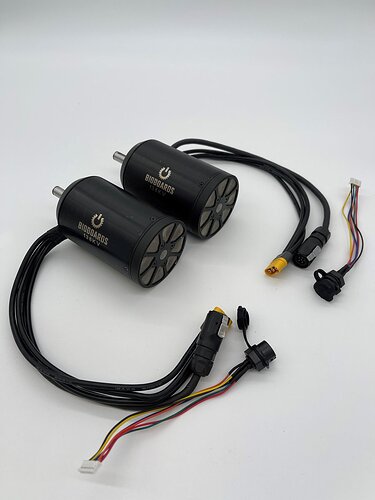

Bioboards 65100 motor - finally time for a very powerful and durable motor
Do you want a powerful and high quality motor made for esk8?
Now you finally could!
Bioboards 65100 motor available in 138KV and 205KV:
Fully battlehardened:

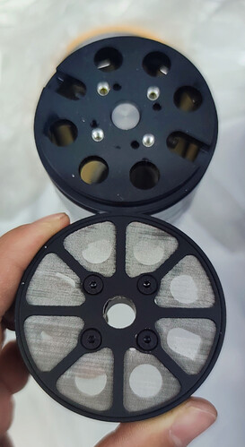

Open design for low temps but a mesh design that protect them from dirt and stones. The mesh is easy to remove to clean or replace:

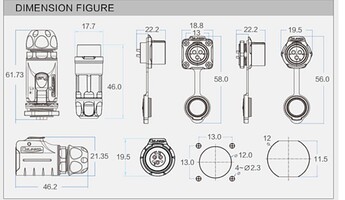

MR60 and waterproof sensor connector, the vesc side of connector with jst to vesc is included!
The can is 2,5mm thick so no more deformed motor can from gravel hit it! Thats why its 65 size and not 63, its still 63 hole pattern.
65100 vs 6374:

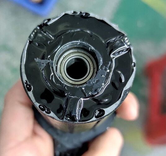

High quality press fitted bearings!

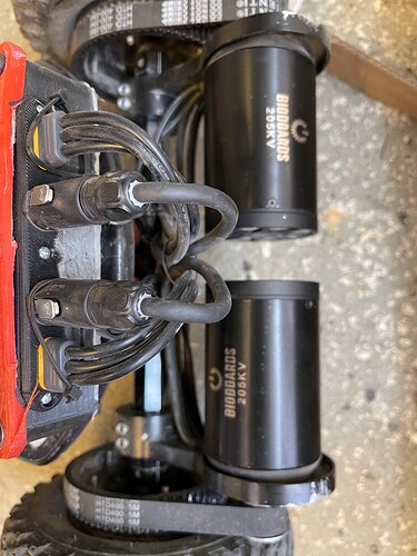

Curved magnets for high efficiency, this is with 9" AT tyres and belt drive:
Avg speed 38 km/h and only 25 wh/km with 100 motor A on dual drive.
First impression from a AT rider that normally ride 8085 motor “wow they feel alot stronger and better and runs with lower temp”

  • Sensor connection: Water resistent with spring lock and included female to Jst-ph 6pin (no vesc adapter needed)

  • Protection: Open design for low tempatures and high performance but mesh protection for better resistance stones, dust and dirt

  • 3 NKS bearings press fitted
  • Shaft with excellent retention via a small rounded key

Those are some major beefcakes. What’s the diameter of that sensor connector? Looks quite large
Is there a support bearing for the can? (Like on maytech 6880 and 6396) Just wondering if those 2 grub screws are the only thing holding it…
Also, Isn’t MR60 a bit too small of a connector for people running these at above 100A ?
Yeah, how would these hold up to helical drives

MT60 works fine, i dont think anyone on a esk8 run that high A continues. But its easy to solder your own if you prefer bigger.
