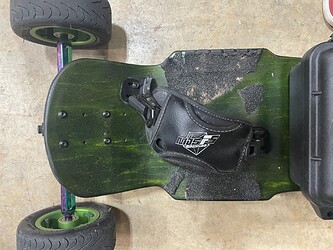

Reviving @Fosterqc’s thread to get more input specifically on how to adjust bindings for the ideal fit. Specifically:
  • How did you choose which set of binding mounting holes to use?
    For example, on the 2021 Bro : image
  • Is it intended to choose a matched set of holes, i.e. outer two pairs (“wide stance”) or inner two (“narrow stance”)? Or do you adjust this for shoe width (one red set + one green set = wide shoe)
  • How hard do you tighten the toe strap onto your shoe? Enough to easily twist and remove? Snowboard style aka as tight as possible?
  • What does the ideal fit look/feel like for off-road / jumps / tricks to keep you steady and mounted to your board?

The way a binding is supposed to work is you can slide your foot in at an angle and it will naturally stop when the lace pad makes contact with the underside of the binding, then you rotate your toes inwards until the sides of your foot are in contact with the binding posts, its the posts that actually give you support and grip (the strap just gives turning leverage and some safety when you loose downforce)
You pick the stance that feels most natural for you, your feet should be a little past shoulder width apart and toes slightly splayed outwards if you got it right, I’d recommend lining up using the middle hole on the binding posts so you can adjust a little more once you’ve got your deck holes picked out (boots need more space than shoes)
I use the outermost sets of holes like in your red drawing because I love a good wide stance.
Next up is foot direction. I keep my front foot almost perpendicular to the way the board rolls (neutral) so I use the mbs foot strap holes in the alignment like this
Rear foot likes to go a bit forward (posi) with speed so I angle that one a bit in that favor like this
So my overall stance is like this in the end
I keep my rear binding looser than my front by one click because I pivot that one around more than the front. Both feet can still step out of the toe straps though when riding. I mostly just use them to grab with the top of my feet on heel side turns.

I concur with all the previous comments. One good exercise is to stand on the board with your most comfortable stance, then place the bindings on your feet to see which holes work best for your natural stance. As mentioned above the “posts” should be pressed hard up against your feet in that stance because that is how you want it when riding. You then twist your foot to get in/out. As in your photo I recommend using the toe-side holes closest to the toe side edge because that makes it easiest to get in/out. The other ones are for a more “locked in” feel.
