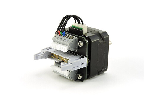

  4. Wire management and swapping out components is going to be very easy with Agnius’s setup.
    image by @Agniusm
placeholder
@Agniusm, what crimp( you have brown, red, gree, blue) do you recommend for the wires before putting them into the quick disconnect coupling ( is there a better name?)
EDIT: I found it. You mentioned ferrules. I am guessing the advantage of using ferrules is that it lets you remove parts more frequently without worrying about wires getting chewed up by the quick disconnect connector?
