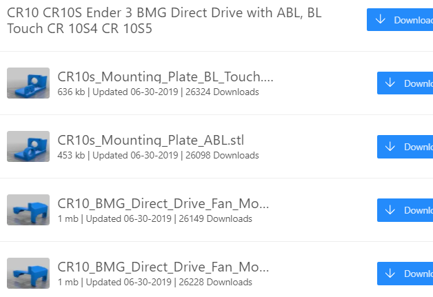

Doesn’t that file have a bltouch bracket version?
It does, but I’d need to buy a bltouch, somehow print it with my fucked printer, and I’d still need to adjust my X-min so that the sensor won’t go off the print bed :sweat_smile:
