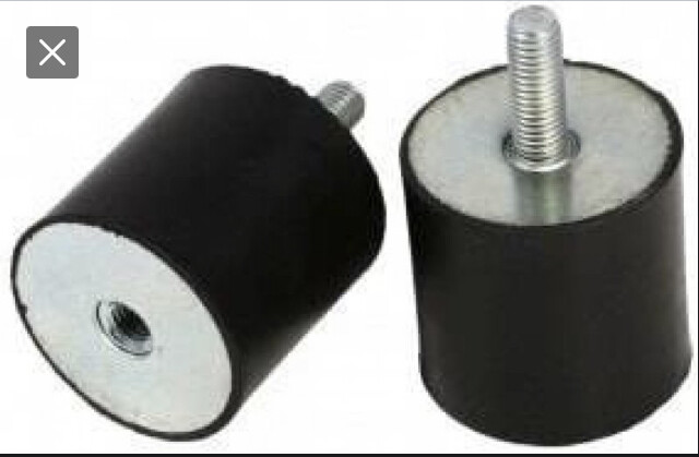

Use silentblocks type B or type C.

They look awesome!! Do they come as a double female? My only concern would be that they might be difficult to undo without access to both sides of it
I’ve had a bad experience with those rubber threaded blocks. Wouldn’t recommend when you’re planning on doing occasional jumps and hard riding.
After that, I changed the mounting to inserts in the box and bolting it to the board with bushings in between.
On another board I’ve mounted the box with velcro and it’s been great too. (Just be sure to get the original velcro brand)

Yes . Double females is type C
Hi Bro. It looks that You have a Trampa deck and so heavy metal battery box. Fit that setup You need just 3 silentblocks with diameter min. 35mm just in the middle like original Trampa or Haero layout. Just must check specs of silent blocks producer to be able choose correctly robust solution. My friend used it like I said and no issues till now also on Trampa and metal box with 12s6p. For decks like MBS or Apex/Haero You can choose square layout (smaller square is better, and do it like AxA not AxB) but for Trampa You must use it just 3 in center line and bigger diameter and height . Minimum 35 diameter x20 high. Also Your actual solution it not look like perfect, it will jammed box or threads. Move it to centerline because of flex .
