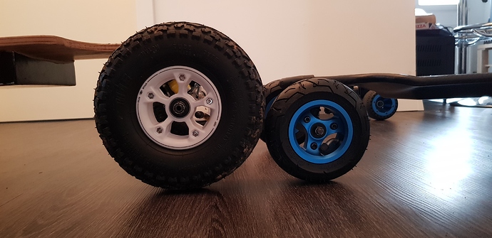

Also I switched to 9" but only had 2 rides so far. It’s a bit less agile but makes quite a difference offroad :ok_hand:.
9" vs. 8" :laughing:
9" vs. 7" :joy:

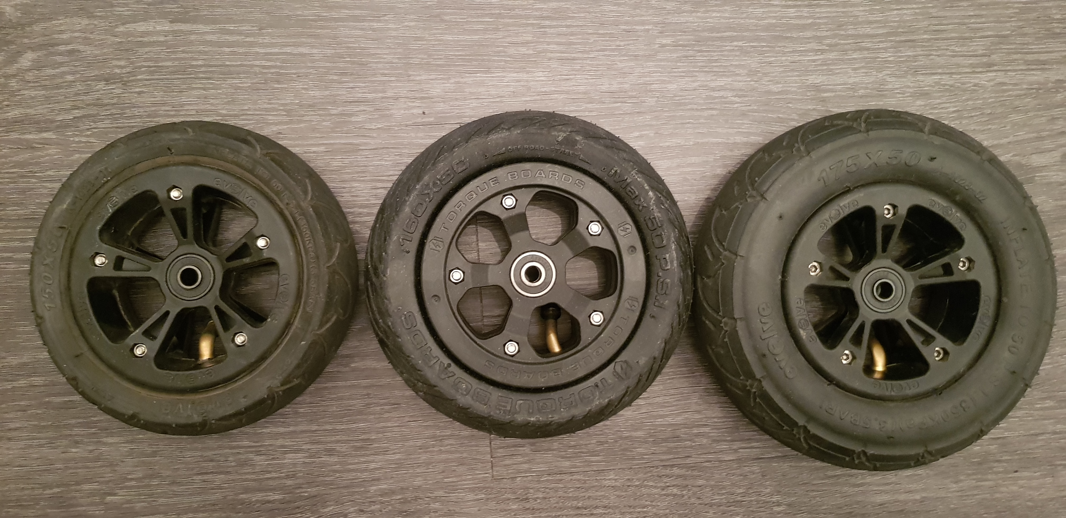

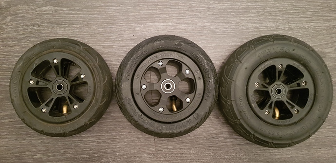

I need your help. Could you post a picture of the Evolve and Torqueboard hubs side by side? i’d really appreciate it :slight_smile: it might also be helpful to others who are planning a build

So, definitively, will 6" evolve tires fit on mbs hubs?
Evolve 71mm, TB 68mm, MBS 75mm.
Outer diameter TB 104mm, MBS 105mm, Evolve 106mm.
