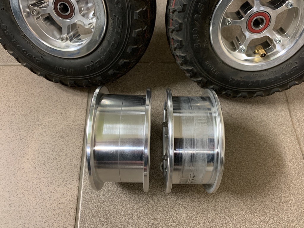

These tires do not fit my 9" hubs because of width. Inner width of the tire must be at least 50mm. The only viable drive is a gear drive because of tire being 80mm, so that it goes inside by at least 15mm, hitting any other drive. I had to redesign the gear drive and wheels for them. Wheel bolts became M5.

The 9" Megastar deep dish should work. One concern would be foot bite though. They look massive. We have a longer deck in production to address either wider stance or bigger tires.
So on what hubs are you using them?
I’d figure he just CNC’ed something custom.
Ok, but like Frank said they will fit the Megastars and they also should fit the Fivestars. You might relocate the motor mount to fit them though.
New rims on the left, old (9") rims on the right

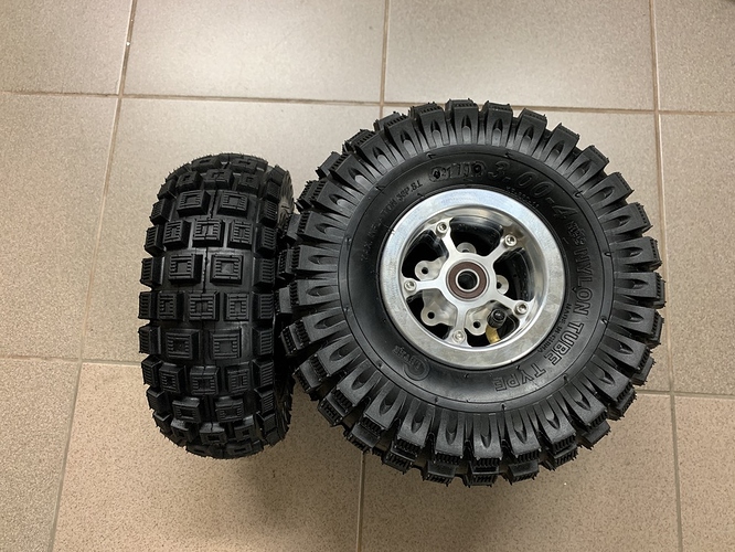

@3DServisas I run your 9“ hubs on 10“ tires without issues. Not the same model of tire but they are as well 80mm wide. Also no problems with chain drive. Just Important that motor mounts sit on the right position on the hanger.
As i have a fixed distance due to the crossbar I used etoxx truck extensions to get the right distance.
Yeah, no reason you couldn’t fit a super wide tire on narrower hubs (unless you can’t physically get the hubs to meet), the sidewall bulge is just going to be silly which could get in the way of your drive system and you won’t get a flat contact patch. These 80mm+ wide tires fit great on these 70mm hubs I picked up, just have to get a chain gear on them.
In my case everything is holding solid without any adapters or extensions. The trucks are solid-core and designed to be longer by 15mm. Hubs have exact mounting for the gear drives so I don’t need any standoffs that also compromise the overall stability of the system. :grinning:
That’s the advantage if you can just fabricate your own parts and make them fit your needs :+1::sweat_smile:
