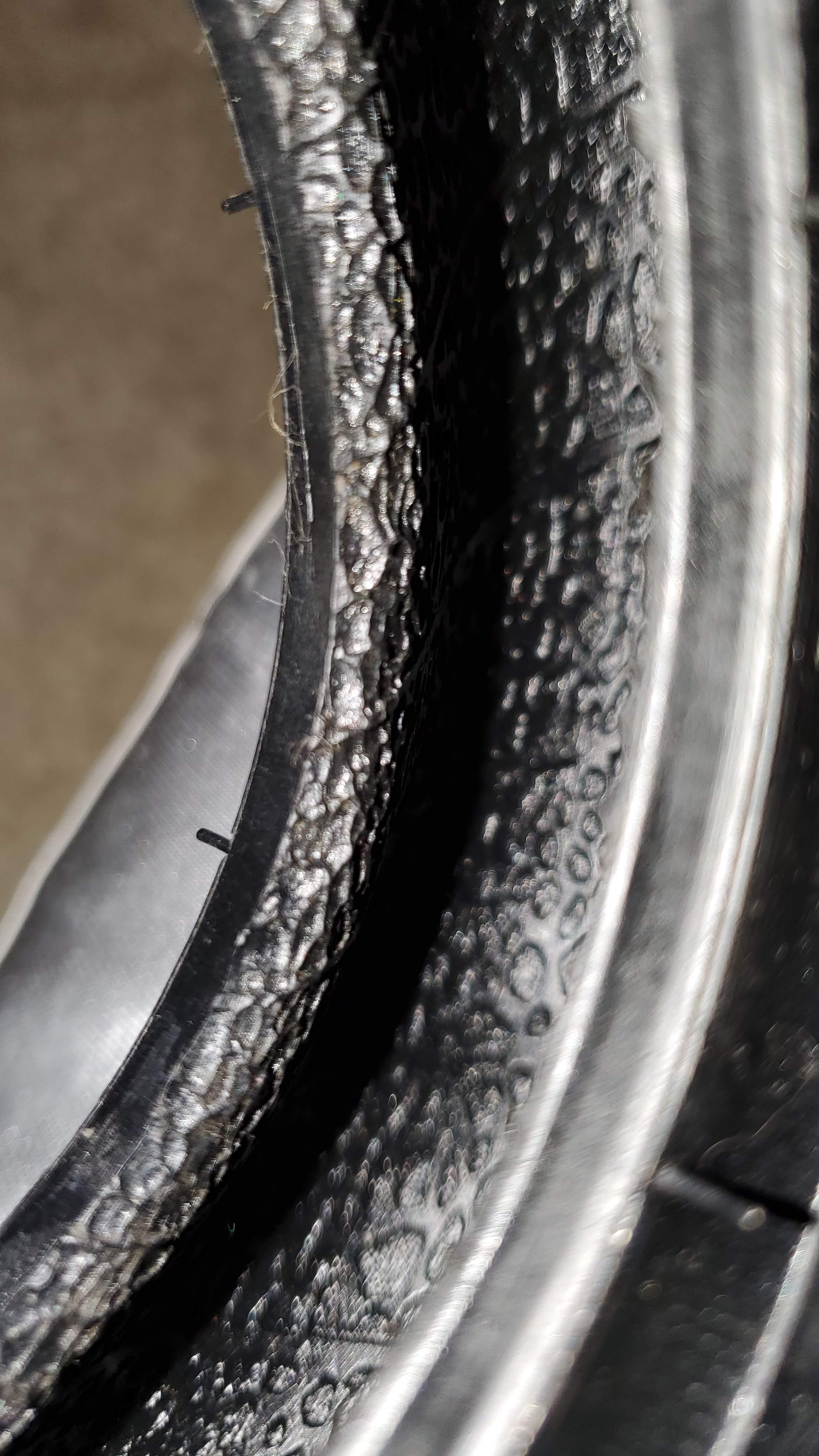

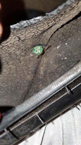

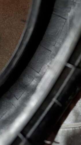

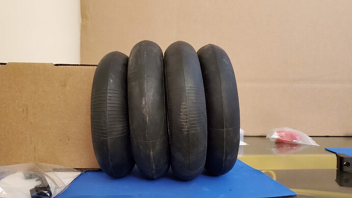

I ordered a set of 9" tires from Ali and they were WHACK
Tubes inflated to the same psi
Difference in inside tire finish
One had the lining wall visible via a hole
All of the beads were cut by a drunken toddler too. I had to clean up every single one.
Ymmv

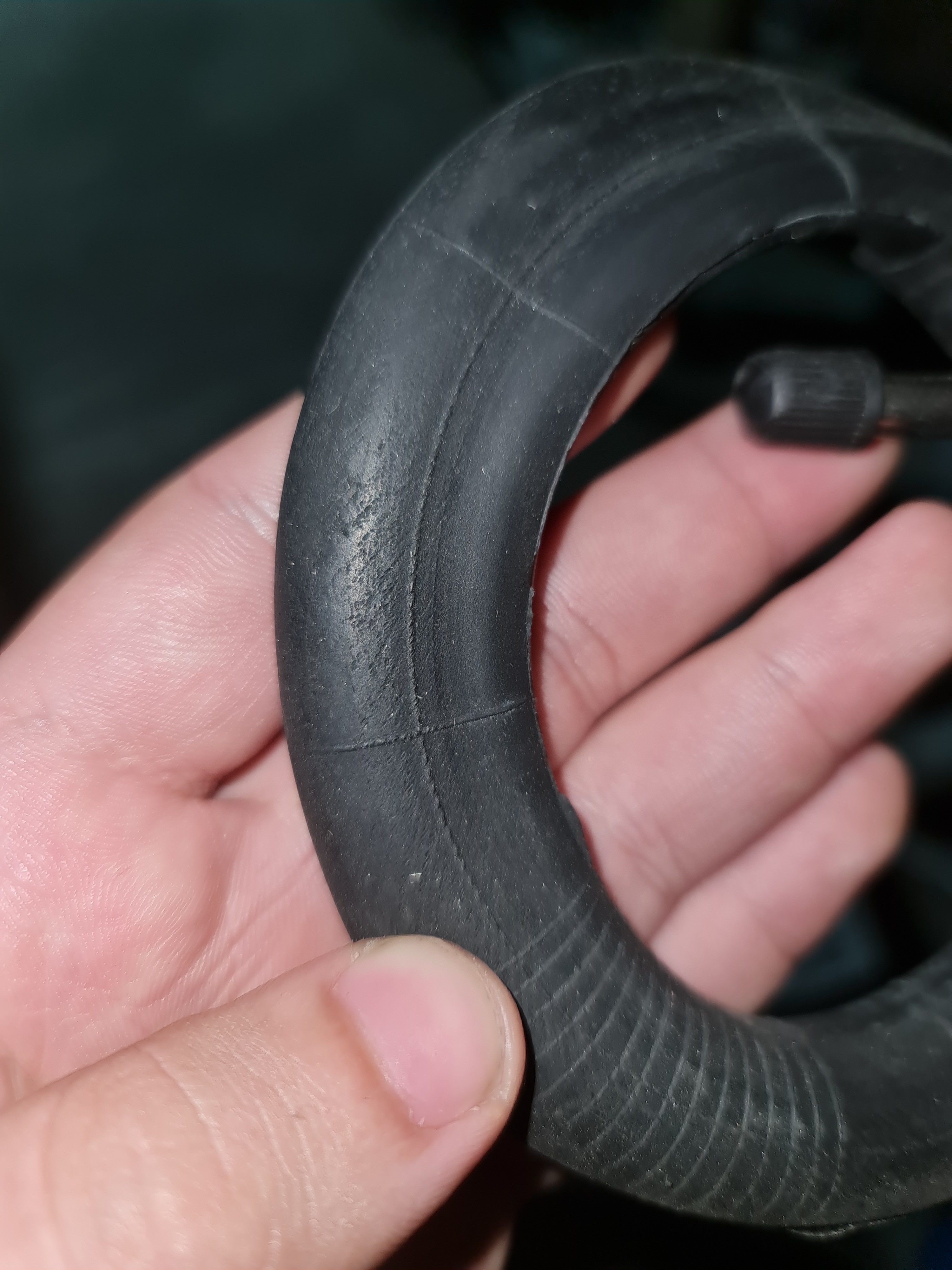

The coarse one will eat inner tubes for breakfast
I call him crocotire.
But no worry friend, it will ride fine when installed I was told.
For 50km
Then your tube will misteriously pop and you’ll replace it.
50km later, same thing.
Repeat until you spend more on tubes than on some decent tyres
Even bergs are slightly guilty of this, even though they are smooth, they naturally crease on the sides by design
Yep, this was exactly where majority of my flats occurred. Washing the tubes with soap and water helped a bit but ultimately the 6x2 aliexpress tires and tubes have been the ticket.
