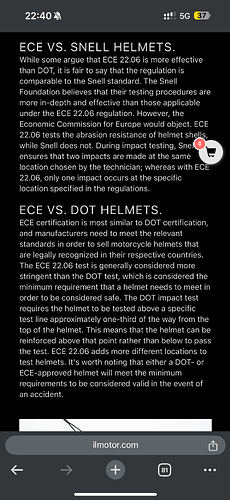

looking at snell vs ece comparisons,
i’ve heard that mips can be mimicked by simply wearing a durag or hair wave cap under your helmet but idk how true it is tho.
after looking at snell vs ece, snell might be better than ece for numerous impacts to the same spot but idk. i know ece is good so imma stick with it.
ECE is rated for both low speed and high speed impact, also rotational force too. For regular use I would say ECE all the way, SNELL is good but it’s more of a track certification.
