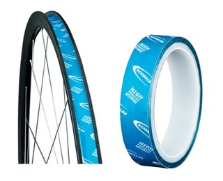

Try liner like they do with bicycles or gorilla tapeimage
