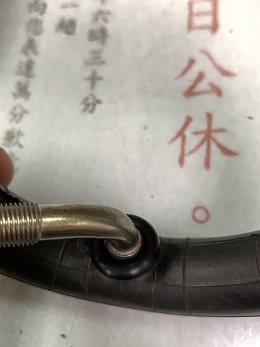

It seems that we are to blame for some of these flats. It turns out that our Bergmeister design is not optimal in that a sharp edge can occur around the inner tube’s valve stem. That can happen if both rim halves are not perfectly matched (when screwed together).
For the next production batch we will slightly modify the design, so as to avoid this issue altogether.
The good news is: there is a VERY SIMPLE solution for all of you, that are currently riding the Bergmeisters. You will no longer experience any accidental punctures around the valve stem by using a silicon o-ring. We have tested it and it works very well (See picture below).

We bought in bulk the following silicone ring:
Inner diameter: between 8.0-8.5mm
Outer diameter: 16mm
Thickness: 4mm
I would assume that any type of mid-soft o-ring would do the trick as long as it covers the valve stem.
