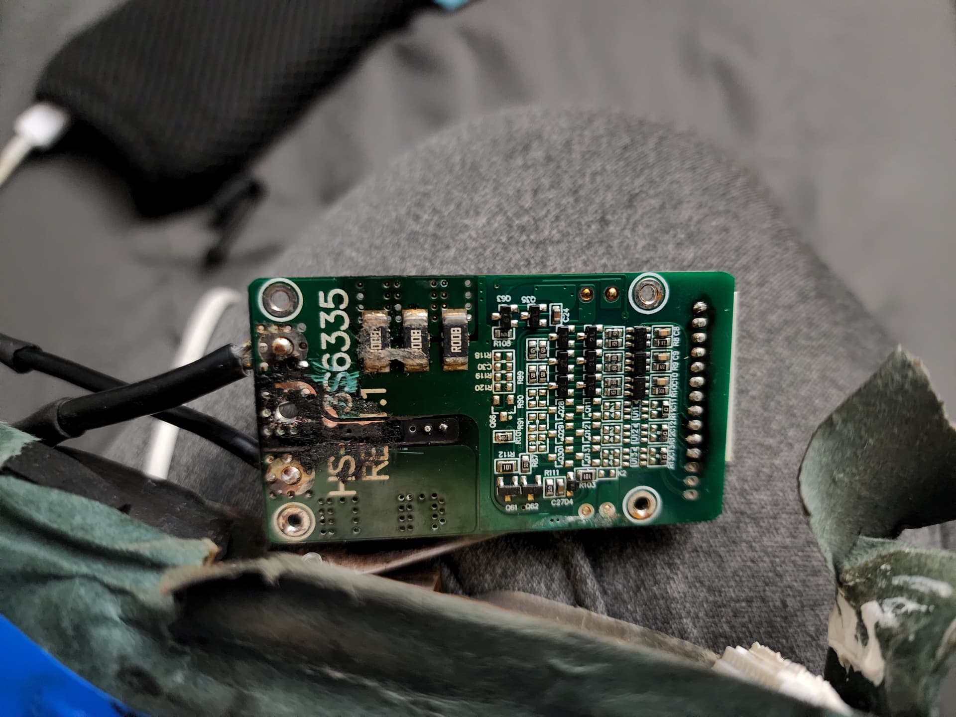

So I have a 10s3p pack from my BKB duo that needs a new BMS. Does anyone know what BMS is used or have any suggestions on what BMS I should pick up?
Do you know if it’s wired bypass or discharge?
LLT BMS or Daly

if u must monitor pgroup voltage, then LLT, if not, Daly is good enough

I can’t tell but I believe discharge is by passed. The PCB on the original is burnt so I can’t read the labels.
Does the amp rating not matter on the bms if I’m bypassing discharge?

It actually looks like it was wired for discharge through the BMS but it’s hard to tell bc of thr burt pcb. In any case, if you wire for charge only and bypass the bms for discharge, the amp rating does not matter. You still need to pay attn to the charge rating though to make sure you don’t exceed that.
And WTF happened to your bms bro?
