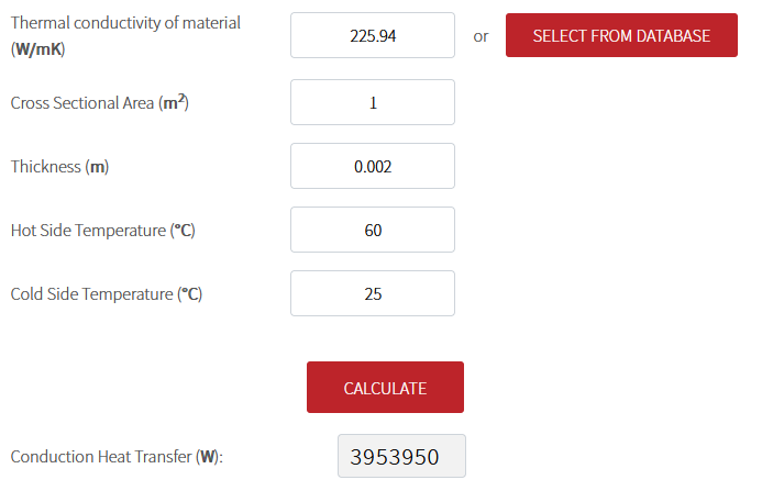

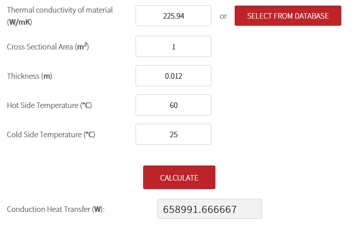

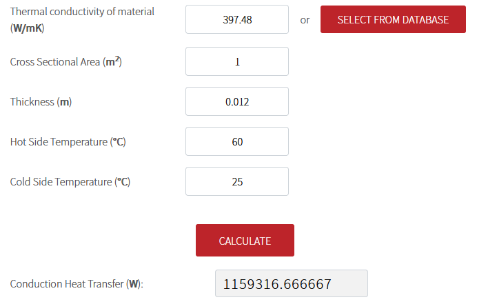

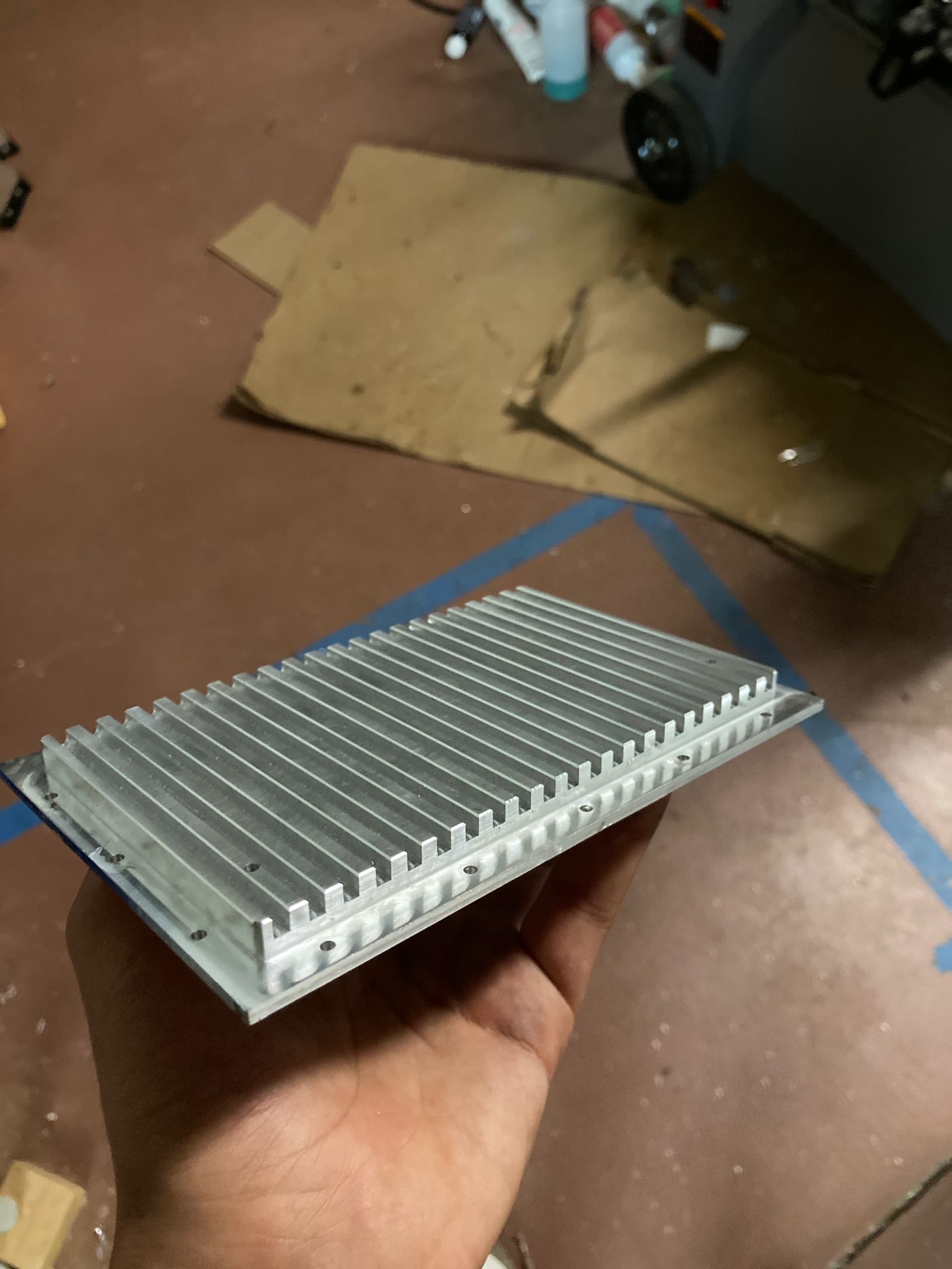

the bigger the mass (volume), the more heat it can absorb before saturating. the more surface area exposed to air the better performance of said heatsink. there is a balance u need to consider, not just slap the biggest chunk of metal on it and call it a day.
if the air exposed area is same for both heatsinks and they are made of same material, then the one with more volume should have better performance.
but there is also thermal conduction that u need to consider, as different material transfer heat differently, for example:
aluminium
vs
copper
and compare to a even thinner aluminium
u can play around with these number on here with bunch of different material to select:

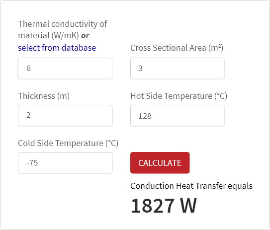

This isn’t really correct.

That’s a good point unfortunately I don’t have copper on hand atm

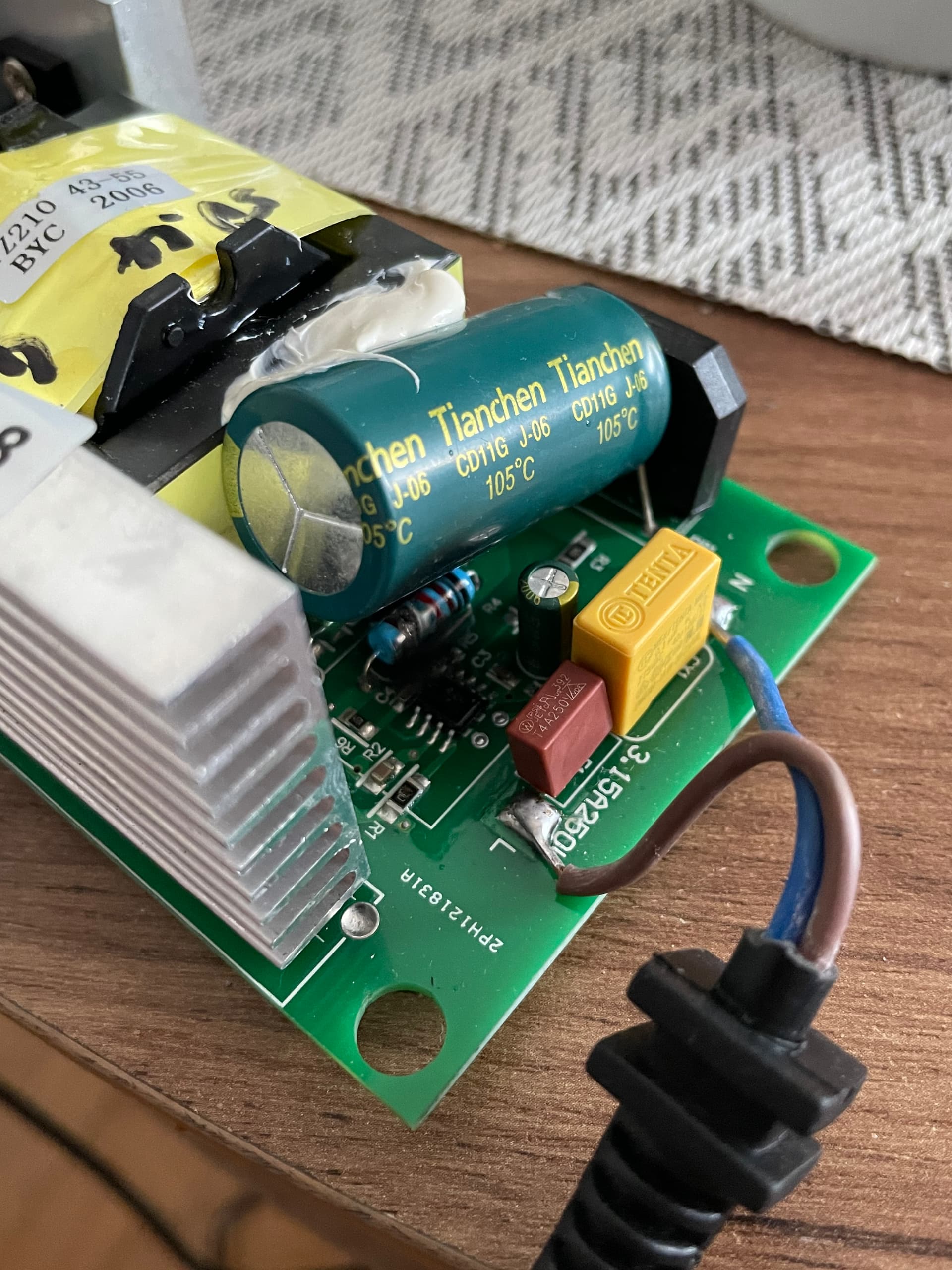

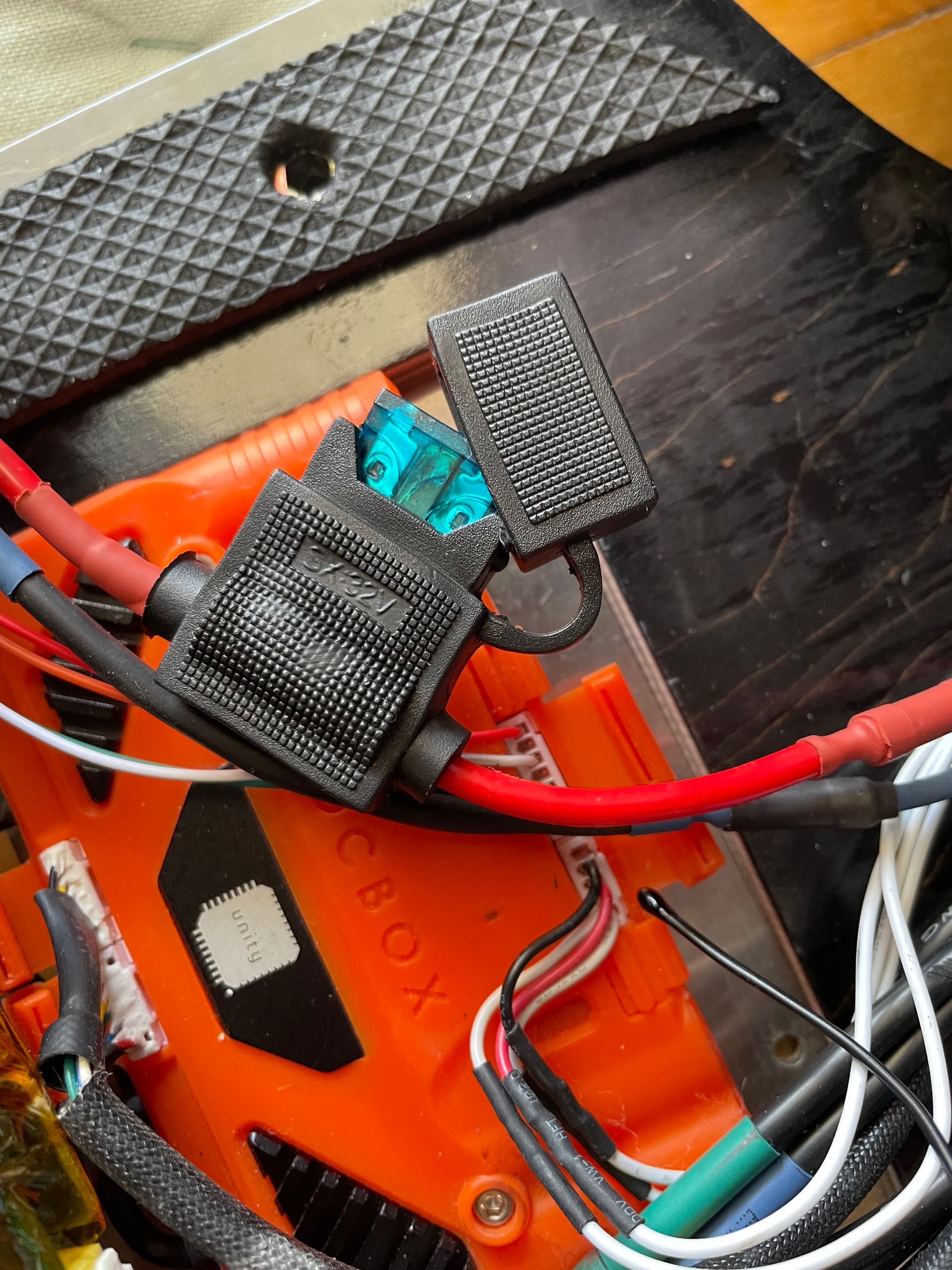

So, I’ve just blown my charger… :rage:
I just plugged it in (wall first, then board), it sparked near the charge port and now is dead!
The only thing that was different in my board was an inline fuse holder with a 15A fuse, I installed yesterday
As you can see the fuse popped and saved(?) the rest, but the charger is toasted
My question is, what went wrong? Is it that the fuse holder is rated at 32V? Should I just throw it away and just solder a fuse there? Should I just go back to fuse-less (it was working fine for 3 months now)
I never fuse my charge port. Just try not to stick stupid shit in there
Or use a female charge port. Or something like TrueConn/PowerConn that’s short-proof

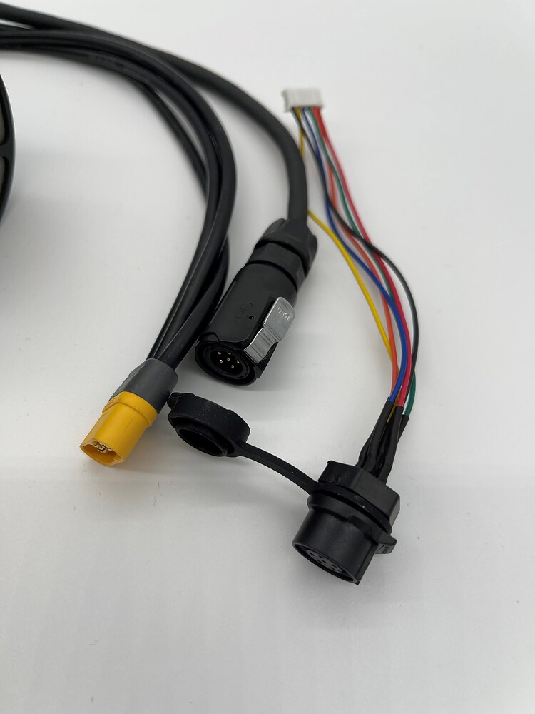

Is there any news on a good panel mounted plug for connecting sensor wires to the enclosure?
(Doesn’t come loose, break, waterproof?)
I know that is one thing that I really used to search forever.
Like these? Though a bit bulky. I think the majority used a grommet like plug to just feed them through.
The smallest ones i have found are gx12, but they’re not exactly awesome.
Even different aluminium alloy would yield different result on thermal transfer.
But to be real here, I think any heatsink would work relatively well in our use case, the chance of anyone ( regular people, not racing board, most of them don’t use vesc anyway) can heat up enough to saturate the heatsink is very silm. And if u really saturated a heatsink, u kinda doing it wrong

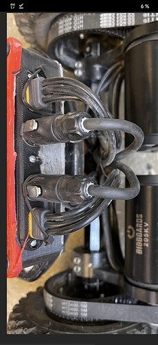

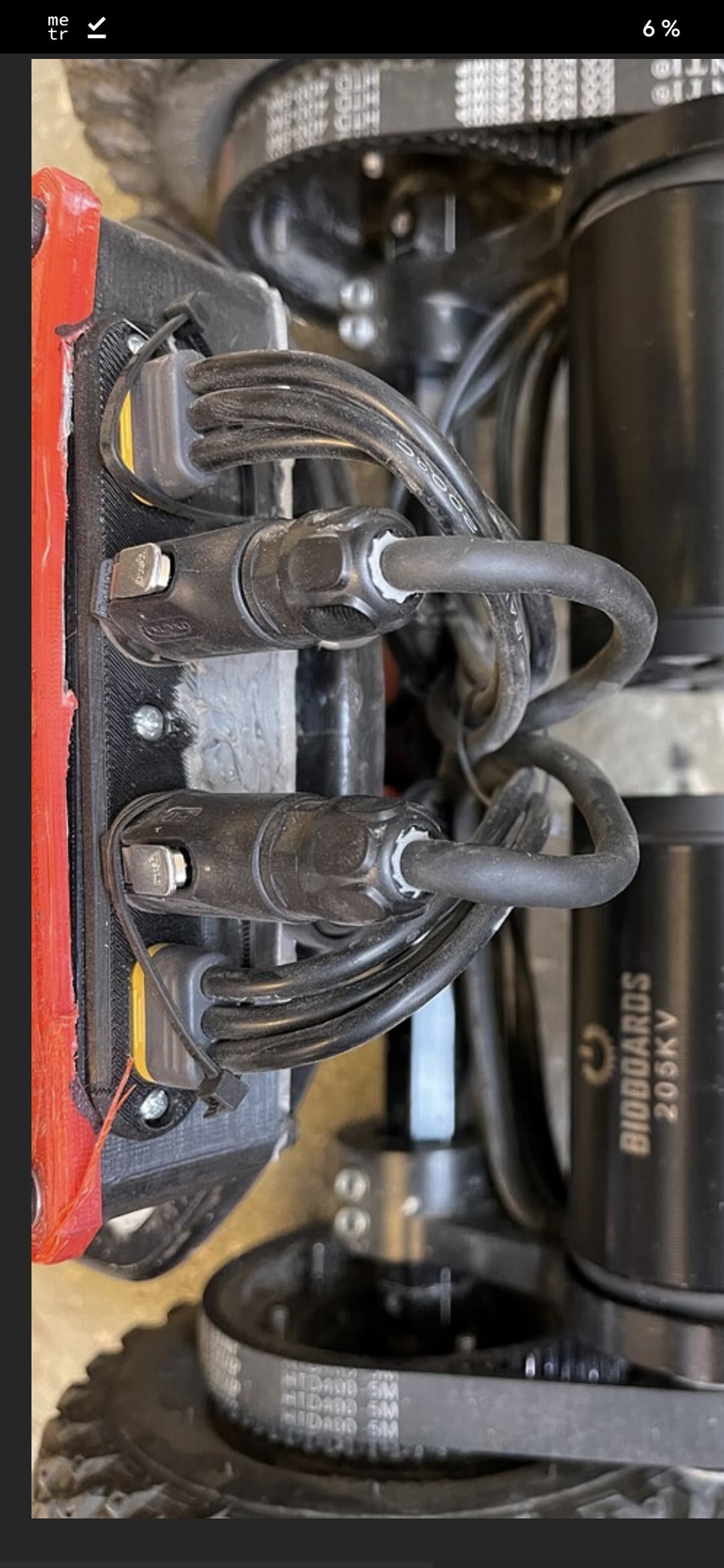

I have a even smaller one for sensor
Talk to me
Are you sure the polarity was correct? This sounds a lot like the + and - being backwards on the charge port.
These “M8” 6 pin connectors are a little smaller :smiley:
Why does strain relief gotta be so long!? :sweat_smile:
Wow these look awesome if you have enough space.
I used to feed the cable through a rubber grommet but I hated having my motors or esc stuck to the enclosure. Made opening and modifying a pain.
