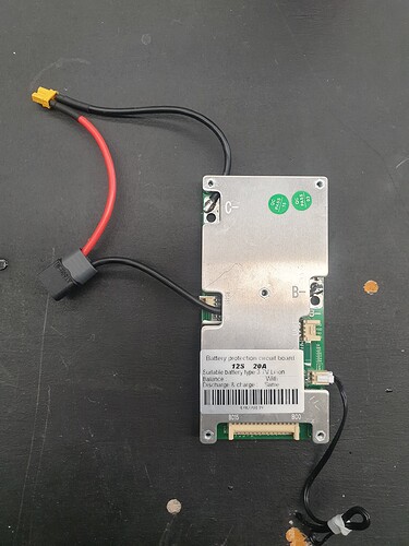

Itās not what it sounds like. He just puts bullet connections on the B-/Ch- connections so it can be easily swapped out. I did something similar for a bike battery where I couldnāt fit the bms in the battery box.
Edit: way late to the party lol. I had that comment in draft way too long
Yeah I saw the pic then u instantly know what he meant. Itās actually a good idea, I might copy it one day
If youāre stuck for space and canāt have your bms inside the enclosure it makes it a lot easier to charge without having to fuck around too much. If itās inside the enclosure Iād say youāre adding more potential points of failure but maybe Iām just being anal ![]()
Is the battery from Mboards as well?
Good points, but having every seperate part of a board be easily maintainable is a bonus. Sometimes itās more hassle than itās worth, but i like connectors on the bms where appropriate.
I donāt like bullet connectors on batteries tho⦠just feels dangerous.
I set them up like this
Ya that looks like a solid harness. And I agree re the bullet connectors. If one comes loose you have exposed metal boucing around inside your enclosure right next to your pack.

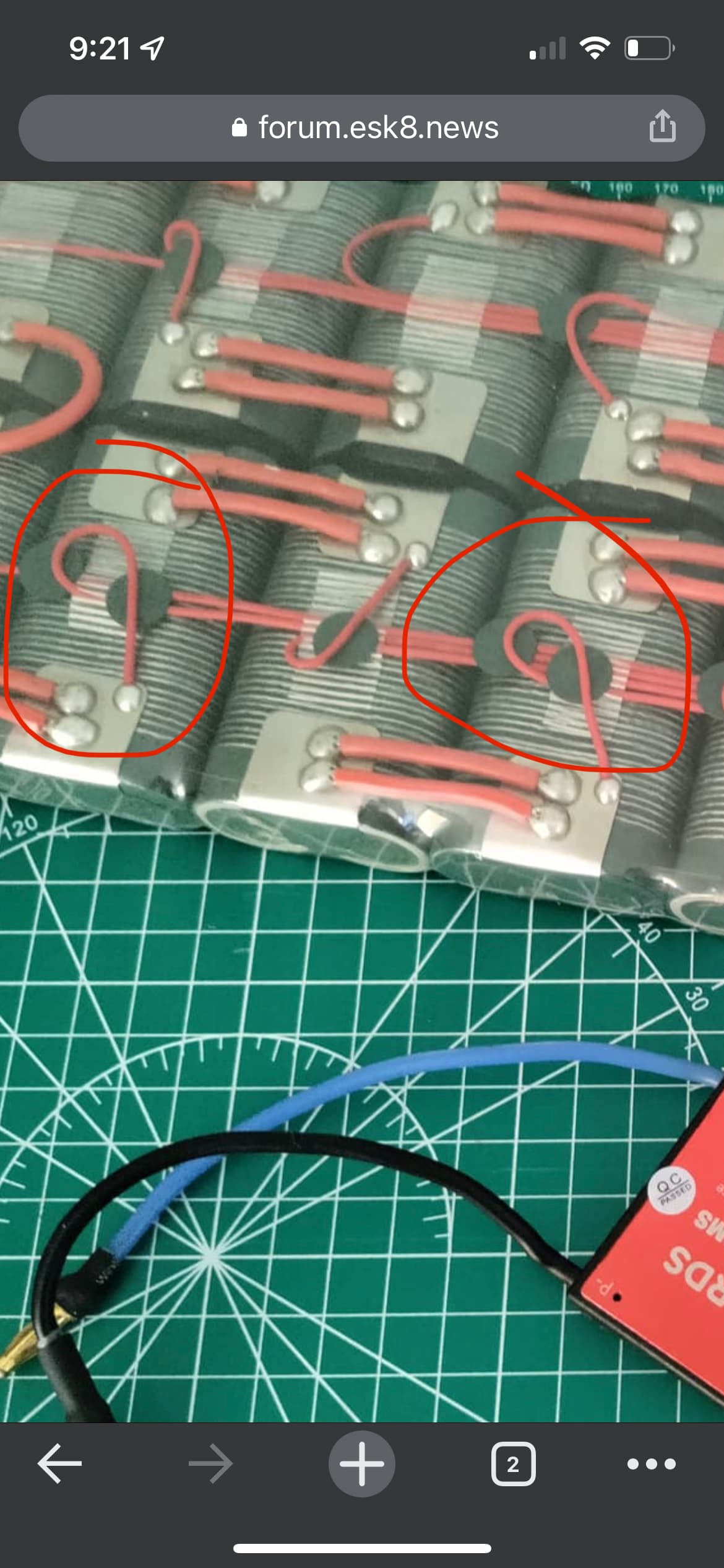

Wow, double cross oversā¦
When one isnāt spicy enough ![]()
Tbf, the series connections are that much taller that the crossovers are pretty much inconsequential

Hahahaha hory sheet I def didnāt take a close enough look lmfao. I stand corrected. Beardās batteries look much better but heās got some chimps doing the handiwork clearly.
