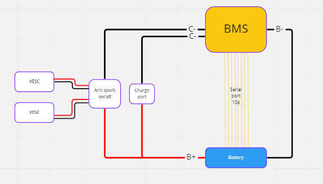

Hi guys!
From a first glance, does the attached diagram look correct?
diagram

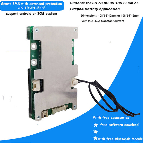

I’m trying to revive a Raptor 2.0 with this BMS:
After a half day’s worth of Googling, I don’t feel like I found sufficient info, so I’m trying myself.
