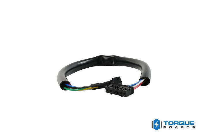

The older motors needed this adapter, or put on your own JST PH connector
Measure it?

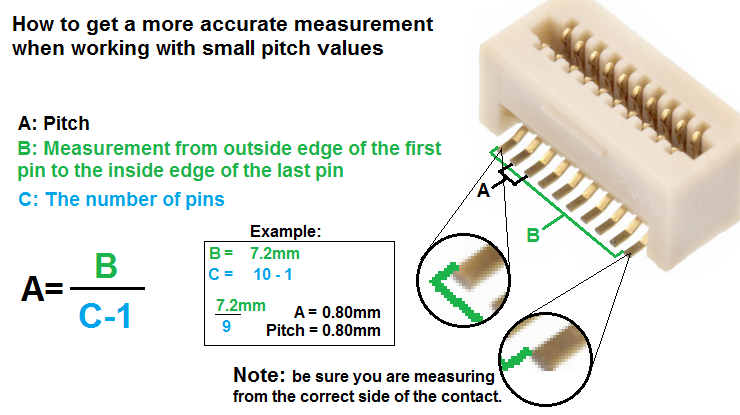

If it has a bunch of pins, measure across a few and divide to get a more accurate pitch measurement.
The chart on the Wikipedia article has the names for each different pitch (spacing)
