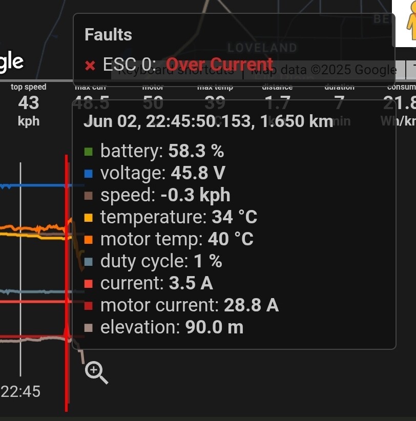

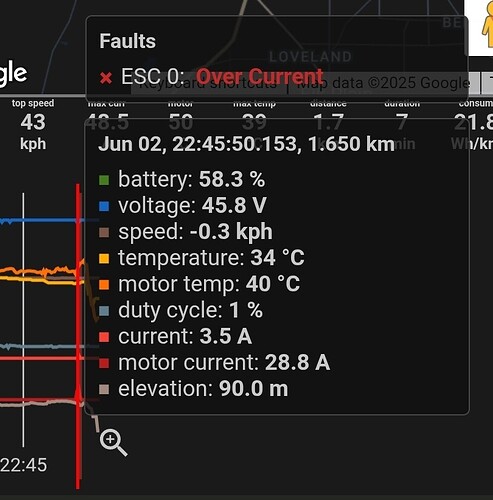

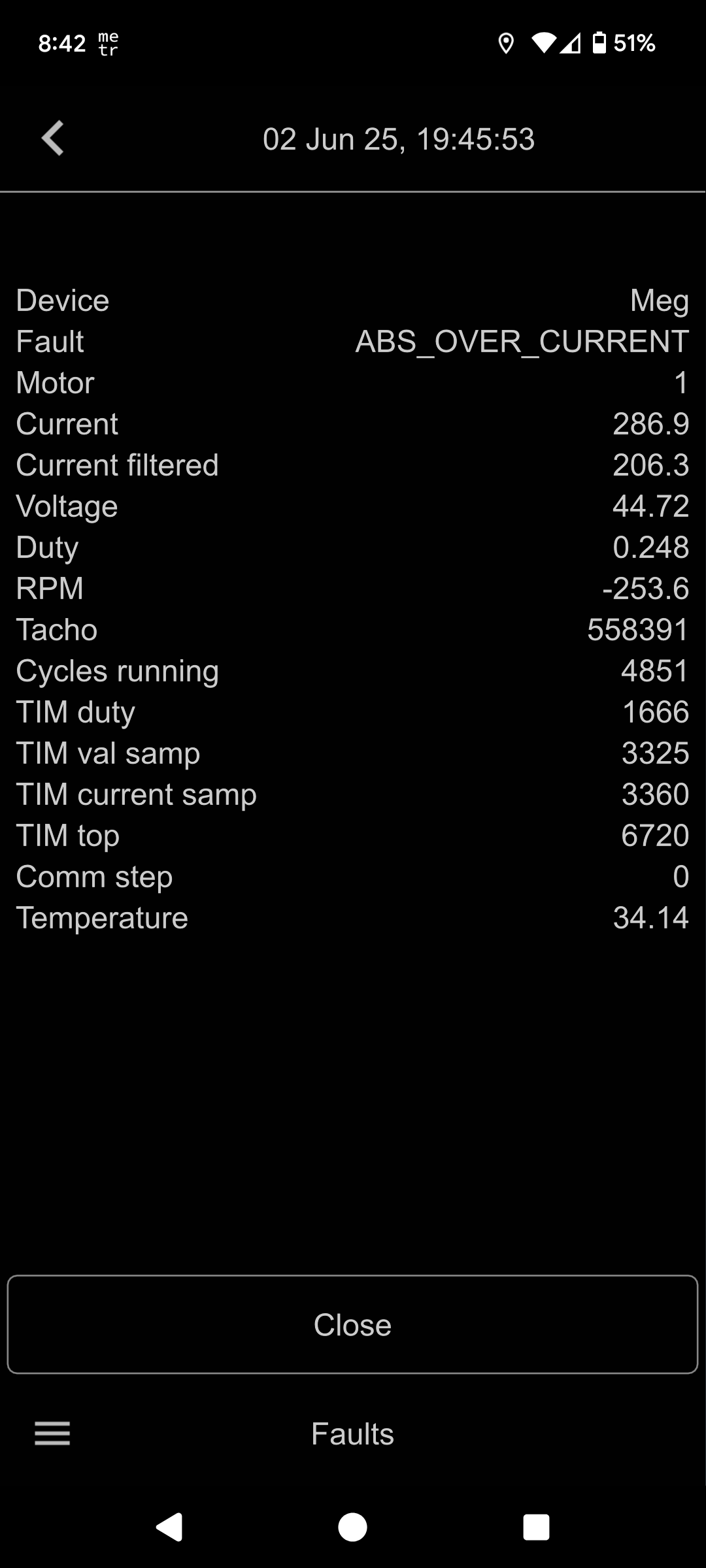

I’ve been having some over current troubles recently
SC60D+, Slow ABS is on, I’m only running about 70 motor amps/side with 200 as the abs max. Seems to only happen at low speed and low throttle. Anybody have diagnosis tips?
Eta: the end of the metr log, the video and the screenshot all depict the same instance of the fault though I have had others.
Hmmm only odd thing I notice is that your speed goes negative but your amps (current and motor current) stayed higher than expected.
Was it a quick blip on the remote on the end or what could have caused the motor amps to jump? Looks like you were stopped for about 27 seconds prior to the error.
I’m not sure what you mean by blip, I was staying between 0-10% throttle to induce the fault as it doesn’t seem to happen under normal starting circumstances.
Actually I was just going back and forth really slowly trying to induce the issue again lol.
Almost looked like you just tapped the remote real quick to make it spike.
I mean, kinda? I was trying to stay at 0mph and as low throttle as I could to trigger the fault which seemed to work.
It only seems to happen at sensored speeds between 0-0.5mph but my sensors both seem to be working. I’m not getting cogging on normal starts like it’s sensorless.

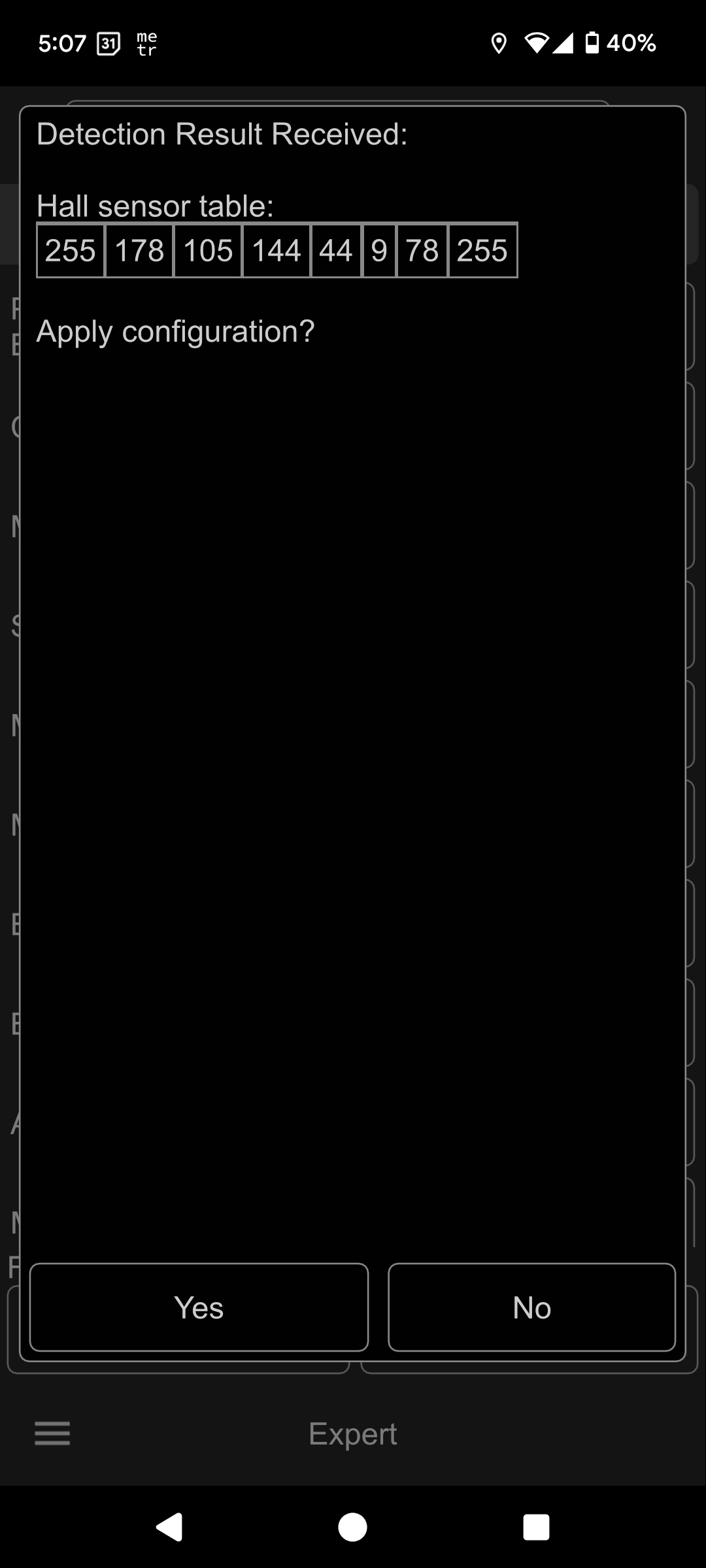

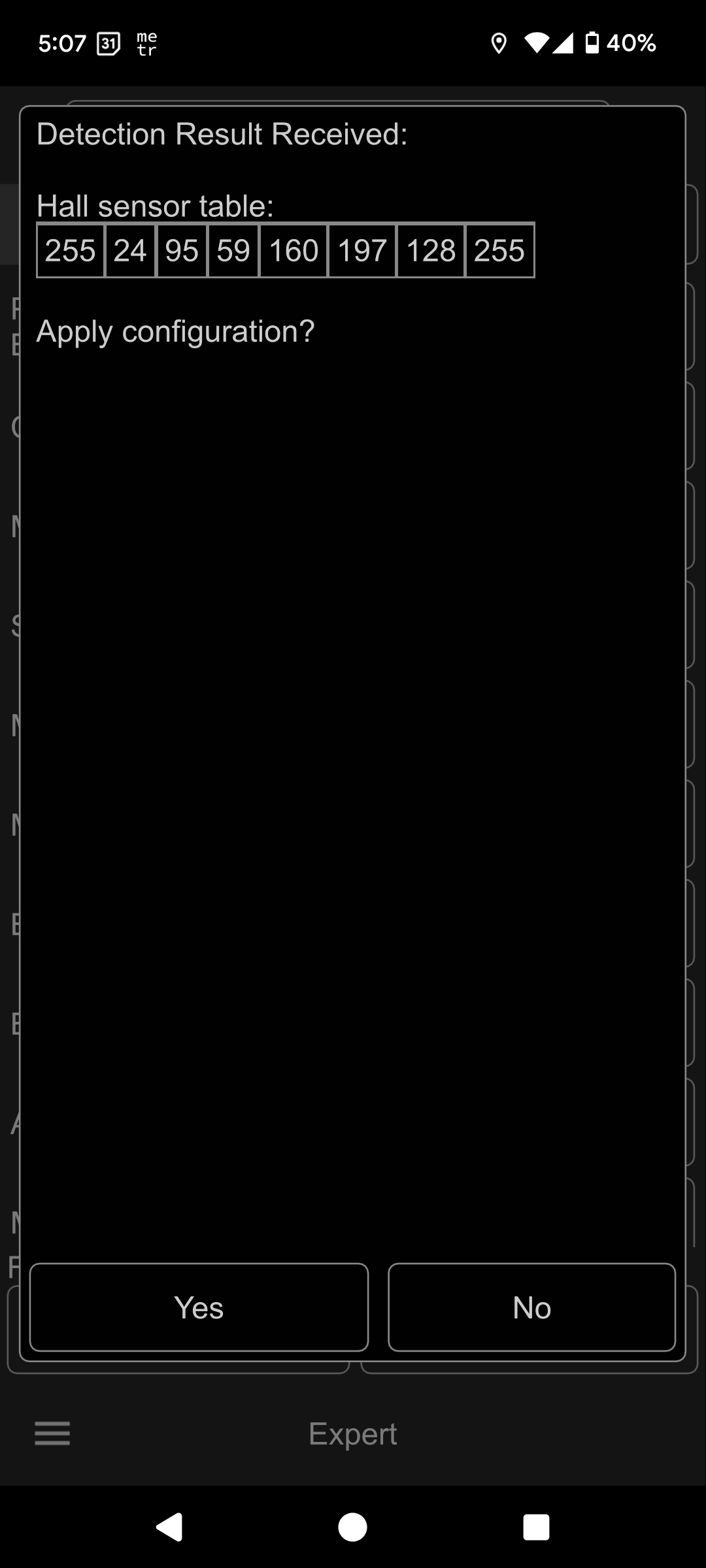

Any chance you screen shot your detection results?
Just now ran detection through Megan.
Nothing seems off to me

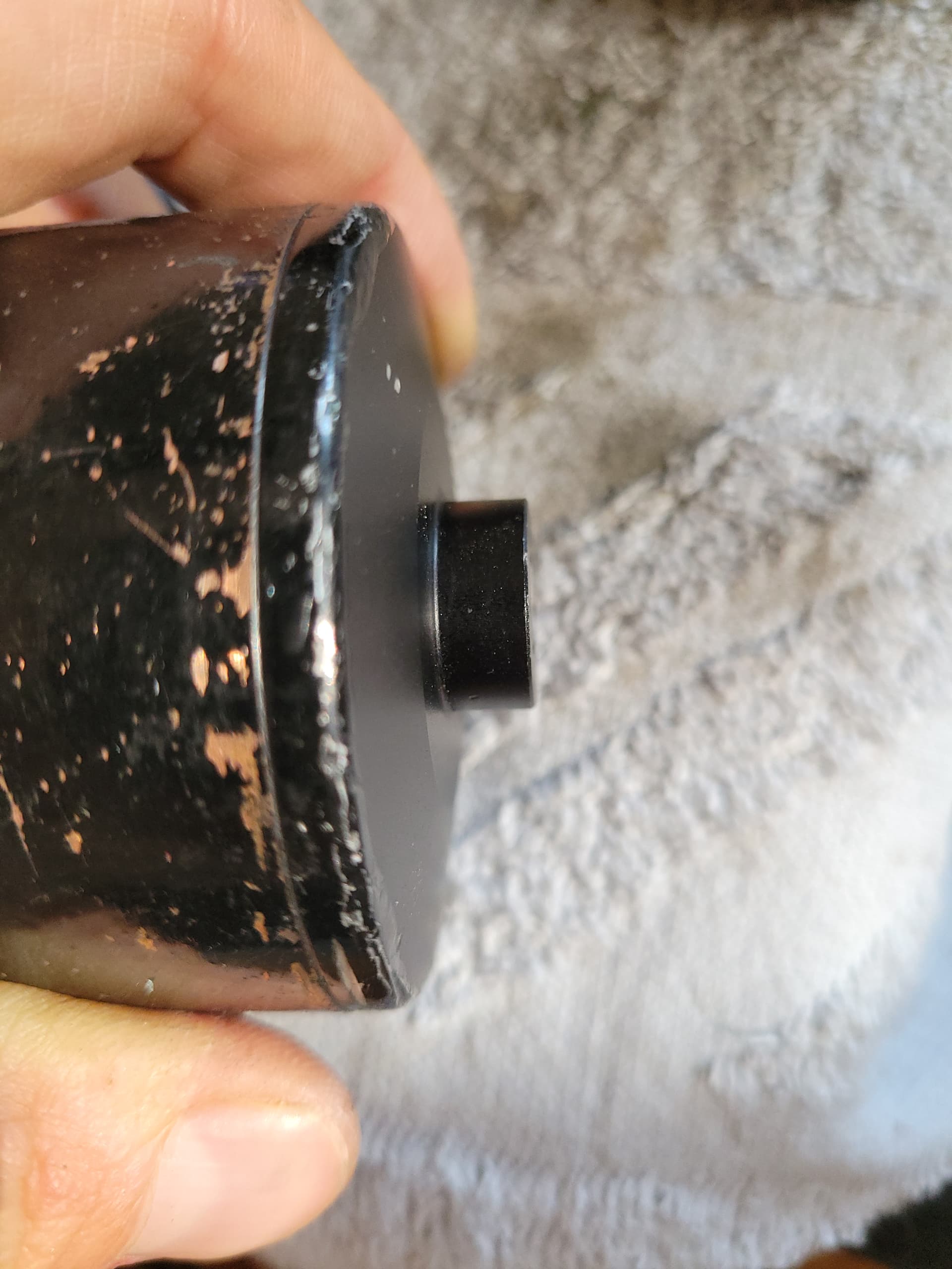

I.m working with maytech 6355 motors and caliber 2 184mm hanger. I’m shy 3-5mm to be able to fit both motors on there with bolt on wheel pulleys. I’m seriously considering grinding of 2-3mm on the botom of the motors. Is that a bad idea or has it been done before?
Can you offset them a tiny bit so the nipples overlap?
Could try that yeah. I can’t belive I haven’t tought of that. I was hoping to conect the two motor mounts and add some wood or something to protect them as i will be mounting them in reverse on a kicktail board.
