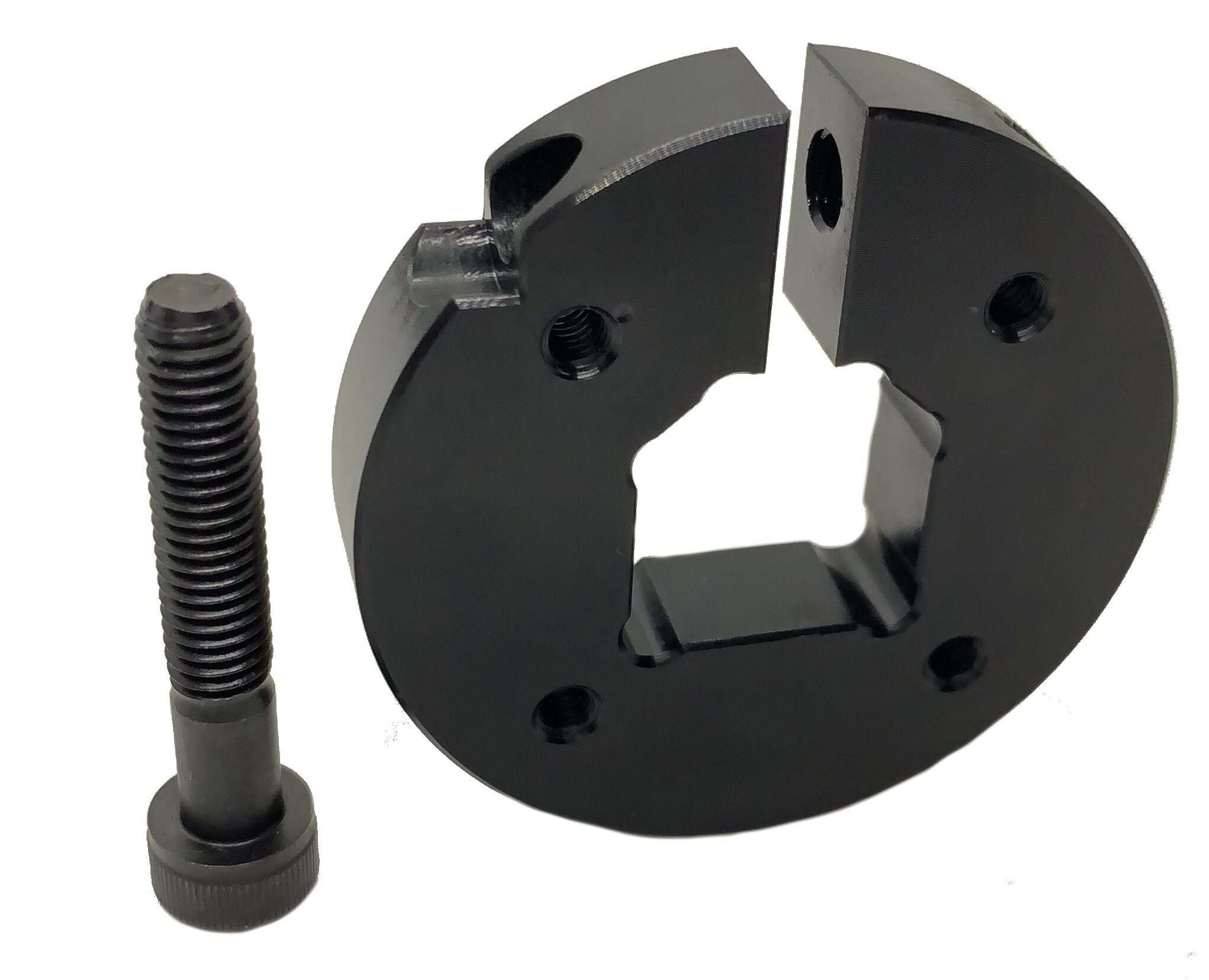

Any chance someone knows if the boardnamics hanger profile is a 20x20mm square?
I want to get 4 of these for making my own motor mounts, maybe 8 if someone recommends using one on each side of each motor mount to keep gears aligned better.
IMG_9495
Or I can use these, or I can make a wtb thread for 20x20 adapters from resold GDs. re rc
2 piece clamp > single piece clamp
I know MBS has some but it would be $100 for 4, 200 if I want 2 clamps per mount for precision and stiffness. Know of any others?
The Boardnamics M1AT adapters pictured bottom $70 for 4 are probably going to be the best hopefully I get lucky with where they line up on the hanger and the sides are thick enough to thread.

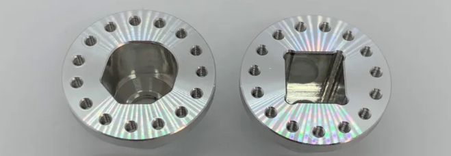

Hey guys, is there a standard mount pattern for 50xx motors? My motors dont seem to fit the mounts ive printed.
There are these adjustable base plates available:
not sure if BN still has some in stock, you have to ask @Boardnamics
and 3d servisas variant
I think they do ad some hight, so keep that in mind.

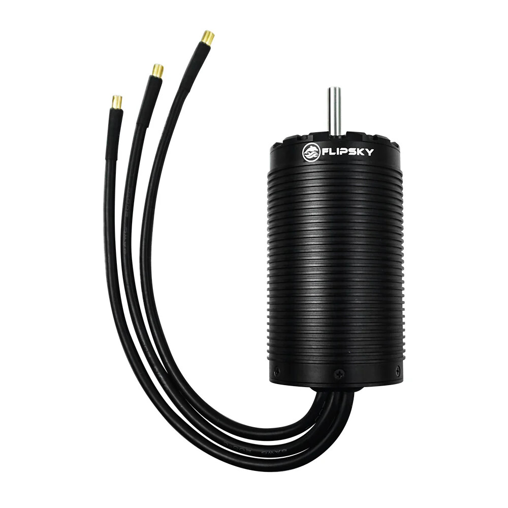

Flipsky has a $136 (with discount) 70120 inrunner, I would not use the extra power but would it have a longer lifespan than our outrunners and would it have better freespinning losses while being as powerful?
Also only 4 poles instead of 14! Great news for VESCs! I can gear down 1:10 by lasercutting a big spur gear but still want a lower kV than 480. It does not come with temperature sensors, but I think overheating is unlikely.
Also to double check, if you use a high Kv motor on hV and don’t gear down significantly does the VESC make significantly more heat even though the motor is still roughly as efficient?

Wouldn’t you end up running into too high of an eRPM first? Or does 4 poles solve that?
The scenario I am thinking of is 170kv 19S 63xx flipsky which is a lot of rpm for those motors and lots of freespinning losses, at full charge that’s under 100k erpm, I think 150k is the usual limit. It would only make sense and be easily possible to be geared much above your top speed. What I am trying to confirm is if lowering Kv to just above your desired top speed is more efficient within the VESC.
In this scenario having enough speed from 140kv under the same gearing and running 82% as many motor amps for the same torque and motor load.
In terms of inrunners I don’t know much about inrunners but those would have 3.5x less erpm for the rpm as outrunners. So at least in the relevant motors a vesc has to switch as fast for a 190kv outrunner as it does a 665kv inrunner.
