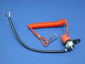

I wasn’t sure where to ask maybe it’s been discussed before, but is there something I can do to get the esk8 to hit the brakes when I don’t have the presence of mind to pull back the throttle while falling? So far it’s almost ended up in a canal or completely lost under a gap I couldn’t fit into, could go under a car and has been severely cut and bashed under a gate.
Maybe along the lines of the remote disconnect failsafe setting and a little tether between my foot and the rx wire?
Deadman tether.
17470666787189135772663929877636
Yeah, i thought about this, if i were to do, id attach an mbs leash to loopkey, no real extra work, strap the leash to your ankle, if you ever come off the board i assume the leash would stay with you
Yes but you can also wire a Deadman switch to ADC pins and tell the VESC to apply brakes when it’s pulled.
Loopkey is just gonna turn off the board and let it roll into traffic/ocean
Was planning with 3ds drives so freeroll didnt really factor into my equation :sweat_smile::rofl::sweat_smile:
The problem with anything like this is the potential for the failsafe function to occur when you don’t want/need it to.
Unexpected brakes at full speed isnt gonna end well.
I was definitely thinking about that, but at least it takes only a couple amps to stop an esk8.

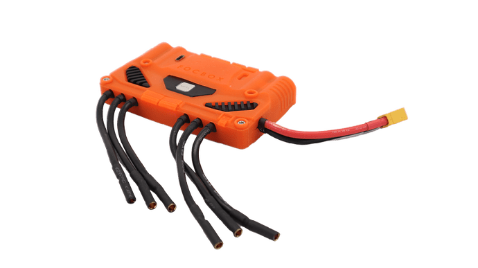

I’ve got torque6 and unity ESCs that I’m setting up, wondering about battery amp ratings. I’ve only been able to find phase amp ratings on google and the forum, and I usually don’t go higher than 50% of those ratings for setting my battery amps as a rule of thumb. I’m wondering if anyone has experience with how high these ESCs can go before overheating?
I don’t have any specific insight but choose 75% as my baseline rule of thumb. We probably came up with the percentages for he same way :rofl: look at it sideways, close left eye, slight grunting noise, write motor settings
Oh I actually toss a bunch of chicken bones down a staircase and see whether it spells out a number, but I can see how that works too. Trust the process :ok_hand:
Focbox is 80a battery max a side or 160 total btw. In the unity software you just put it in total for both iirc. Been a minute. Neither the battery or motor amps can exceed 80 a side or 160 total. Worded poorly on the site and everywhere it seems. I set up an older lonestar at 80 motor amps and 60a battery at the owners request and it seems to be holding up pretty well. I think it was 10a more than the original settings I found it at

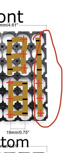

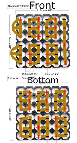

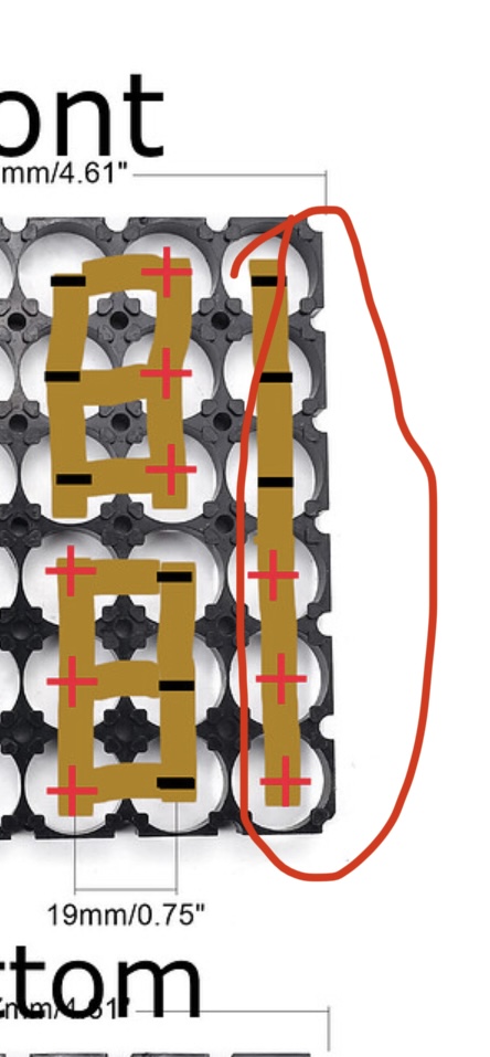

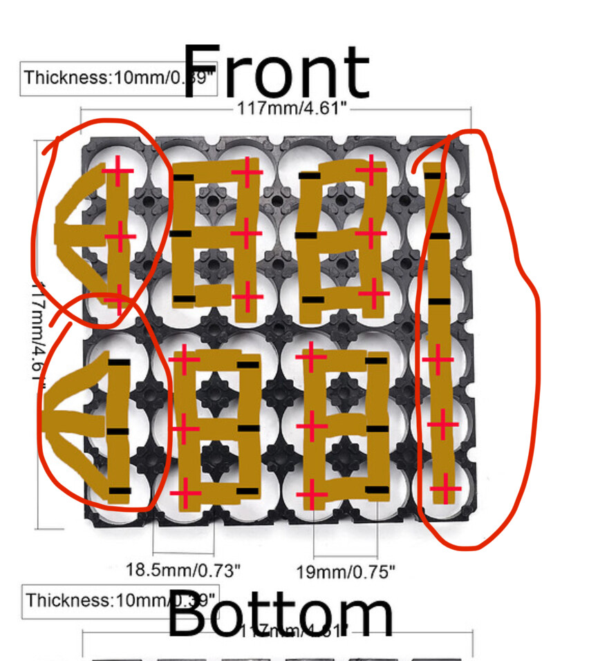

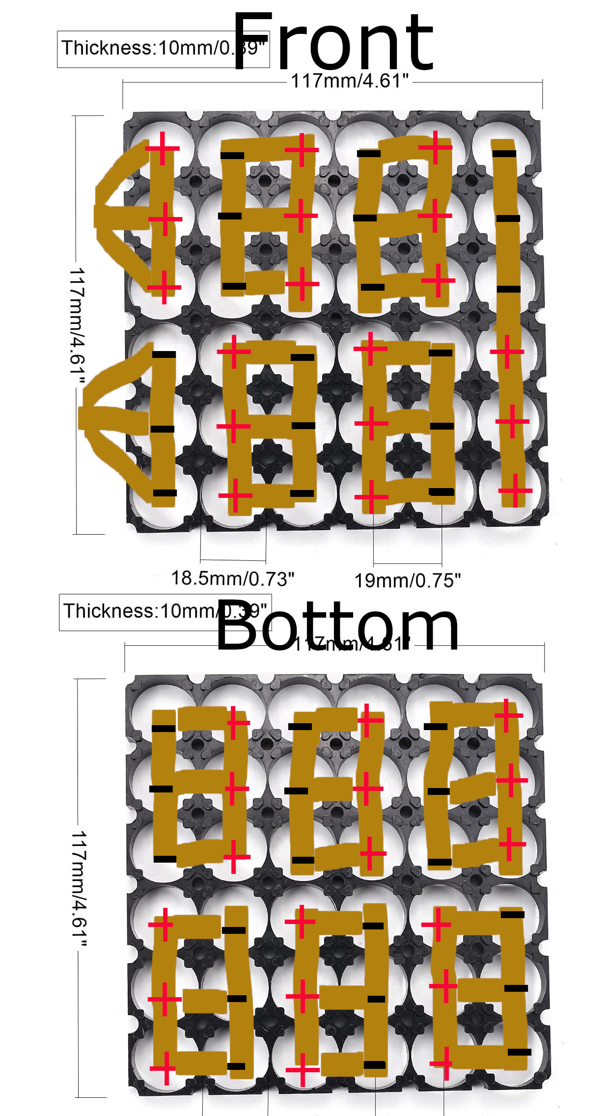

I’m building my first 12s3p battery in a 6x6 set up with p42a 21700s
Building it with no bms and will be charging with a icharger x12 w/ a 12s balancing plug (I’m not sure on how to connect the leads yet on this)
How does this set up look? I will double up the strips on the right side connection and the + - side
Thanks for any help or advise!
repost because of a design change

Don’t double up the strips, just get bigger nickel. Doubled strips works but is hard to get right. Easy to not get the second layer to weld right and have the whole mess come off with vibration
https://www.amazon.com/gp/aw/d/B08TW7TC48?psc=1&ref=ppx_pop_mob_b_asin_title
If you get 30mm wide strips in .2 it’s easy to make it way overkill for amperage but also easier to execute.
With cell holders i think it’s also important to glue the cells to the holders to keep them from being able to shift with vibration. Small differences in tolerances will focus the movement at the weld and at the nickel which can eventually cause work hardenin g and crack the nickel.
The design and current path looks good but if you use the full 30mm width for the outputs and the long section here:
It should have more than enough meat to carry the current but often people will use two separate tabs on this section:
Then connect them with braid or parallel silicone insulated wires to make sure it isn’t a bottleneck for current
