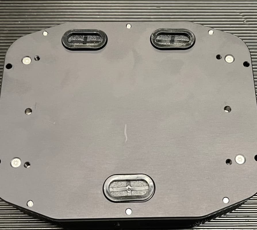

Does anyone have a source to buy or a file to print these gasket / grommets?
https://a.co/d/ff73jeR
Here ya go :+1:
Hell yeah thanks!
