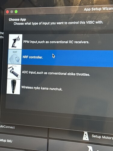

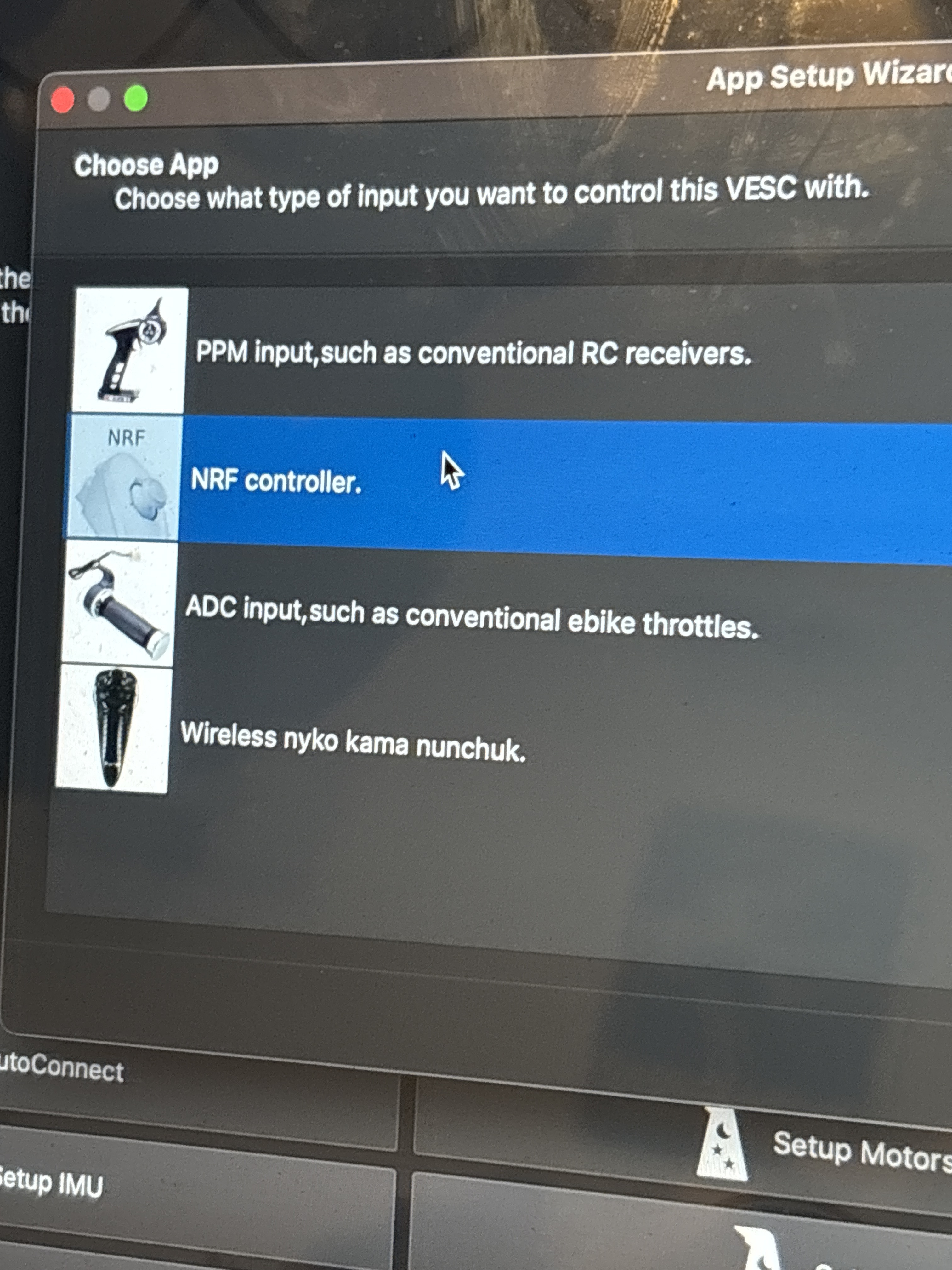

How do I connect my vx2?
Why is their no uart option?
Or am I completely lost and missing something simple :sweat_smile:
Maybe something to do with firmware? I just updated it, but they still say “ this version of vesc tool does not include any firmware for your hardware version”
How do I update that?
Looks like the wizard doesn’t have the remote config.
After doing the wizard, on the vesc that the remote is connected to, go into your app settings and change “app to use” to UART
