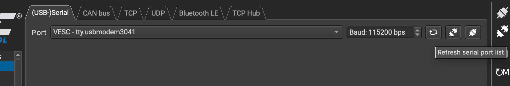

I assume you’re using the downloaded desktop version on the mac, and not the app store (ipad version) which afaik doesn’t connect to serial/usb ports.
if so…

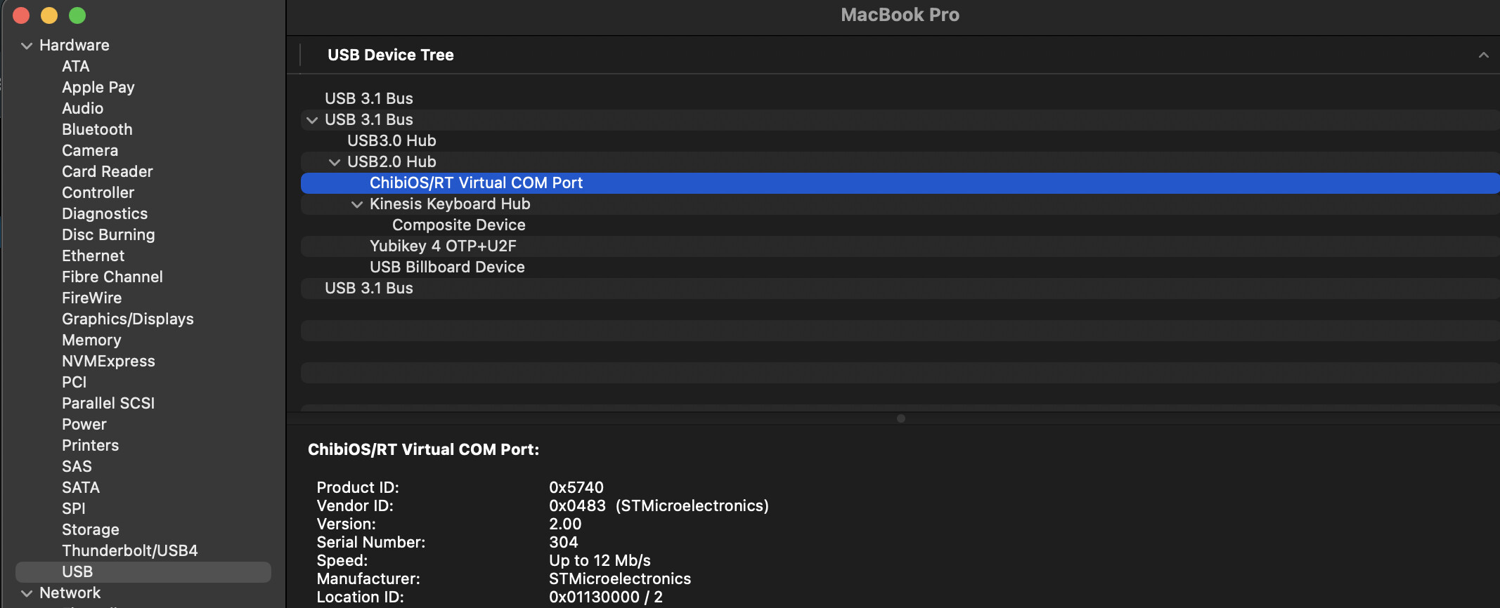

unplug your vesc from the macbook.
open system information app
Summary
/System/Applications/Utilities/System Information.app
or apple menu → about this mac → more info → system report…
select usb.

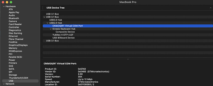

you should see a tree of stuff on your usb bus.
now plug in your vesc via usb and hit CMD-R to reload.
if it is connected you should see something new.
see i get a virtual com port.
Go into vesc_tool → connection → usb(Serial)
click the little refresh serial port list button. you should see new serial ports pop up in the port list.
click the connect button. not the one on the right side tool bar, which is ā€œconnect to previously connectedā€ but the one inside the USB(Serial) tab.
:crossed_fingers: it should connect.

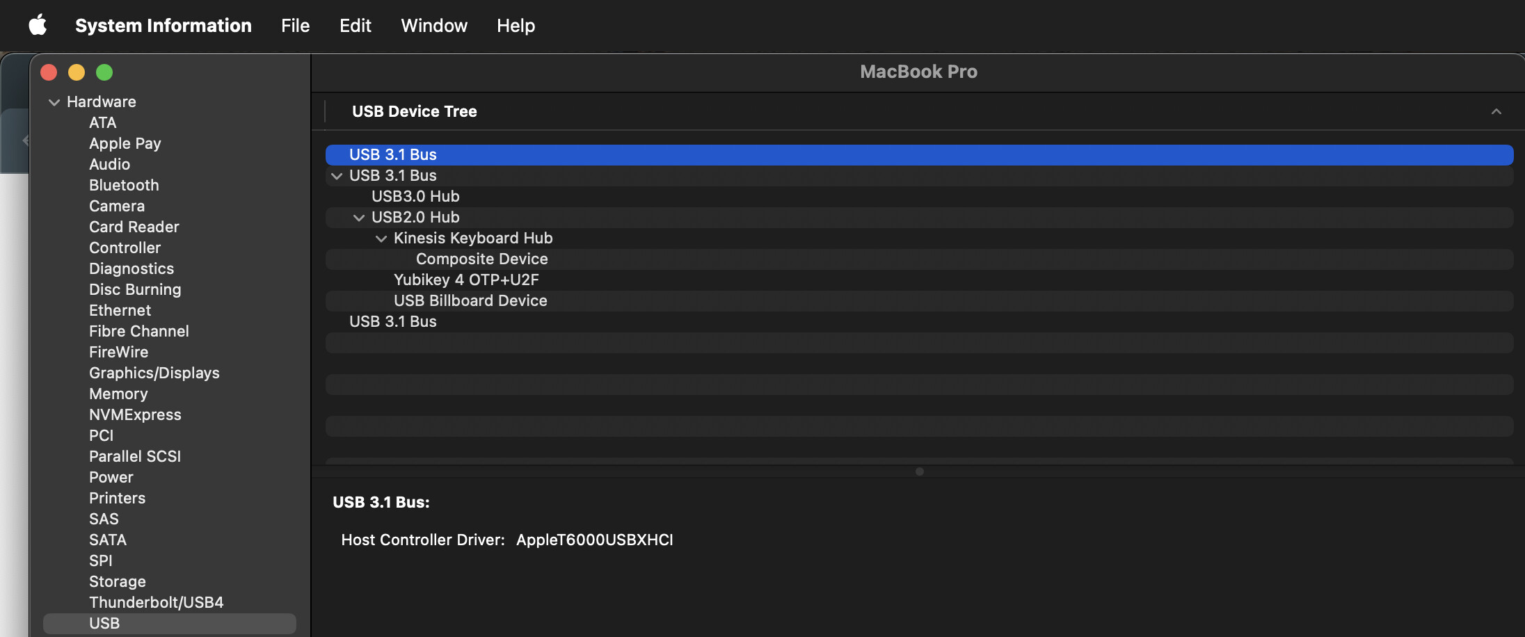

I don’t see anything :face_with_diagonal_mouth:
Maybe I am plugging the usb into the wrong spot on the MacBook/vesc?
Try different cable? a cable you know is a data cable, and not just usb power cable.
there’s no wrong ports on the macbook. or the vesc.
vesc is powered on? it won’t be powered by usb.
