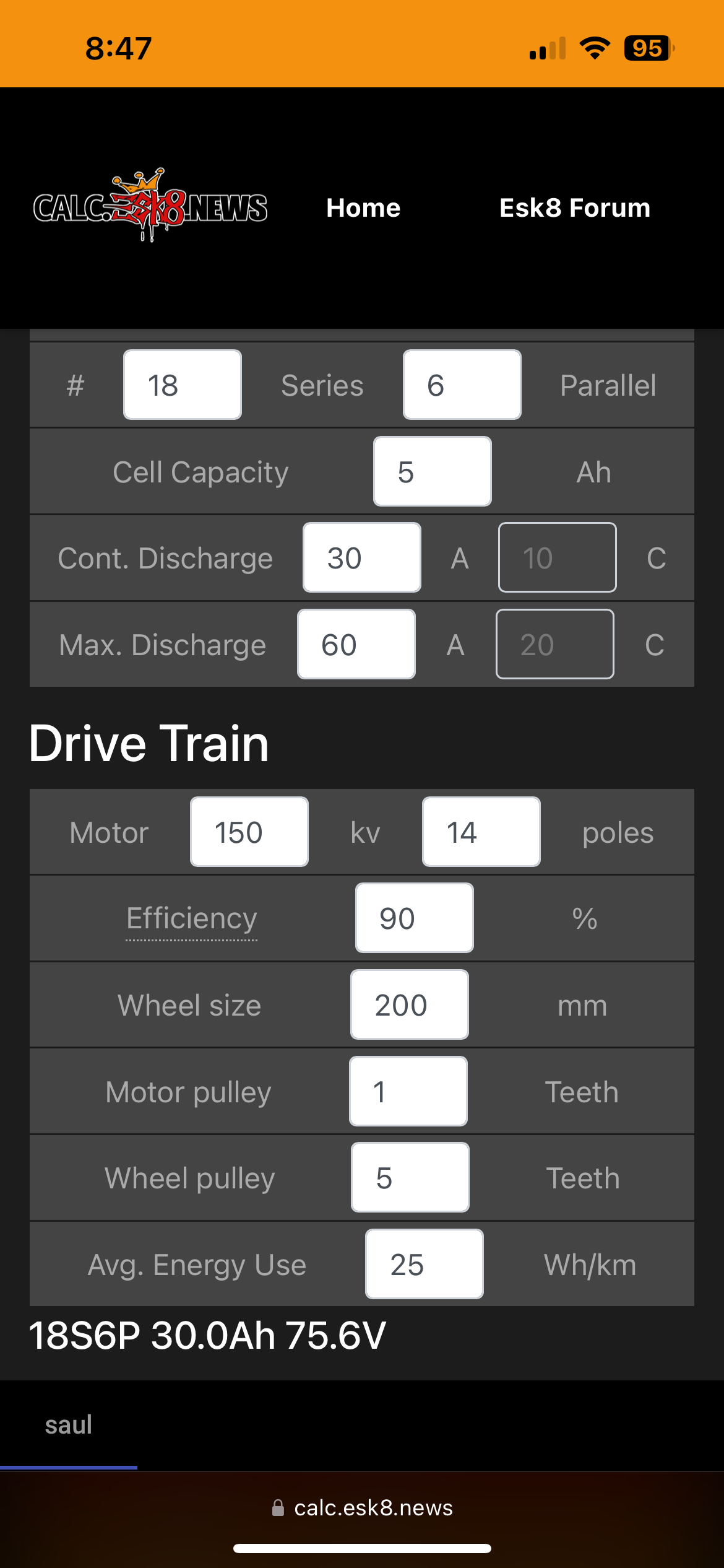

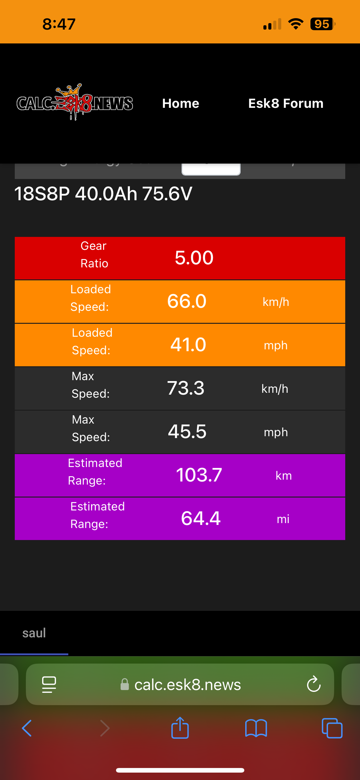

What insane configuration gets you 70 miles of range?!
18s8p and super efficient motors and gears. This is in Seattle btw so everything is hills and bursts to 35-40 mixed in. If I ride super conservative i get 100ish
DAMN
Looks about right,
72t-15t
160kv
70% motor efficiency
25km/wh
Im using 50s cells so 5ah instead of p42a 4ah. This comes at a cost of amperage output - if pushing higher amps they drop in usable capacity and can sag harder under higher load. Because it’s 8p it offsets this a bit by spreading the load out.
Also my preferred cruising speed (25mph) puts my motors at about 70-80% duty cycle which is the sweet spot for efficiency but also low enough that wind resistance doesn’t get too bad which also effects efficiency.
The 4gs 5/1 gearbox is really efficient and has great freeroll.
I run my tires hard and on the upper end of psi.
I have a slight negative expo on my throttle which helps with reducing inrush current when starting from a dead stop.
All these things add up to mo range - not a race board but it will just eat up hills and i haven’t found one i can’t accelerate up here yet except the ones steeper than stairs… which i avoid or switch back on anyway because of how awkward getting up them is. Really love the bog roosh - though I’ve hit a couple hiccups on the build I really enjoy it. :heart:

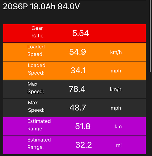

The 12s4p from @haven (if it fits in your enclosure) is an amazing deal IMO.
The 20s6p is also a great deal but IMO a but much for a first build, there are a lot of costs, risks, and complexities associated with high voltage.

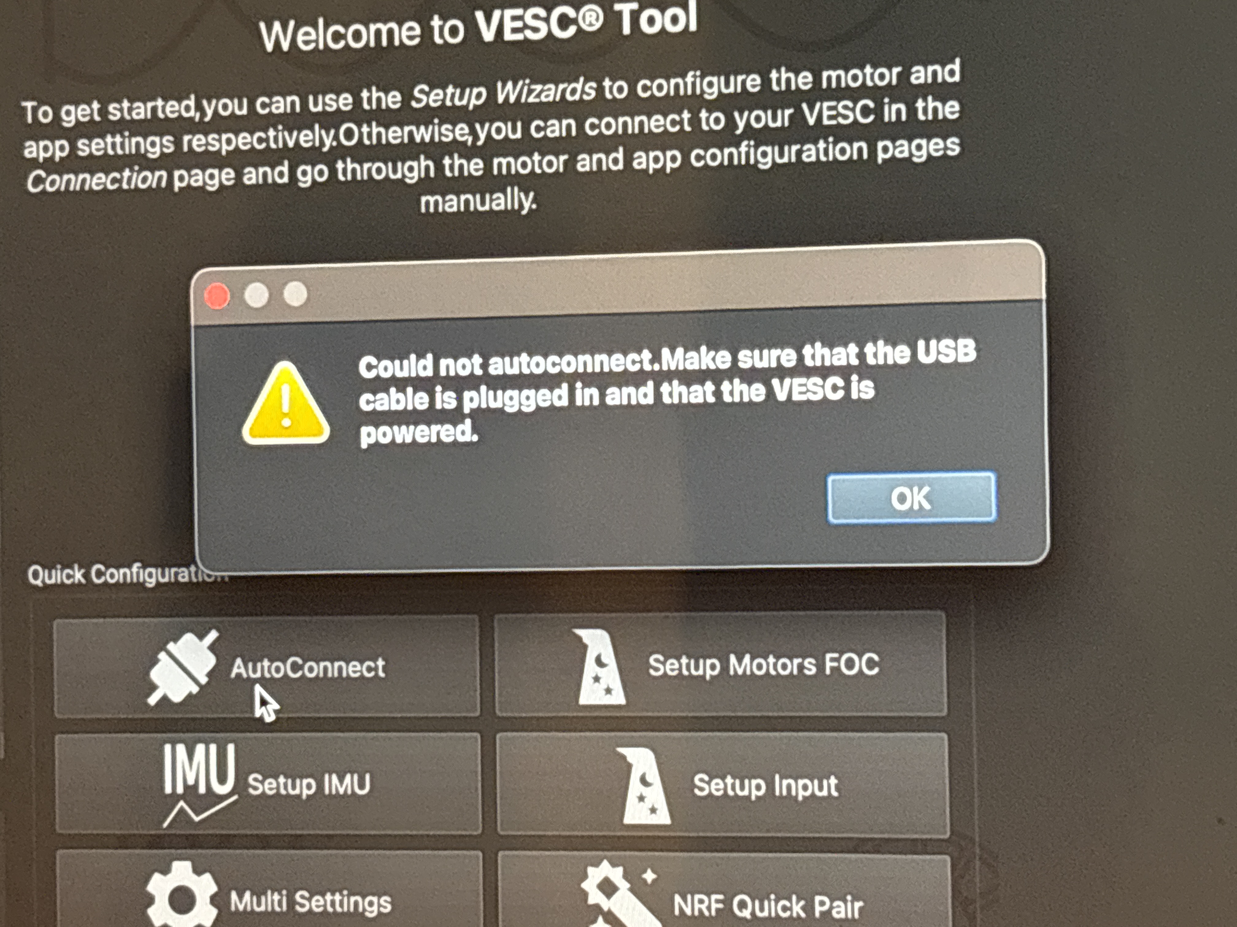

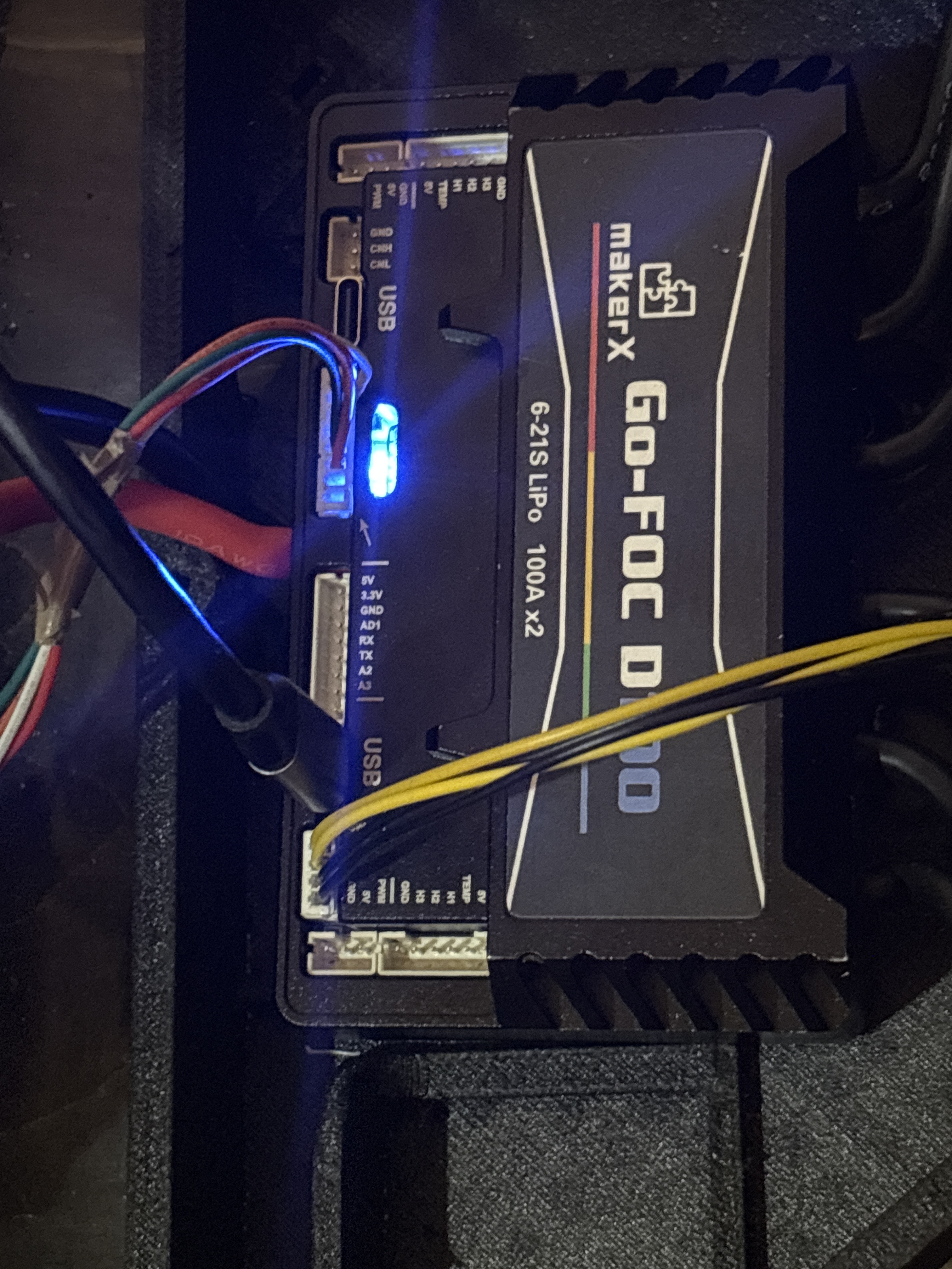

I’ve been trying to connect vesc tool and my d100 but it keeps saying serial port error, could not connect. Make sure the usb cable is plugged in and the vesc is powered. It is all setup, but I really don’t know what I’m doing, any help would be great.
Try another cable, try another port, rinse and repeat until sure it’s not the cable.
I’ve done that, tried using a driver too, didn’t work. Not really sure what to do.
