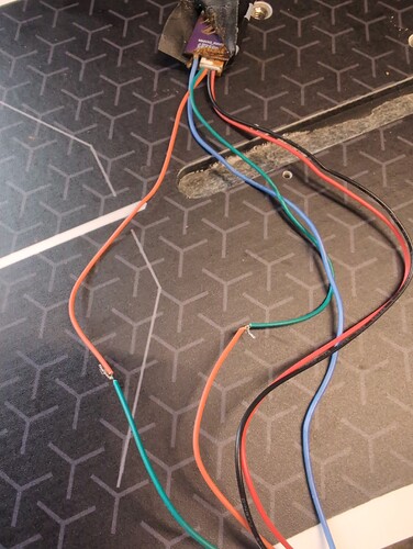

So using a VX2, the wizard shouldn’t be necessary since the controller is UART.
A couple quick things to check, make sure your RX & TX wires from the receiver line up with the proper inputs on the ESC these are the orange and green wires. Sometimes you have to cut & swap them, like if the RX is green on the receiver but terminates in the TX port on the ESC. Quick cut, solder shrink wrap fixes it.
Another comment already mentioned this but make sure you are set to use UART under the app config general tab. This needs to be done in the side of the ESC you’re plugged in to with the receiver. I don’t think there’s anything wrong with just setting both sides.
Lastly, make sure your control type isn’t set to “off”. This setting is under the VESC remote tab in app config. Once again I don’t know of any issues just setting both sides the same.
You can sometimes avoid cutting wires to swap,
You can use the tip of a needle or similar, to lift the plastic tabs holding the pins in, and just re-insert in the needed order:
thanks for all your help guys, i got it to connect and the board rides!
