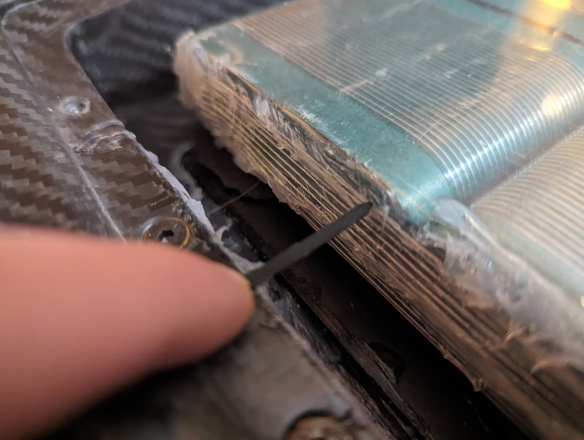

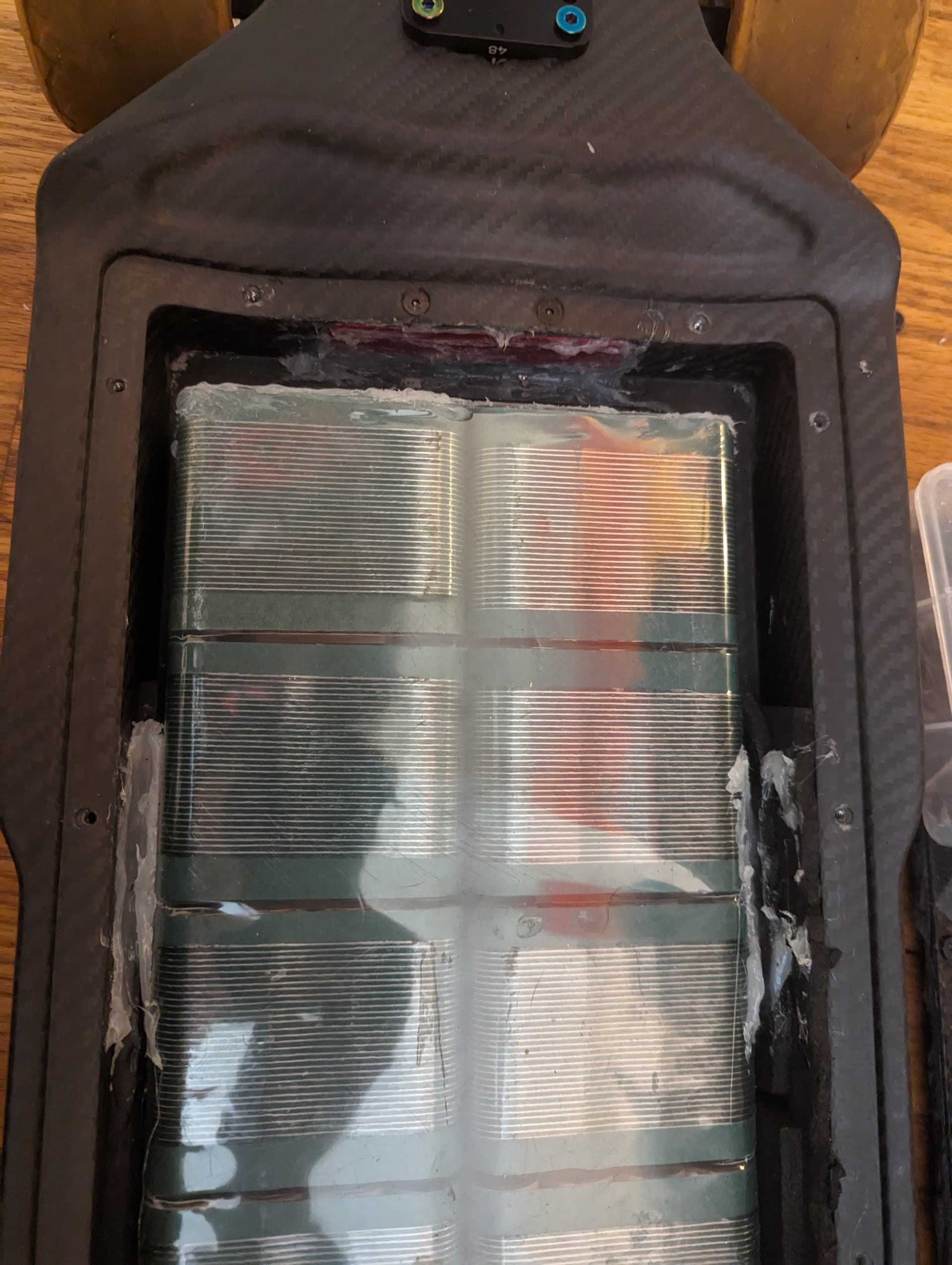

Is there padding where the battery hits heat sink (radiator)? as long as there is some fish paper or some padding there it should be ok i think. you could also get some thin adhesive ccf weather stripping, like 1/8" to go around where the screws mate with the cover to give yourself a little more clearance if you dont trust it. the cover would sit a little proud but would probably feel the same under your feet.

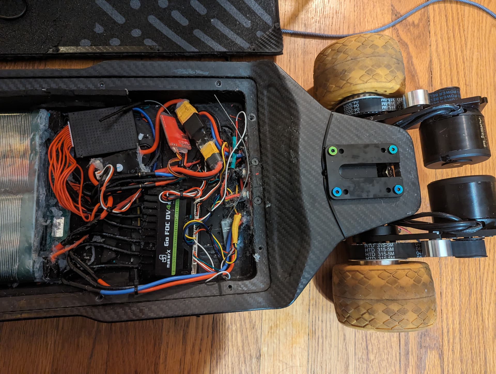

i would try to get the battery wires, balance cables, and phase wires locked in place and some thin fish paper to keep things well isolated here:
wire management
i would lock it all down with silicone after youre happy with the way everything is sitting just for some peace of mind.
The battery doesn’t touch it, it just hangs over, you can see it in the pic where I’m demonstrating how the battery rises out of the enclosure but there’s a couple pieces of thinner scrap neoprene I silicone’d down to the radiator under the battery.
How does the fish paper help with the rest of the wiring etc.? And I do actually have this u-channel rubber seal for adding some extra clearance under the lid and I wish I tried I applying it before the neoprene as I’m uncertain about if it’ll be as watertight… https://www.amazon.com/dp/B0BNB8X3HX?ref=ppx_yo2ov_dt_b_product_details&th=1 I really should’ve tested this first, because I did nottttt realize how sticky adhesive backed closed cell neoprene foam is lmao (my dumbass thought I was gonna be able to peel it off afterwards, lol. :woozy_face:)
If it’s got padding below it it should be fine.
Fish paper / barley paper is super abrasion resistant and dielectric, so you would just place it where wires with high potential (battery, balance, phase) cross so they cant abrade on each other and short out. It’s super cheap and you can get it with adhesive so it stays put.
That edging/channel looks like overkill and probably not soft enough to seal well?

Noted. And yeah main concern with the edging stuff is that it’s solid rubber and doesn’t have any of that closed cell neoprene foam ~squish~. Either way, stuff you linked looks like the same thing as I used in a roll instead of a sheet, lmao. Still probably better suited, though.

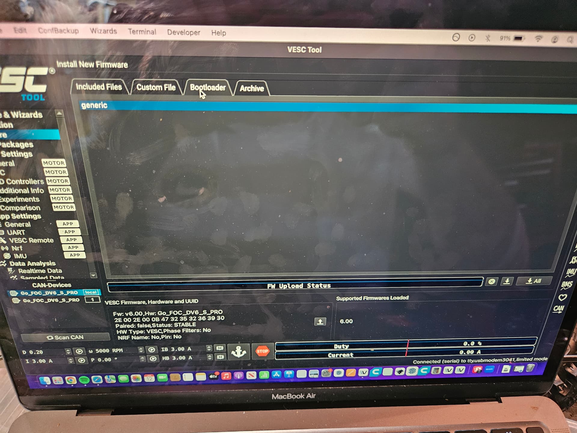

Hey i have a brand new makerx dv6s. So far i have updated the firmware to the custom 6.02 found on maker x website, i have also got the power switch working.
When i go through foc dection i get an error “vesc disconnected during setup”
Using the latest vesc tool.
I do not get any errors when connected to the vescs, just when going through foc. My motors are new as well.
I have not had this problem before with other vescs, can someone enlighten me?
Why are there no bootloaders in my bootloader tab?

I tried various vesc tool versions and flashed 5.03 - 6.02 found on maker x website.
Any tips would help.

Ok just bear with me, im no expert but this is what i would check
Try a different usb cable, mine only works with one of my cables even though both are data cables.
Update the boot loader using the generic boot loader then flash the makerx fw6.2
Hard Reset both vesc tool and the board after loading the firmware. Youll have to set the button function again to 30min and always on respectively probably
Check fw version in vesc tool and if it’s good try detecting again after checking all your connections to make sure they are solid
