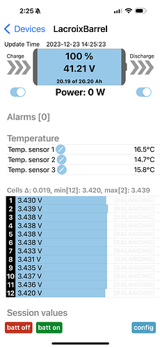

So I have a Lacroix Barrel

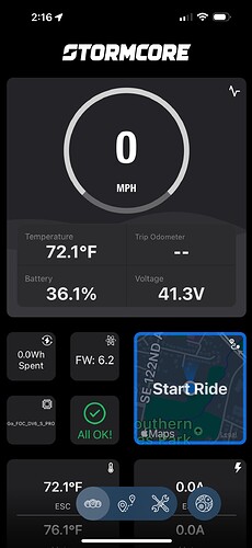

I know from just riding it and stormcore app that battery is down to about 36%
Plugged it in to charge and charger doesn’t want to kick in and charge - the BMS app
Is telling me battery is at 100%
Is this typical shenanigans for this board?
Any thoughts on why it’s not charging or what I could do?
From what i can see, the values on the bms seem fine and i can’t see why it wouldn’t charge. Is the charger actually putting out voltage?
Also… why does your stormcore app read that you’re running a dv6 pro? Surely barrel ships with stormcore?

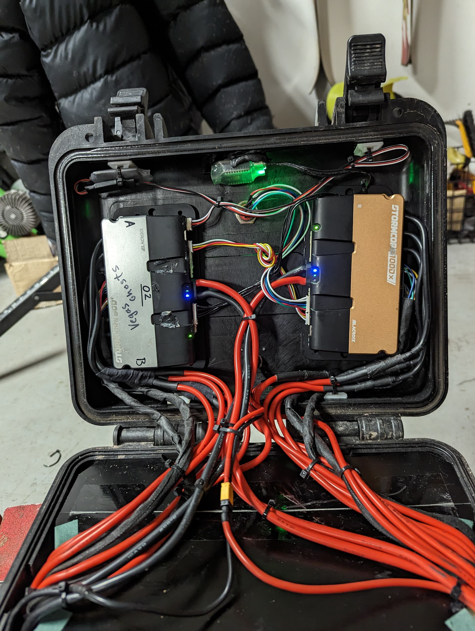

I have a Barrel and a Jaws 2
Both chargers are working on Jaws 2, neither on Barrel
I changed out the stormcore Vesc to maker x
It’s probably had a half dozen charge cycles since then
I’m tipping a connection has come loose in your board dude. Check the charge port to sentinel connection and the sentinel to bms connection

Edit: looked inside and wiring all ‘looks’ good.
Presuming something up with BMS or sentinel.
Over it - for now
I’ll f around with it another day…
I’d be checking continuity on everything with a multimeter before digging deeper
