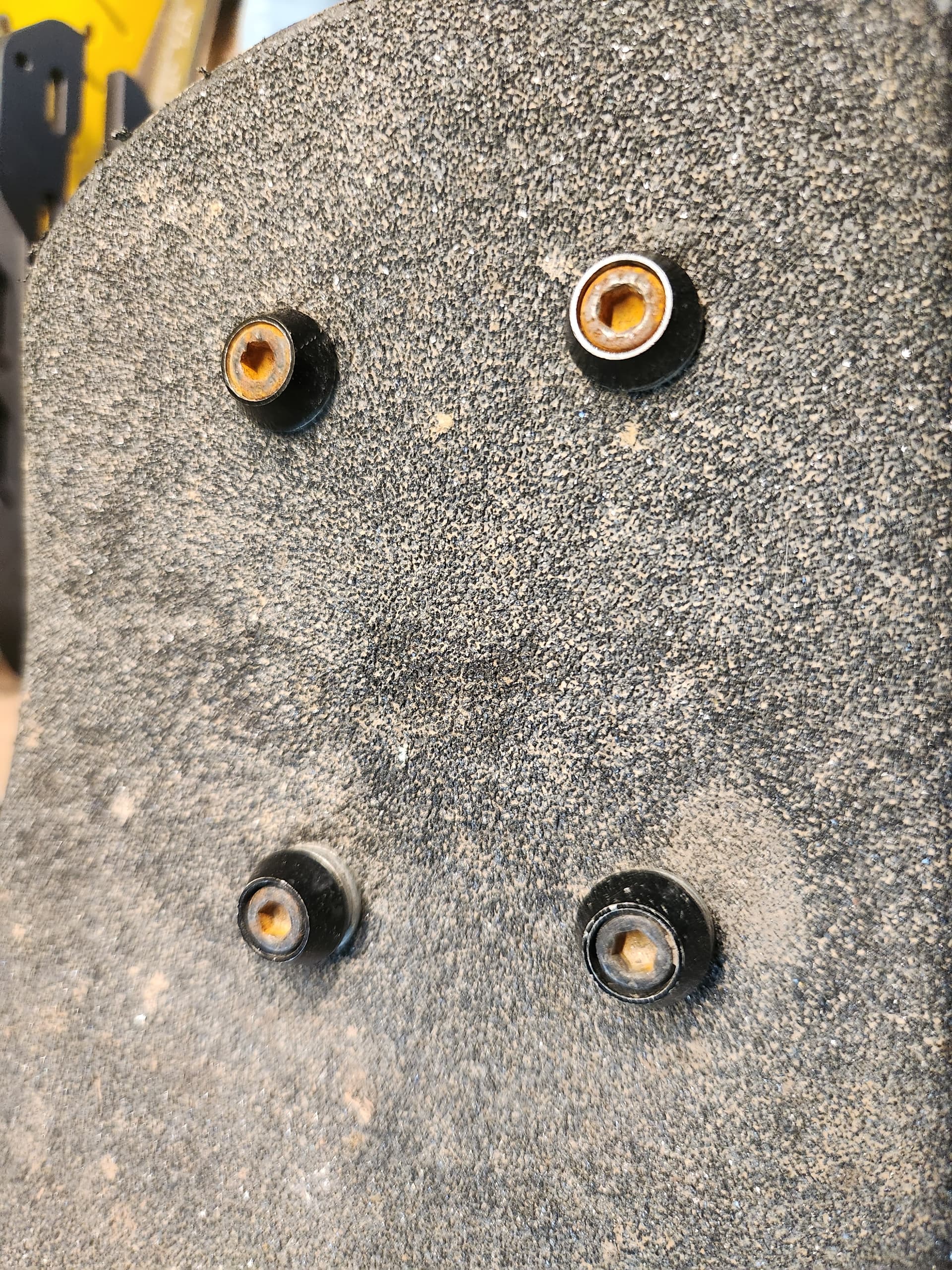

Hey kids.
Is the rust on these bolts cause for concern?
Or just a nice coating?
M5 Socket Head Cap Screws, 12.9 Alloy Steel w/ Black Oxide DIN 912
Bought from Monster Bolts on eBay.
Its called patina
Black oxide hardware annoys me how quickly it rusts. I go for zinc coated these days
It not detrimental though right?
I like the patina.
Especially on here.
Never caused any problems for me, my deck bolts always looked like that. I did have some bolts get stuck to a gear drive enclosure but for deck hardware I have never had an issue
Nah man it would need to get a LOT worse than that to be an issue, its all good
The rule i got taught is that 10mm of rust is 1mm steel corroded, so you should be good still :rofl:
Rusty hardware makes me twitch
I replaced all the hardware on my OW XR with 12.9 black oxide from boltdepot.com and the day after I got caught in the rain for 5 miles it all rusted like that, but it hasn’t gotten worse once a thin layer built up

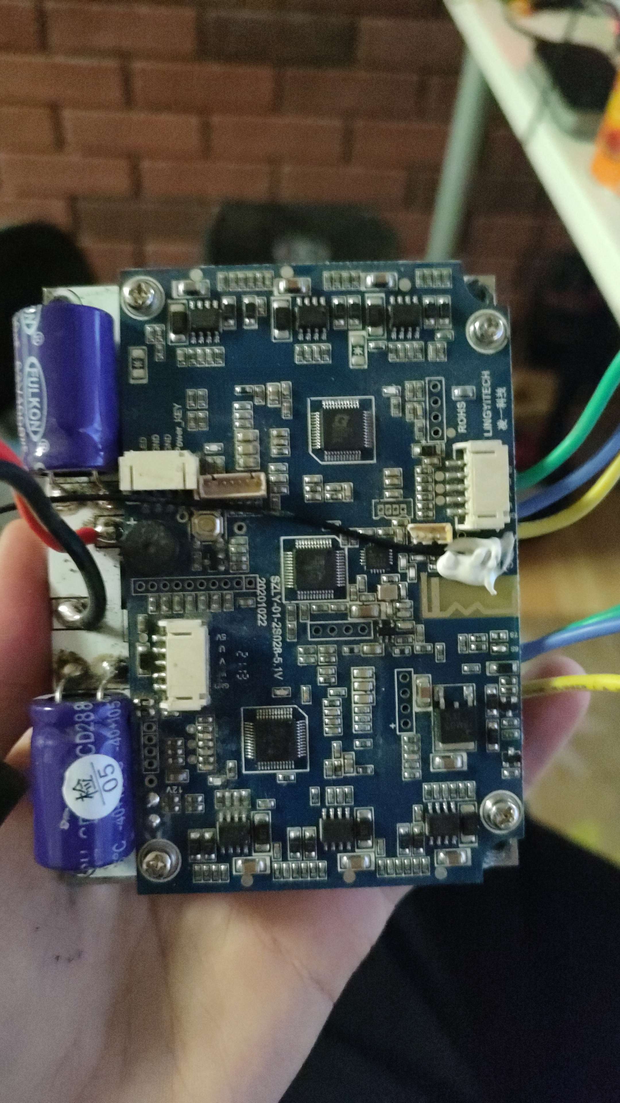

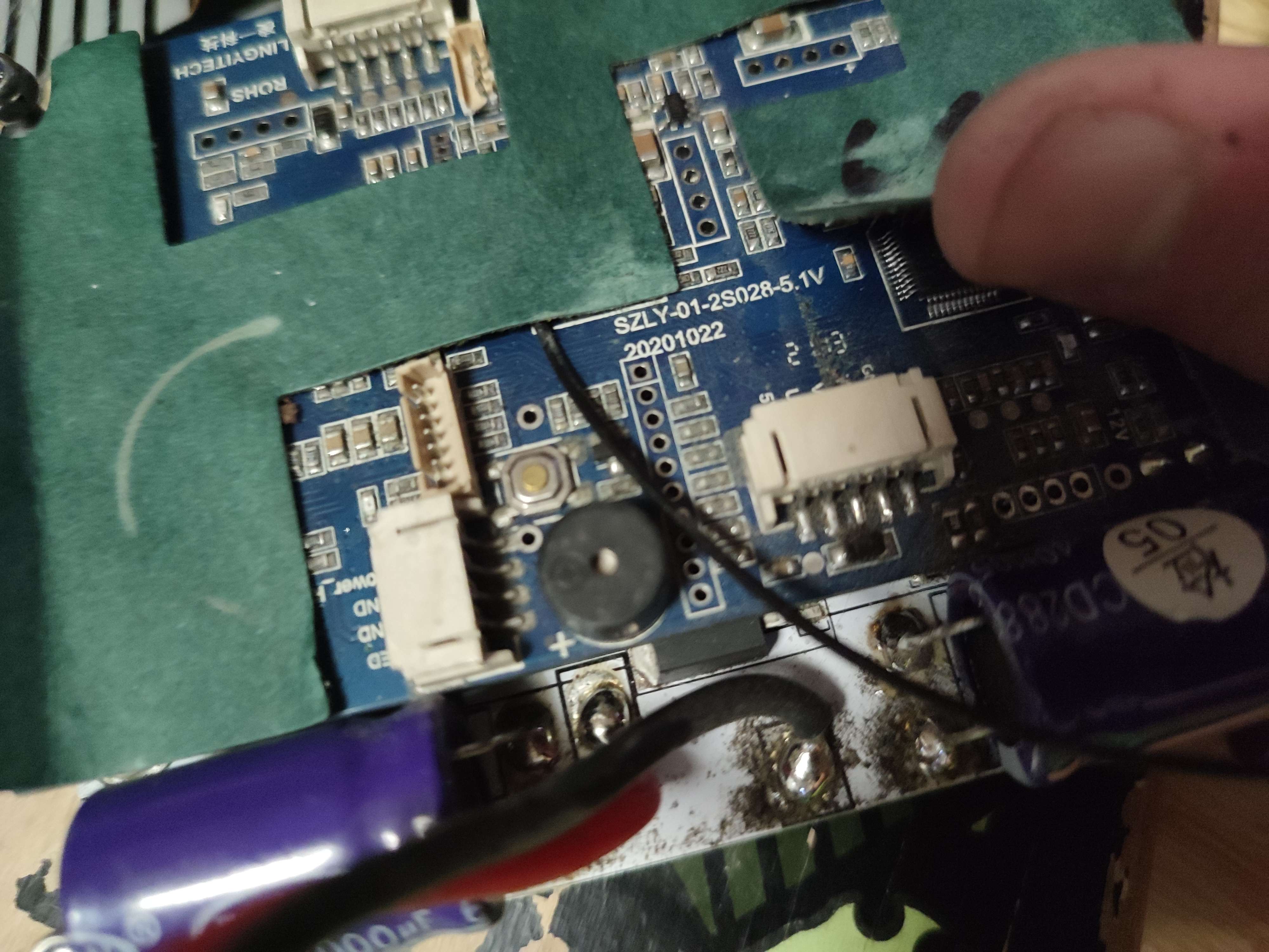

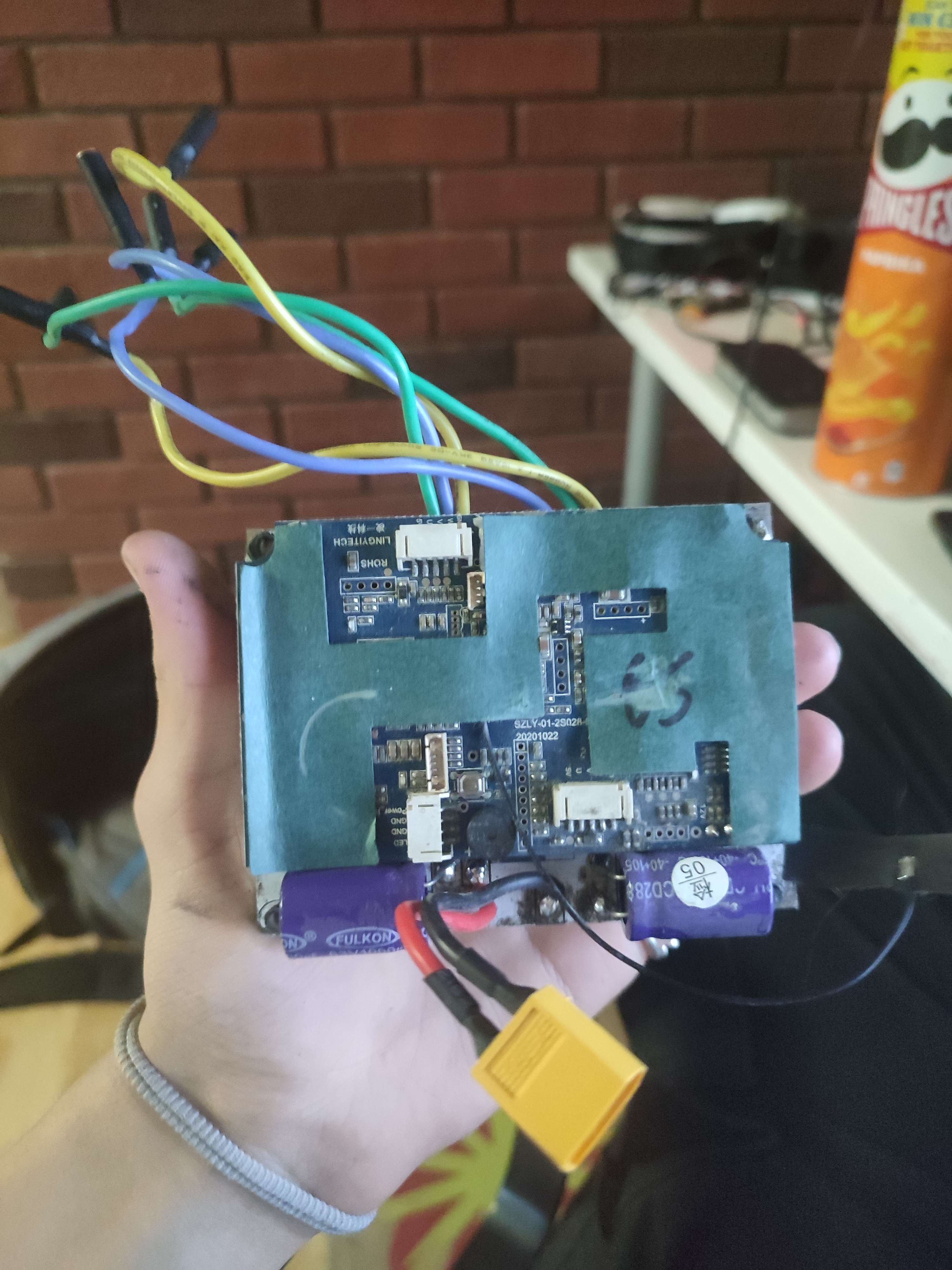

Hi, so I am building my first DIY board and I got an ESC and motors from my friend, but I need to find a battery for it.
My brother said this uses 22v batteries, but I’m hoping i can use one of my 36v E-scooter batteries
(sorry for the bad images, but If these images aren’t enough please just say)
There should be jumper pads you can bridge on the PCB. 3 different ones.
6s
7s
10s
You use 10s for a 36v (42v max charge) pack.
could you explain where I would find those? would I have to take of the green tape or?
Yeah it’s gonna be under the fishpaper
ahh okok.
Are those jumper pads here or would i find them on the PCB under this
because I have no idea how to deal with this white thing
Look where the phase leads are, there are 2 bridgeable solder pads labeled 6s and 7s, see on yours how the 6s is bridged? At the moment you have it in 6s mode so 25.2 max, if you desolder it then it will be 42v max
another noob question, what are phase leads, and where do you see the 6s and 7s? I’m blind as a bat with these things
wait i found them
