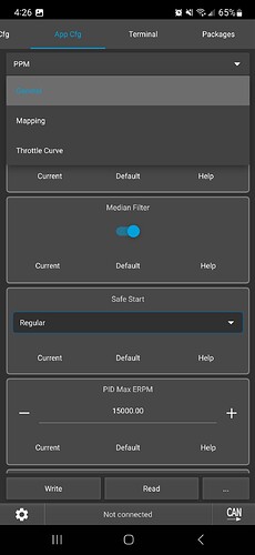

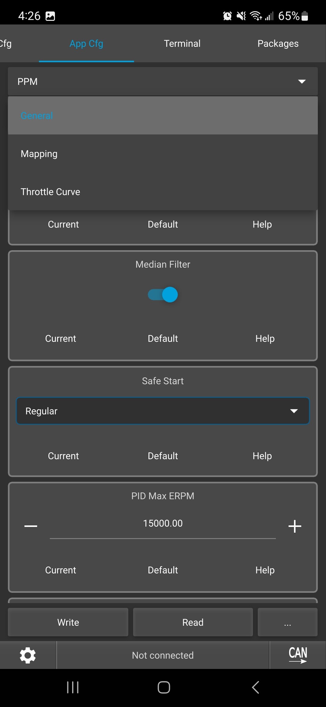

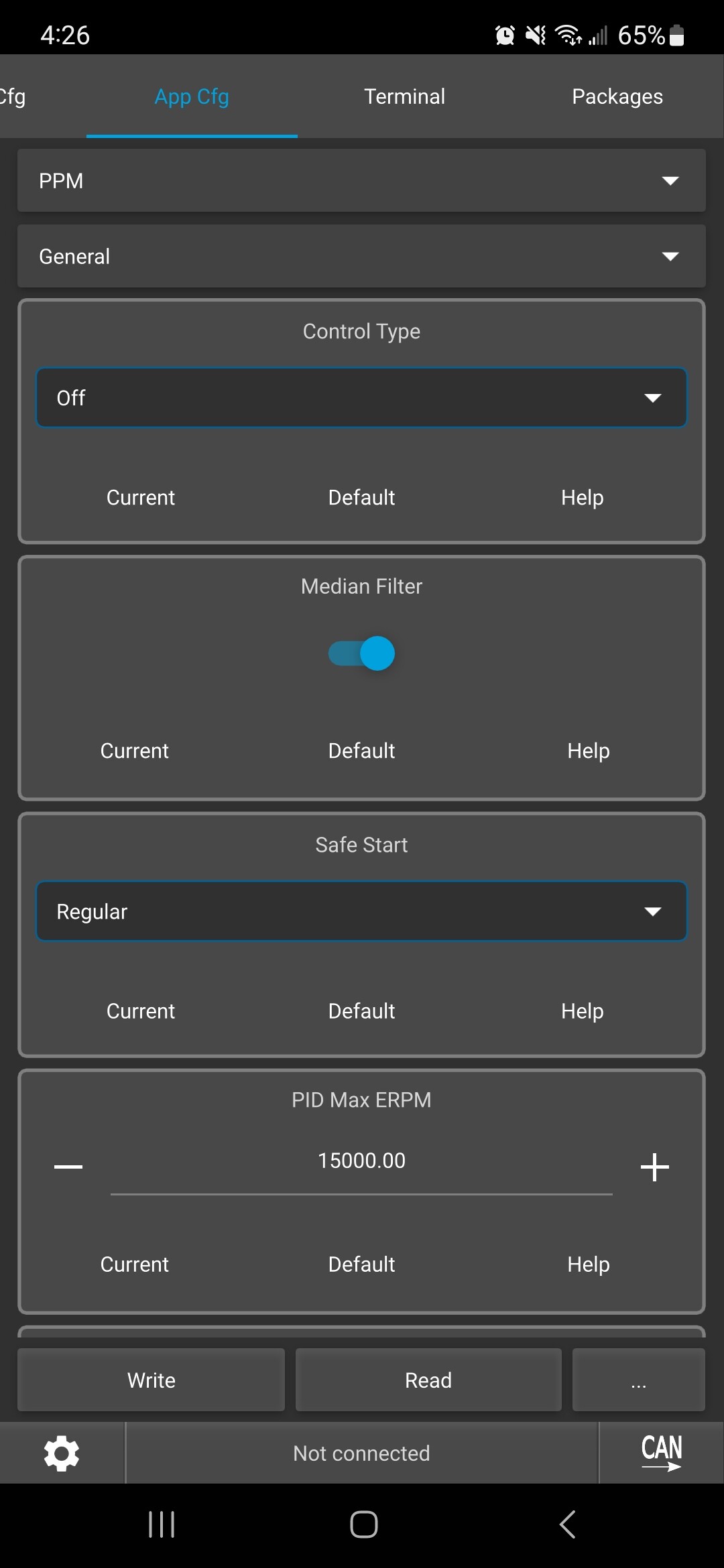

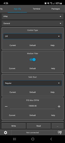

Look for the app cfg tab, you may have to swipe over as it’s to the right of the main menu screen.
Select the drop down that matches your remote input type (ppm is most common, some remotes use uart)
The drop down below that last drop down (hate how they do that) has options for general, mapping, and throttle curve.
General has the positive ramping time (time it takes from current remote signal to increased throttle position. Longer makes it smooth, shorter makes it punchy)

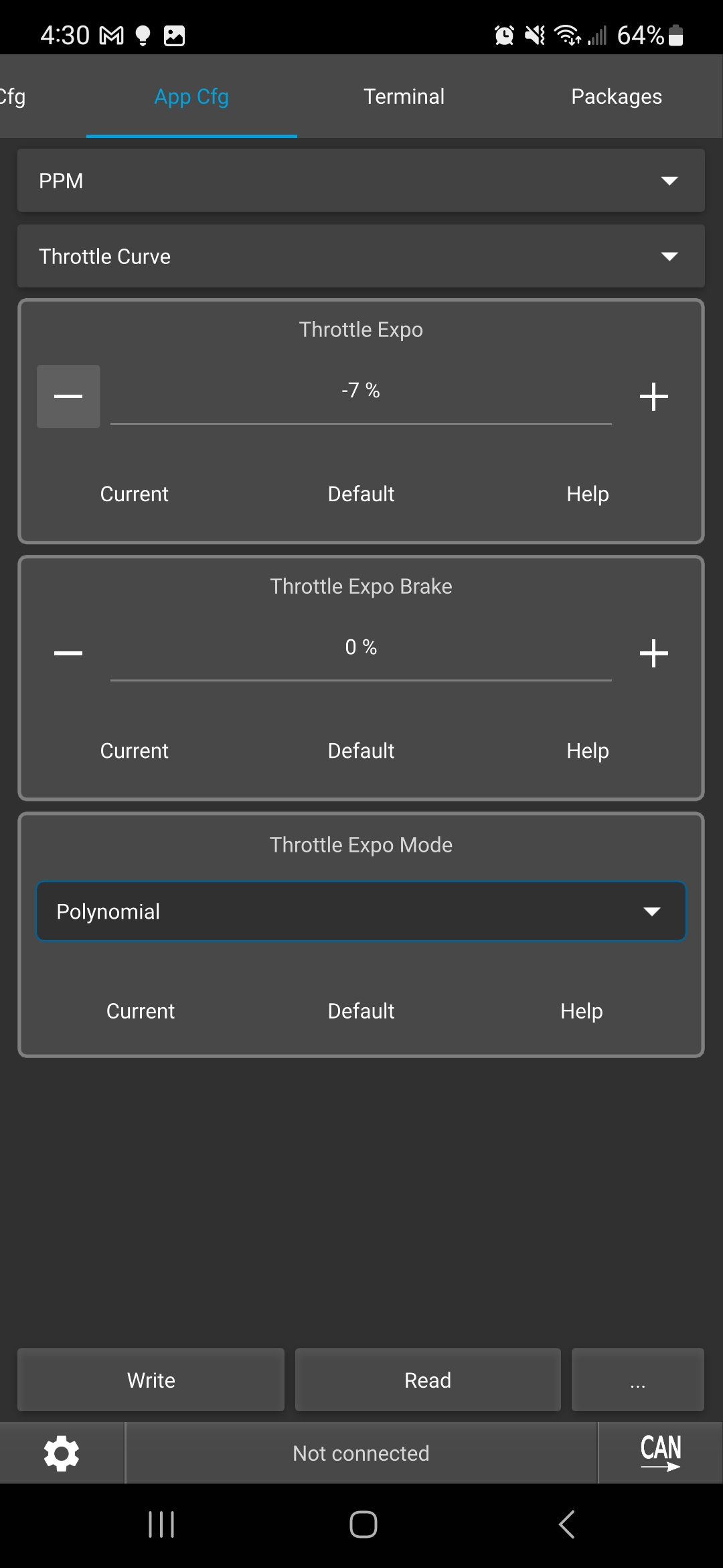

Throttle curve has the throttle curve adjustments. Negative throttle expo is what you’re after in that one.
You can do all this in the app now… I’m so behind lol

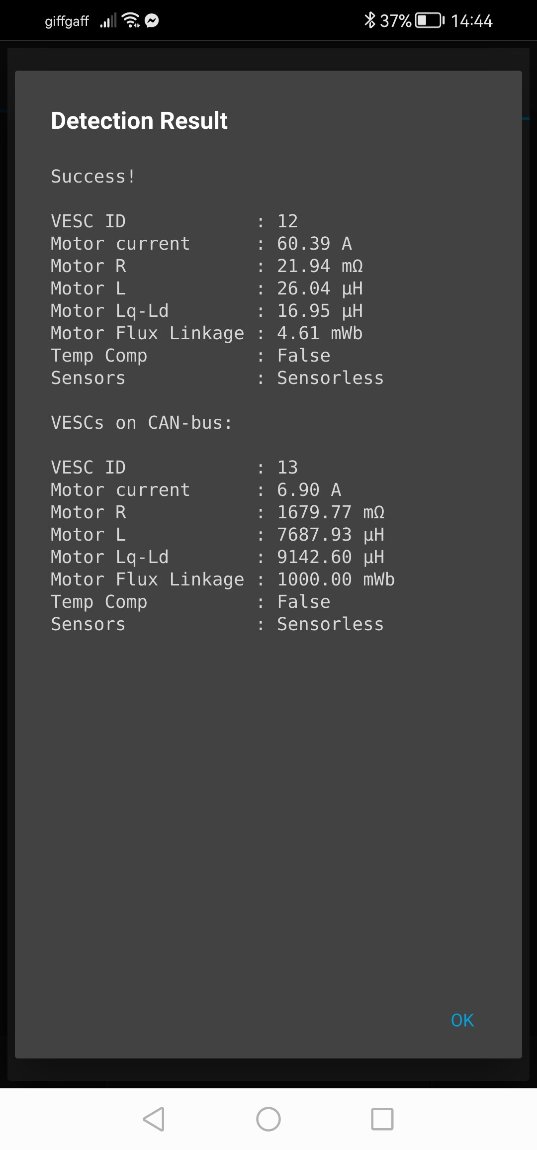

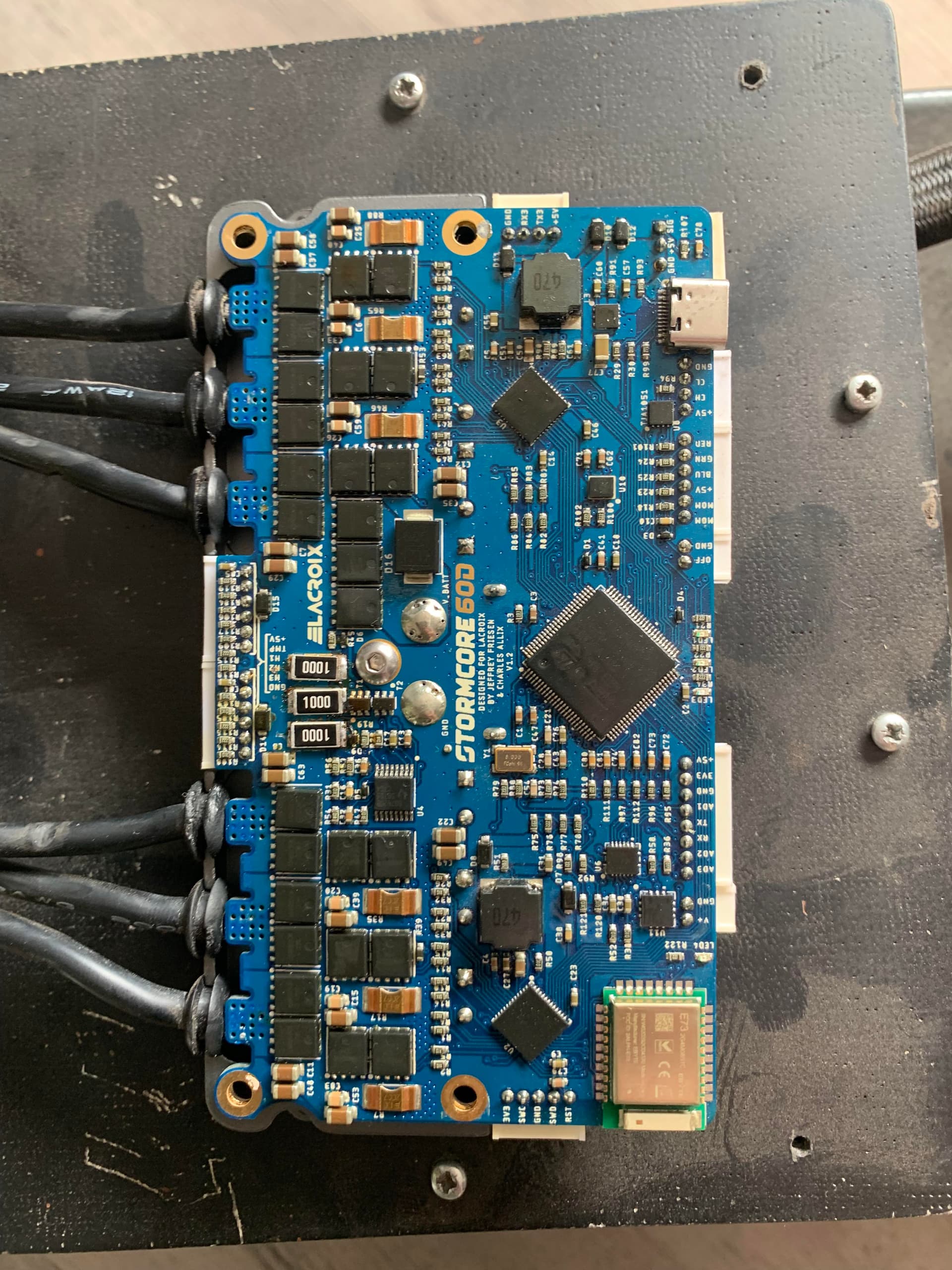

Hope this is the right place to ask. I have a stormcore 60d during a ride one of my motors stopped working. Since this happened I had thought it was the motor.

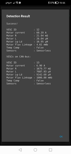

I have swapped the phase wires over ran detection and the motor spins fine it would seem the the stormcore is only running one the main side. Iv opened it up and can’t see anything wrong but here’s some pics hopefully one of u lovely lot can help. Or I’m throwing it in the canal.
Try manually copying the measurements from the good side to the bad side and see if it picks up for you. I had one esc that did the same thing; would fail detection but got it to work that way.

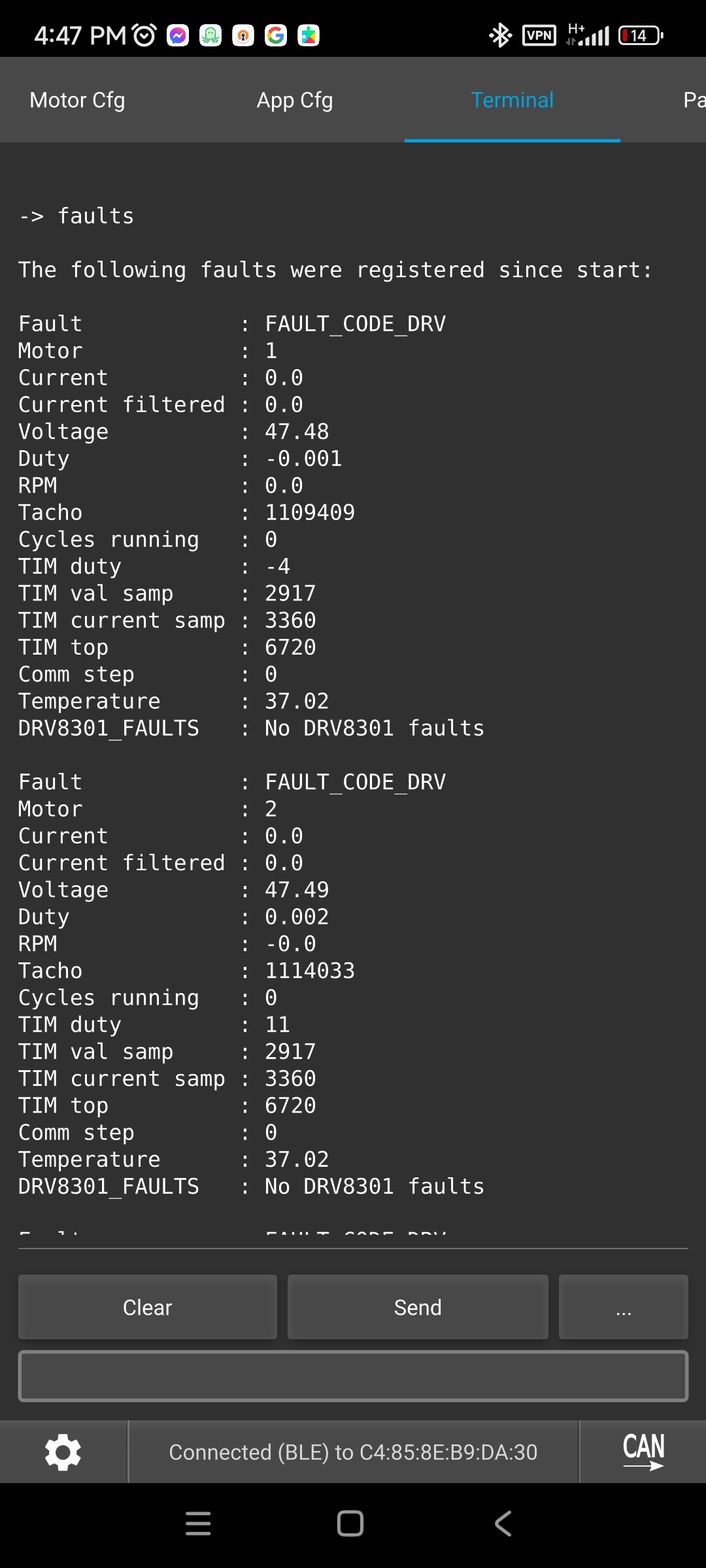

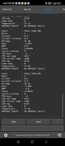

I have these errors while standing still.
Boards rides perfectly. Can’t feel a thing.
Any idea what’s the cause ?
It it when the board powers down?
