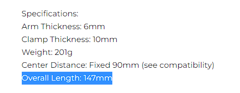

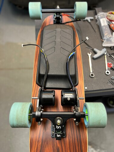

Does anyone know if the torque boards dual motor mount kit with 90mm / 83mm wheels (Dual Motor Mechanical Kit – DIY Electric Skateboard), fits on the loaded omakase deck?
They’d most likely have to be rear-mounted, but otherwise I don’t see why not.
But you have them mounted inwards on your omakase build.
and the boardnamics motor mounts that you are using are longer than the torque boards ones.
Boardnamics:
Torque Boards:
or is 133mm the length from the truck axle to the motor shaft?
I am confused and I don’t get why manufactures aren’t more specific with the product descriptions.
I did not use the longer Boardnamics mounts, I used the short mounts with a (IIRC) 55-65mm C2C distance.
Edit: The BN short mounts are 131mm long, so it looks like the TB ones aren’t a whole lot longer. I had to radius the corners of my mounts to allow for decent deck clearance, and I was running 20mm risers.

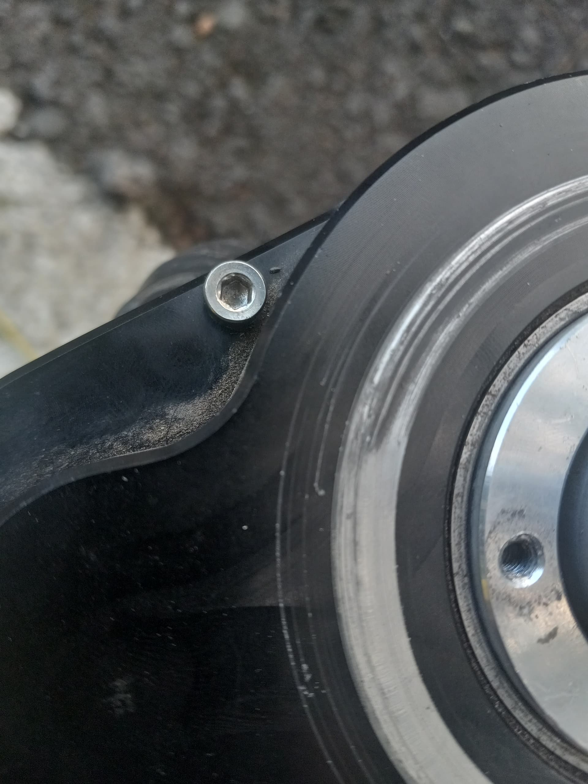

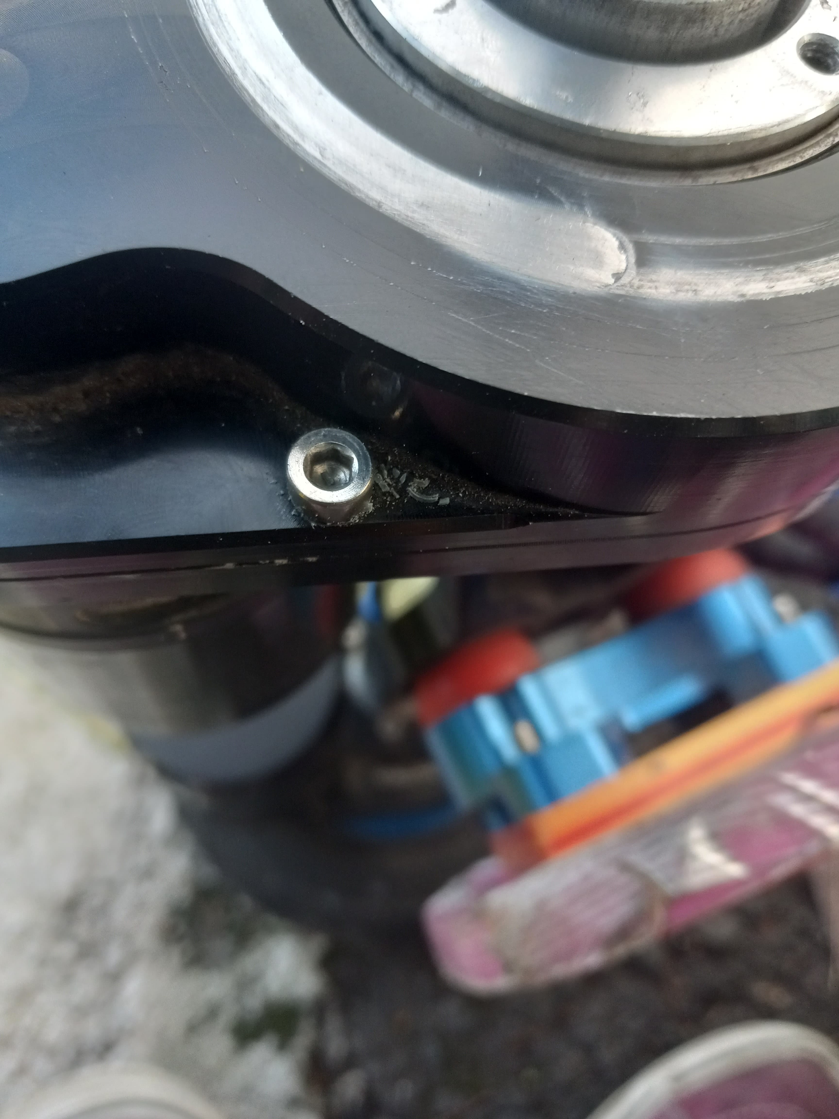

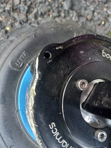

So ive somehow stripped two of the screw holes on one of my bn drives. I wasnt even using that much pressure, it stripped right as i was getting past hand tight. Pretty frustrsted but oh well. Anyone know if kevin sells just the outer shell by itself? Im also wondering what size the back screws are, as i was never sent any and running without them is causing problems.
For that particular one you might be able to just use a longer screw and let it thread into the other side’s casing a bit. Or use an even longer screw, drill it through and use a nut to hold it together :sweat_smile:
Surprised they stripped that easily… I use my electric screwdriver typically and haven’t stripped any yet, knock on wood
Yeah i think im gonna swing by home depot and grab a couple sizes to try
I think it’s an m4 bolt? Get an m5 drill and tap and just tap the threads to the next size up. Ez fix there is plenty of clearance for the bolt head and lots of meat on the bn drive cover.
Edit and with alu threads i use two fingers to tighten them to avoid this, still strip one once in a while but loctite (blue @b264 :rofl:) keeps these types of bolts just fine
