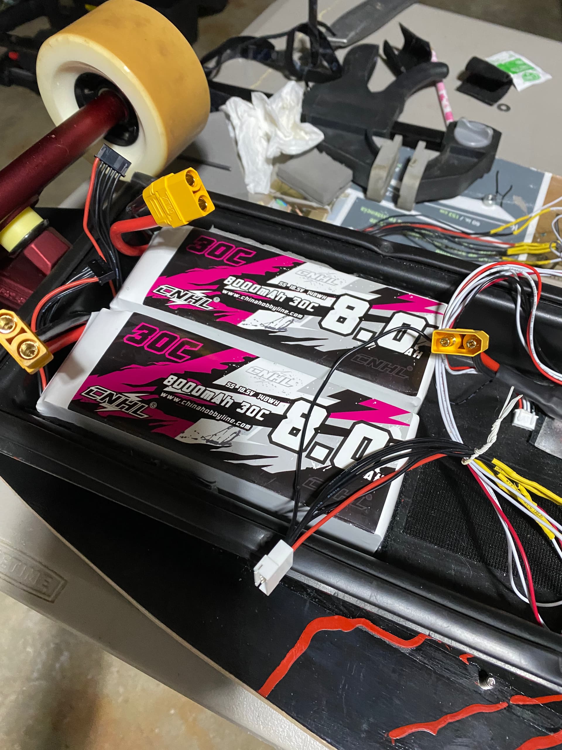

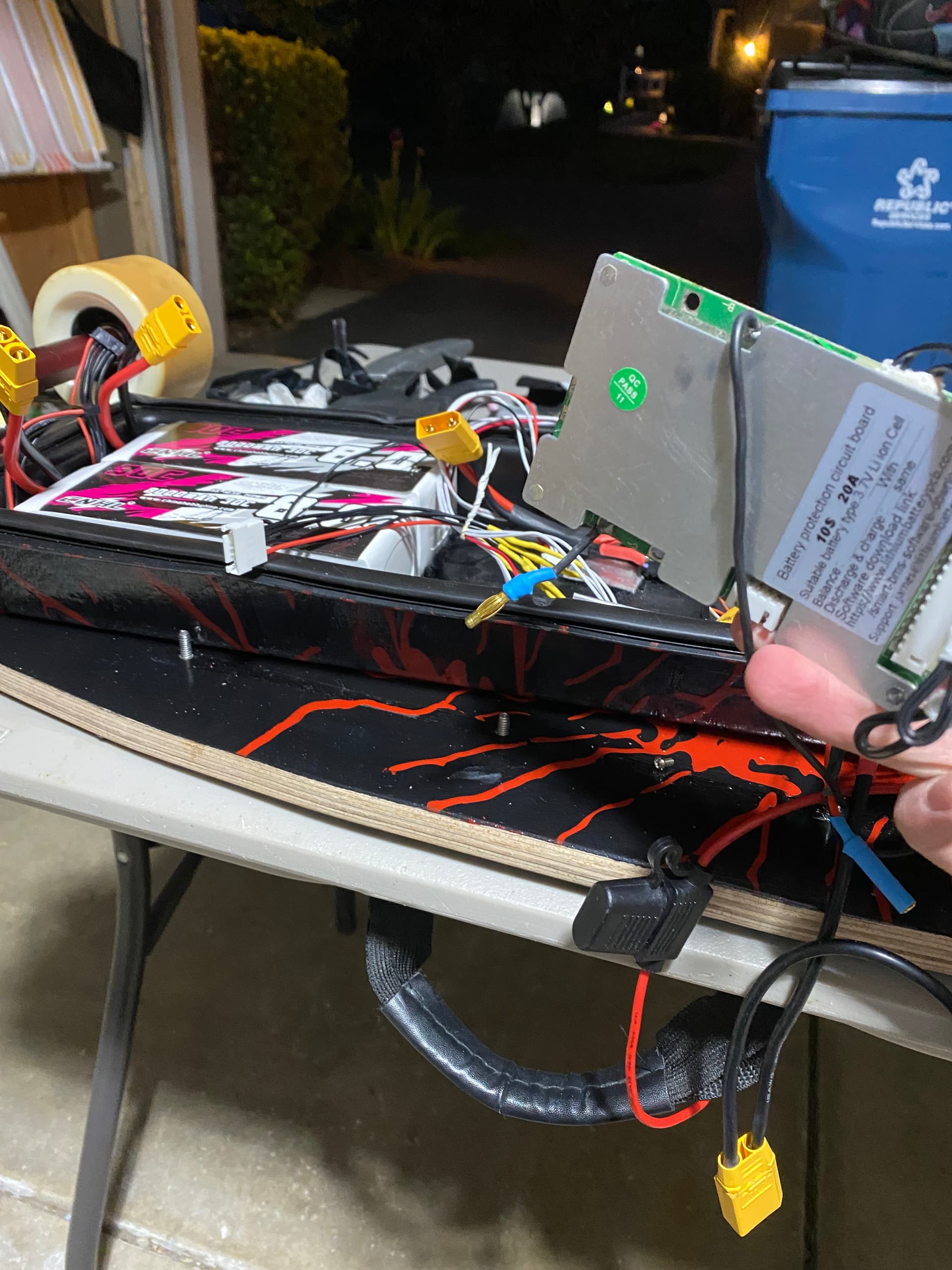

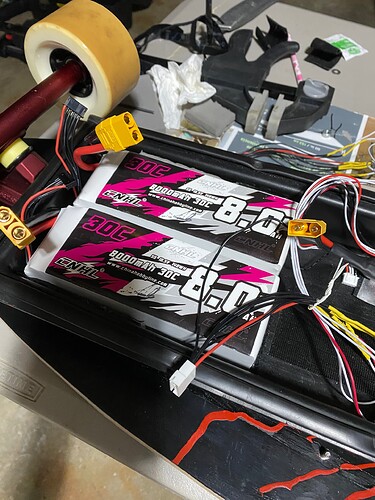

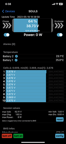

Hi there. Recently I’ve gotten a new battery setup for my build since my other batteries had an issue. This BMS runs a 10s setup and which these new batteries are still a 10s setup, I did turn the batteries around just to test if I can fit the enclosure better since the plugs were in the way, I plugged in the batteries and wires the way they should but the BMS started smoking, twice so I further analyzed the BMS and realized one of the terminals is fried, not sure if this LTT BMS was already on its last leg since it was fine before or doing a quick 360 of the batteries caused the issue, I’m questioning to get another LTT BMS or get a better quality one
LLT makes good quality BMSs. I hate to say it but my suspicion from what you’ve said and those pictures is that your batteries and balance leads were, in fact, not connected correctly and that is what fried your BMS.
Yea they weren’t, I reviewed some old footage of when I connected everything correctly and it the balance wires itself was crossed but today I corrected it the right way and the BMS seems to be working just fine, I might’ve dodged a bullet with this one but I’m gonna make sure there’s no issues before I close it up
