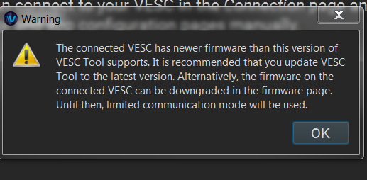

Any idea how/ why this error pops up on vesc tool?
I just downloaded the newest version of VESC tool so I don’t get how this is possible. Also even with the 6.00 version it shouldn’t have been possible since I bought it off someone in decemeber and I’m pretty sure he wouldn’t have access to unreleased firmware.

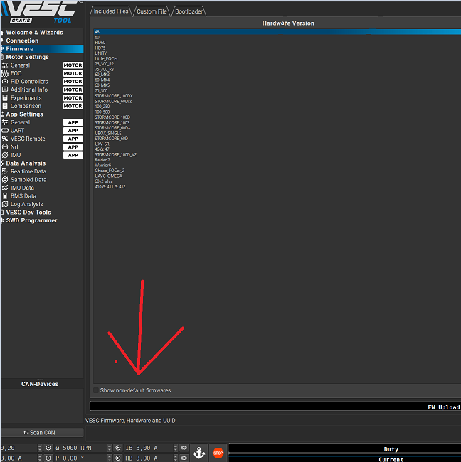

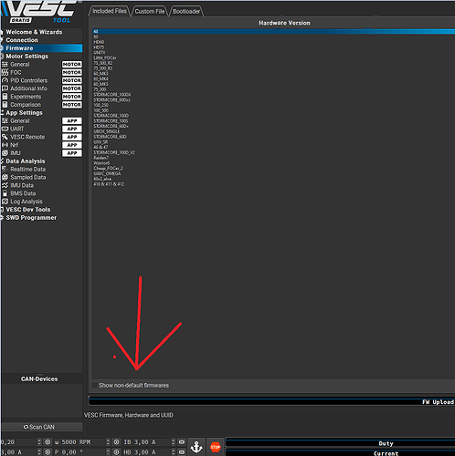

Go into the “firmware” tab. Look in the bottom left, there it should show you the firmware that is installed.
Edit: you found it
That is the Original firmware used on the unity (before it got merged into the official vesc tool)
And since 23 is higher than 6, vesc tool says it’s not supported.
You need to flash the current vesc tool firmware on the unity

It claims that 6.02 firmware is supported and loaded, should I flash that to it? Just don’t want to brick it by putting the wrong thing on it
whatever the latest vesc tool offers in terms of firmware is what’s supported yes.
I personally still use 5.2 with my unity. I won’t update for a while.
6.02 is the brand new firmware release from the last few days i believe.
You should also be able to use the archive and flash older firmware if you want.
If you run the newest version, you are a beta tester, so it’s up to you to decide whether you want to use mostly untested firmware or not.

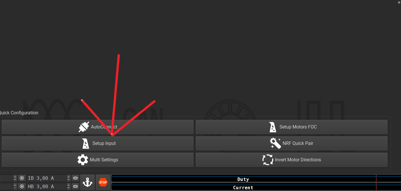

you need to do the remote wizard.
That isn’t a thing on my VESC tool. There is a nrf quick pair wizard but it doesn’t even work. unless it is the setup input option which has the dumbest symbol next to it

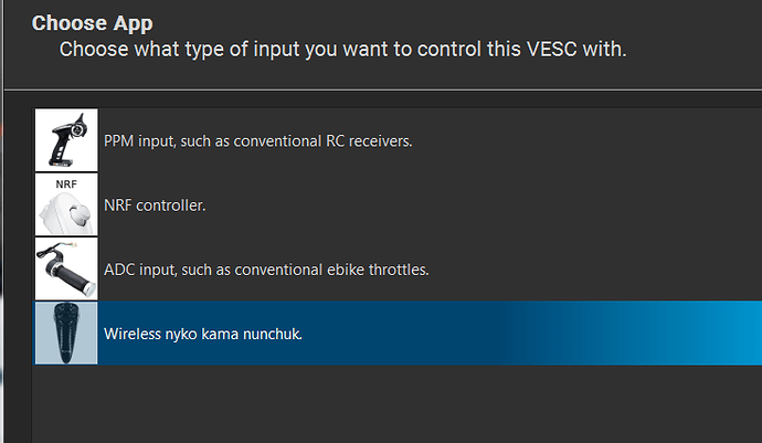

My remote type isn’t there though. that is the problem. It is not a nunchunk, nor an ADC controller.
