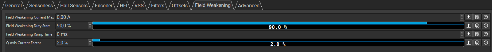

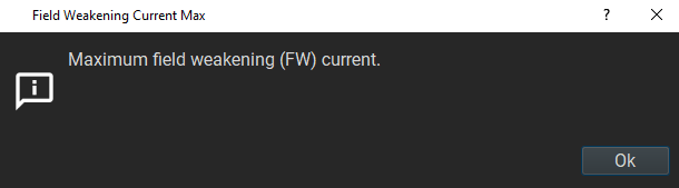

I’ve been interested in trying the field weakening with VESC, but I can’t find any good information about what the maximum field weakening current actually means and how does it behave in action?
How do all these values (apart from the ramp time, as that it quite self explanatory) work together?

All you have to do is set the “Field Weakening Current Max” to something like 10-50A and it will start adding additional current around 90% duty cycle to overcome the normal RPM limits.
The drawback is that it’s a fixed current. So with a 50A setting, 100% throttle above 90% duty will be 50A + whatever is needed for the actual load. There is also a concern that if the VESC faults while driving field weakening and that current stops, then the bemf voltage would be much higher and if that’s above the mosfets vds could short them and lock it up briefly… or something like that. I’ve never experienced it but it’s been discussed.

I am familiar with the operating theory and possible failure mode behavior. I am just really confused about how the FW current works exactly.
So that is the actual D axis current used to weaken the field? So if my motor amps max is 50A and my FW current is 10A, then the maximum possible current it will push to the motor would be 10A+50A?? Do you know how the Q axis current ratio factors into this? I’d imagine that it sets the maximum allowed FW current based on the motor amps, so if you’re pushing 50A motor amps with 10% Q axis current factor, then it would push max 5A of FW current?
Yeah, the VESC firmware adds d axis current for field weakening.
In my testing it respects the motor current max. So if your motor max is 50A, and FW max is 10A, then you can still only do 50A. If the regular load needed is 50A, then no field weakening current will be applied. If the load is only 20A, then it will add 10A of FW above 90% duty when the throttle is full. Half throttle will add 5A of FW.
An easy example was the hill climb test. Same top speed with 0A and 50A field weakening… because I needed all the normal motor current to climb it at that speed.

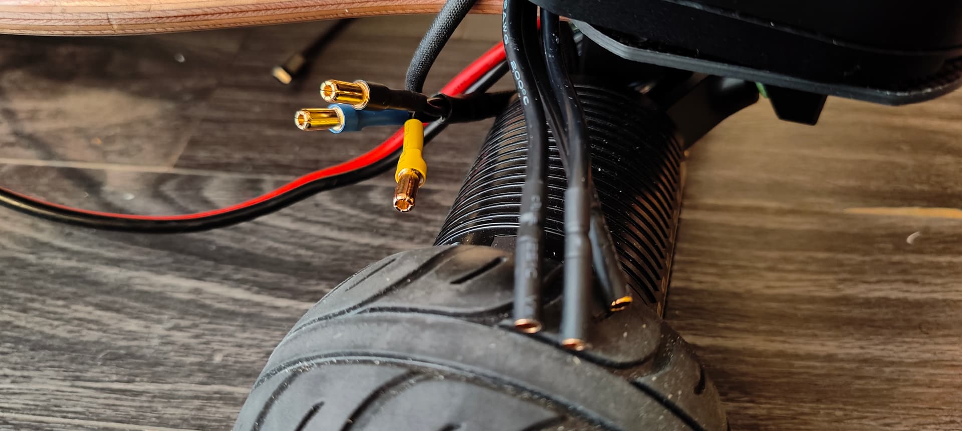

I am looking for the correct kind of connector to solder on my Stormcore 100Dx 3 phase motor connectors to the TorqueBoards direct drive connectors?
https://lacroixboards.com/products/stormc

IIRC those connectors are 5.5mm bullets on 16awg phase wires :sweat_smile:
