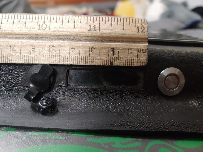

The 2 pin JST port just goes to a voltage display / voltage led bar to monitor the battery charge level. It outputs battery voltage and only turns on when the Unity is powered on.

Would that display happen to be roughly this size?
I thought it might have been a window for a display of some sort but I had no idea what the display was for since I didn’t buy it with one. The remote I bought for it has battery monitoring though so I don’t really need it anyway. remote and receiver it came with cannot monitor the battery
I didn’t remove it and fill it in with epoxy because it was already well sealed within the enclosure so it wouldn’t be a place for water to leak in. :person_shrugging:
I thought it was as bit odd if it did have a BMS built in but the language on the features was very vague and that port did remind me of what charging ports use. It being for a display makes so much more sense though
It is nice to have further confirmation that it does, in fact, have its own anti-spark and that the sites selling it weren’t making that bit up.
Yes, they are frequently found in that size. That’s probably one right there. That might plug right into that JST 2 pin connector.
That is just a piece of acrylic and a frame where you’d slot in the display. I don’t have the actual LCD for it. It was either lost by who I bought the VESC from, or they were sold it without the display. pretty sure it just got lost though since he had to search for the BT module. IDC if I don’t have it though
