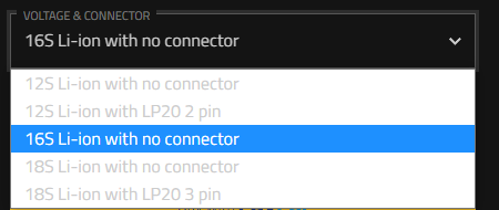

The radium chargers are my favourite. Pretty sure there is an option for LP16 or LP20 (same as lacroix)
Screenshot 2023-01-07 144128
Only problem is the only 16s option has no connector included. I’m sure I could solder it, but I would definitely need to practice first. But yeah I agree all the radium stuff looks super high quality.
I’m sure @Tony_Stark would be able to put a connector on it for you if he has loose connectors in stock
