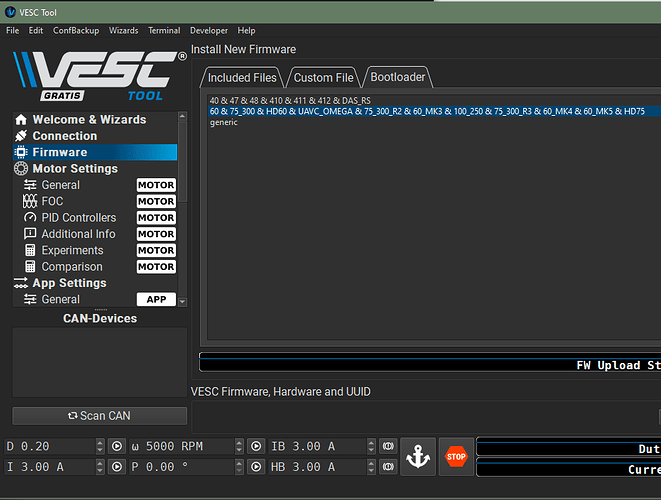

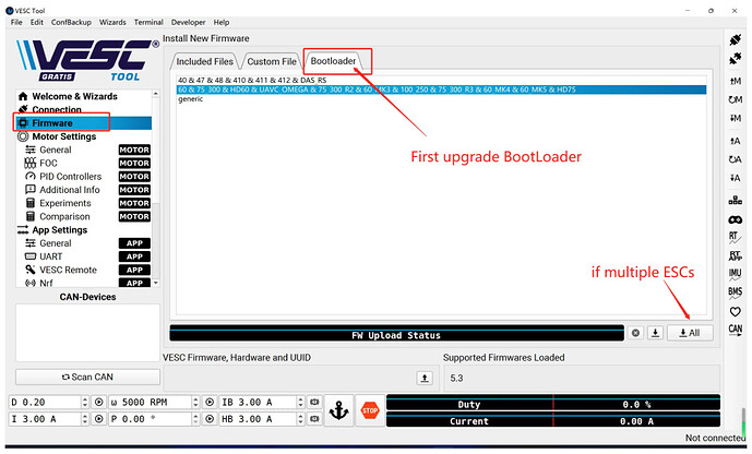

So, according to MakerX I need to upload this bootloader:
But I don’t have this option, just generic. How do I get the other ones?
Tagging @Evwan in case you happen to know
Looks like all these settings/options are available when I boot the app, but go away as soon as I connect:
Generic should work. Bootloader is responsible for loading the firmware after its been sent to the esc. If it’s missing then the firmware won’t “stick”.
Thanks I uploaded the one they have on their site, but didn’t change anything brakes are still weak.
