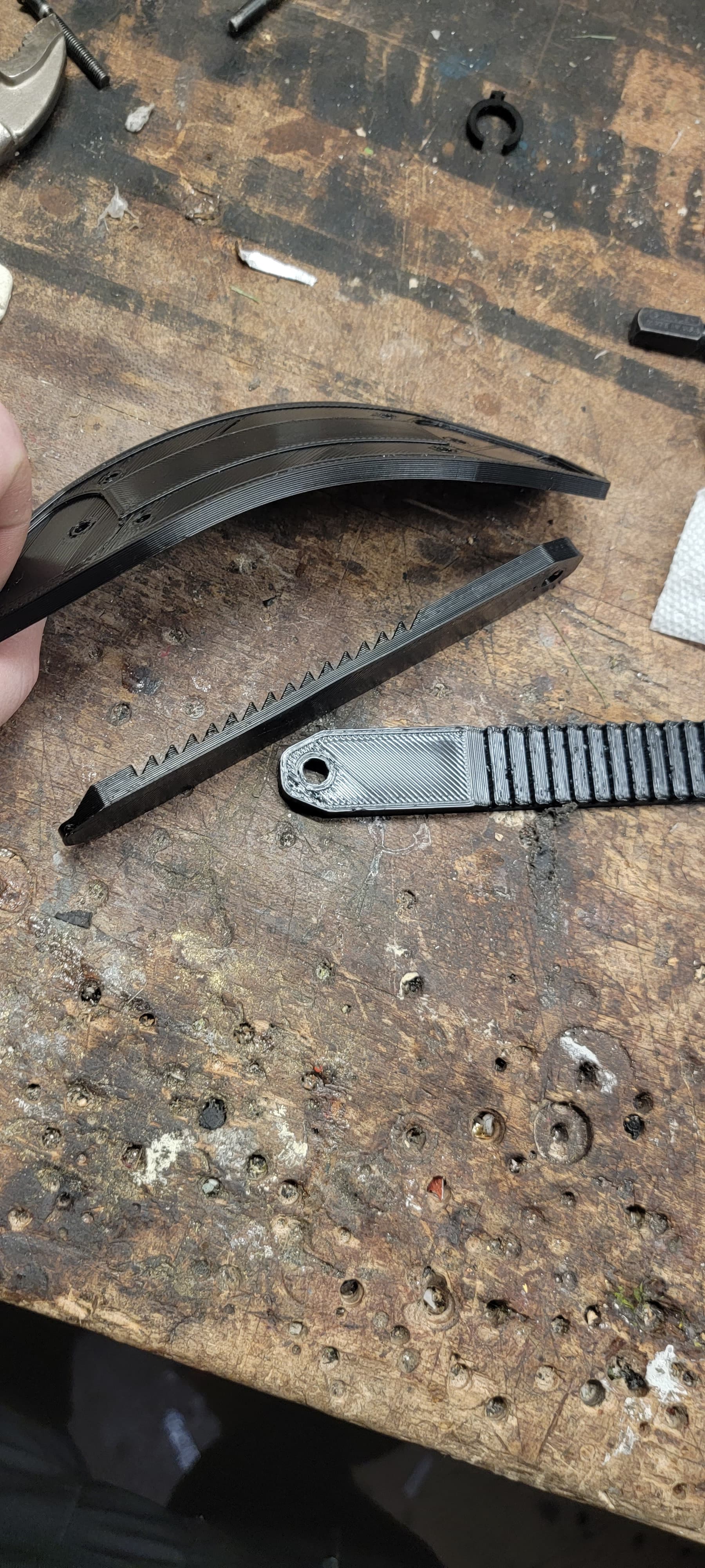

About 1/4 cost
Lot of faith in that layer adhesion
:crossed_fingers::crossed_fingers:
About 1/4 the comfort
Im not saying you dont get what you pay for, if i had the beans i would get the heel straps from mbs but i have tons of 3d printer filament and can at least see if i want them. It suits my shoe choice as well.

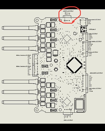

Anyone know if you’re able to connect a remote receiver to the 4-pin UART on the side of a Stormcore 60D? I have a Davega using the 8-pin UART on the front and wanted to try connecting a VX4 via UART. I have a puck connected through PPM which is fine and I know I can do that with the VX4, but I’d like to use the screen readout on the VX4 as well.
Assuming the vx4 isn’t weirdly proprietary… You can run your remote with ppm and still get the screen data by tieing in just the rx and tx pins to your remote receiver. The maytech split trigger receiver does this and I would expect you can do the same on your remote.
Maytech-MTSKR1905WF-Manual-V2-0.pdf (2.5 MB)
One thing to note is that the original stormcore 60d (not the plus version) accidentally messed up the wiring to that extra uart port, rendering is useless. If you have a plus version, that uart port will work fine as long as you’re on 5.3fw or above.
It’s PWM. It’s typo’d in VESC software as ā€œPPMā€
And on lots of escs too
and in your post LOL
Mine is regular 60D (not +) so sounds like I got a dead side UART port. My Davega is already using the RX and TX from the front UART- would I tie into those or could I use the RX3/TX3 on the side port? (If they are wired properly?)
