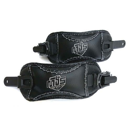

Anyone 3d print heel straps?
No.
Off to the lab then.
Great lab:
