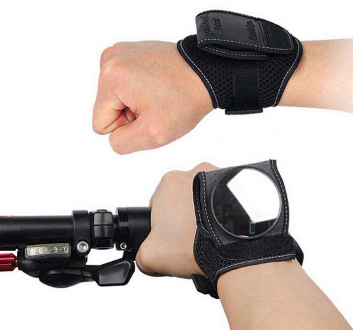

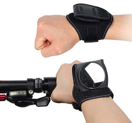

Some use this
Works surprisingly well, but it’s kinda hard to get used to at first. Also it’s a pain to readjust and is impossible not to knock around
I put a small one on my remote and it works well enough but the one linked above is slim enough that I’m tempted to try it
