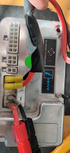

Anyone know anything about this ESC? Seems to be on a DC brushed motor. I need to reconnect the wired remote.

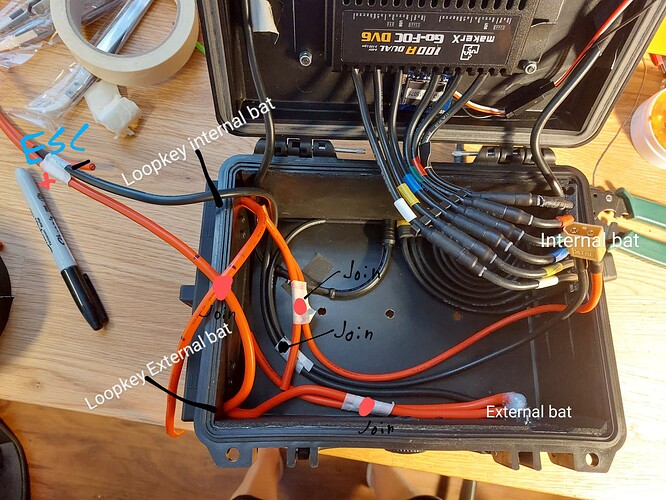

Doing a sanity check here, does this wiring look like it’s solid?
Should be following this wiring diagram:
Put shrinkwrap over the bullet connectors so they can’t vibrate apart
Same with servo/PWM connector
And cable tie (or tie with string) the XT60 together
Oh absolutely, wiring isn’t done as you can see at the moment. Was waiting till the end to button everything up.
You don’t want to connect an external battery directly to your internal battery like that, it is a major fire hazard if both loopkeys were to be plugged in. Why not have a single wire that you move?
Have the ESC connected to a male XT90 and plug it into one of two female XT90S, one for each battery.
No “key” at all.
They physically can’t be connected at the same time
see: Captured Loop Key - Design, Development, and Documentation - #17 by DeadLightning
