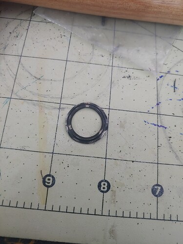

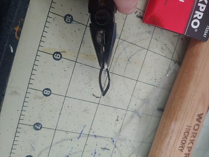

Anyone know what these wobbly washers are called?
One of mine kind of destroyed itself and I need a replacement but don’t know where to get them or what they’re called. The other hub motors I have might have one I can steal from it but if not I need to buy new ones
I believe those are called wave spring washers.

Looks to be the same thing, thanks. The name is pretty descriptive of what they look like but with better words than “wobbly” washer :rofl: The other hub motors don’t use them at all so looks like it is time to try and find the same dimensions online or just try stacking normal washers to take up the same amount of space inside.
It sits between the strator shaft and the bottom bearing which is pressed into the rotor, so I’m not sure how it managed to come loose. It sits on the non moving shaft so it might be a good idea to try putting some locktite on the new one to see if that will stop it from coming off again :thinking: if anyone thinks that is a bad idea please tell me though
