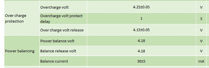

My 12s battery has a 48v bms. I have a 50.4v charger. Will this be an issue? My battery seemingly stops charging at ~47.9v according to my voltmeter but the light on the charger stays red. Will it ever hit 50.4? Am I losing out on range by not getting to 50.4v? I see the discharge graph is steep from 4.2v to 4.0v which makes me think at least 90% of the charge is from 4.0-3.0v. I guess not charging to 50.4v will extend the battery life?
What model BMS is it? Most can have their settings adjusted.
Better to measure current into the battery to see what’s happening around 48v. You can 3d print a case for one of those DC display meters and put it in line with the charger. Really helpful to see what’s going on. There is a whole thread on it:
I used to charge to about 4v per cell just to give the battery some more cycle life, and range was still really good. Probably 80% if I had to guess.
Deligreencs? Its a 12s 48v bms. I never noticed that some bms go to 50.4v and others don’t… Those dc displays look like a move.
because of your 48v bms
not with your current BMS.
Simply said, yes. How much? Depends on how you ride.
yes
Based on the spec sheet I think it will fully charge to 50.4. If it’s not getting there then it might be detecting a poorly balanced p group. Have you left the charger on the battery pack for a few hours? The charger will stay in constant current mode where the voltage will be below 50.4 for most of the charge, and only enter constant voltage mode at the very end.

Try checking voltages on all the p groups through your balance lead.
