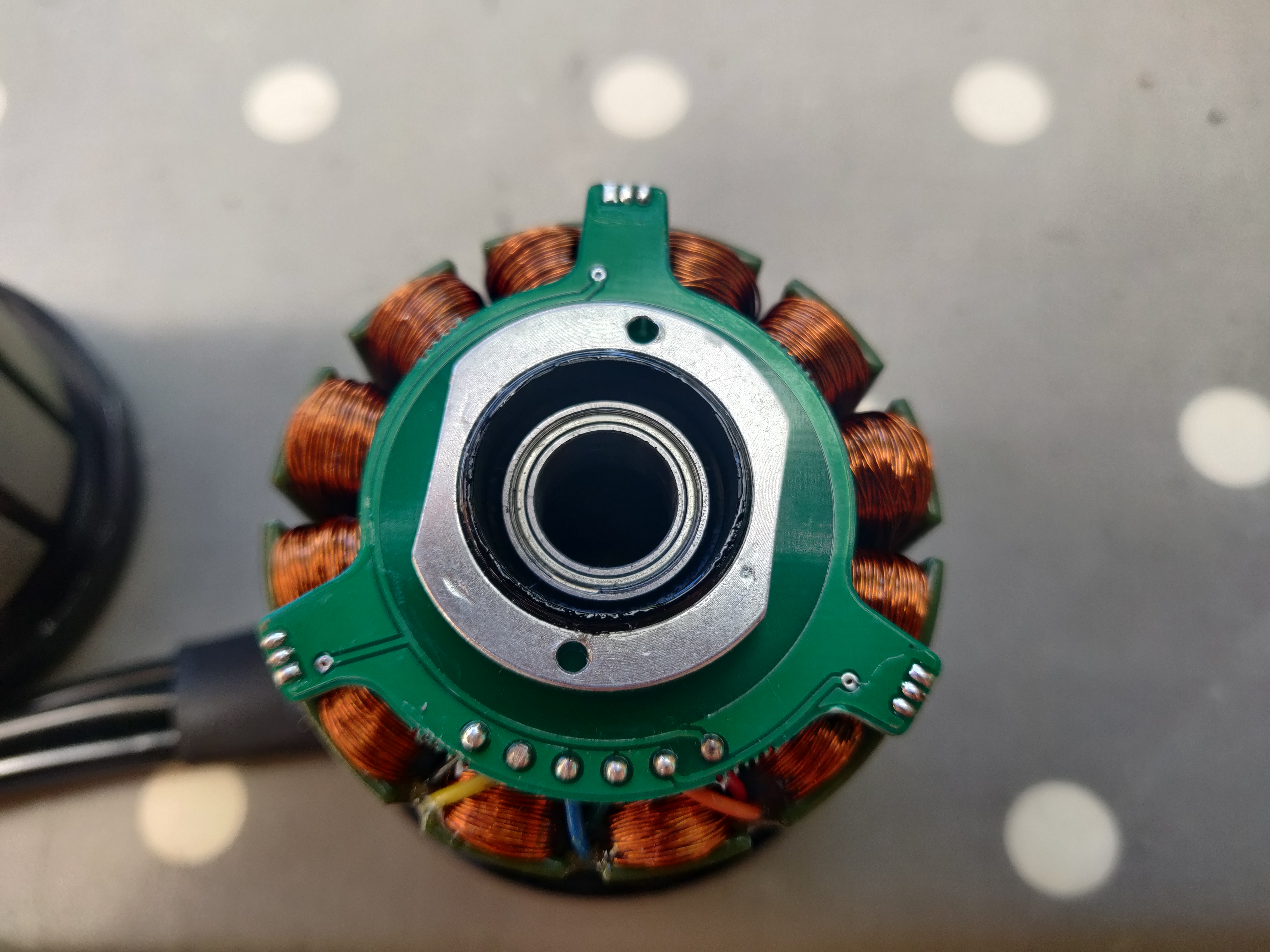

After reading through this, and comments from @rich and @Anubis, I’ve just gone and re-inspected my brand new (freshly built 2 weeks ago) Maytech 6374 C2 170kv motors.
Couple of questions (see photos below):
With the epoxy between the can magnets, do I even need to bother with more? (I will test run them for a week or two before doing it, as per your advice Rich)
And the blue stuff. Is that magnet epoxy or is that there for balancing?
In my novice opinion, aside from inconsistent thickness of battle hardening epoxy and 1 small solder ball which I will remove, they look pretty well made to me. Windings all seem secure, sensor wires are all glued to the windings to prevent shifting.
@rich do these look exactly the same as you older sealed motors, or does it look like they’ve tried to make improvements?
I can certainly see that the phase and sensor cables need reinforcement where they exit the can, even if they do feel pretty solid right now. Hard to move or flex them.
And a video of the inside of one of the cans. Slight unevenness of the epoxy between magnets, but otherwise looks good to my untrained eye. Just curious about the blue stuff.
The blue stuff is for balancing. Also it’s added after the light battle hardening so everything good.
